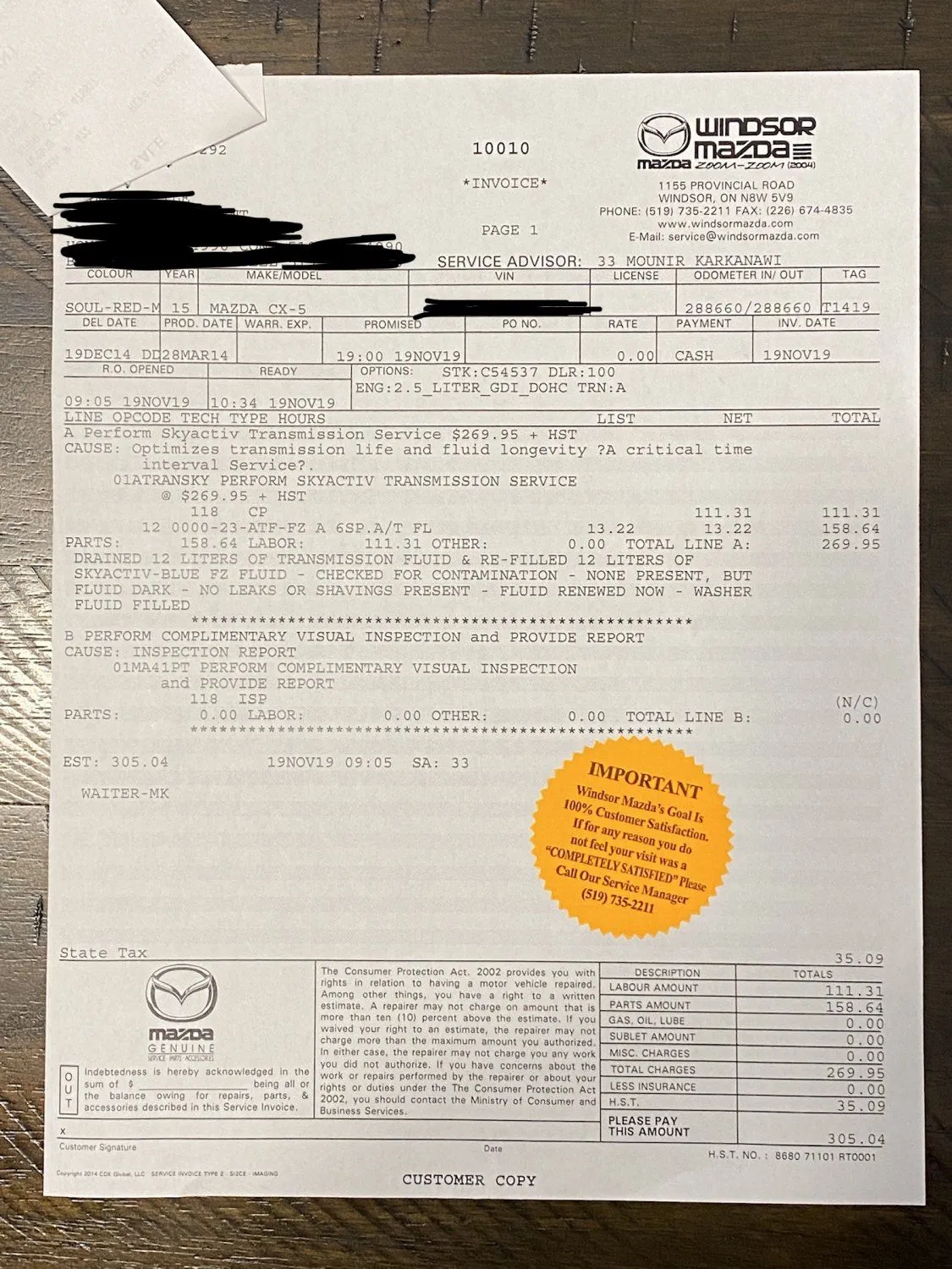

I’ve posted in this thread, though much earlier on. I believe my invoice said 12 quarts.
I have no reason to believe a good friend would mislead me, certainly not over a couple hundred dollars. Drain and fills aren’t much cheaper.

With 12 quarts used, you should get a good 90%+ old ATF replaced with proper method. But if the method is to use “adapters“ to complete the flushes through the dipstick and a pressure port, I do have some doubt how effective the ATF exchange truly is. Firstly, I don’t really know there’s a “pressure port” available on SkyActiv-Drive transmission the ATF exchanger can hook up; secondly, any ATF exchange machine when using the dipstick hole would be less effective as the fresh fluid would mix with old fluid once you feed the fresh ATF into the dipstick hole. I’d use 12 quarts of ATF and do drain-and-fill 4 times which should be similar to 92% replacement ratio, and have more chance to get rid of old fluid staying inside of torque converter and valve body.
BTW, $259.99 CAD / $196.86 USD for 12 quarts of Mazda ATF FZ and labor is an unbelievable price as 12 quarts ATF FZ alone would cost you $15.33 MSRP (some dealers charge $18+ per quart) per quart X 12 = $183.96 USD before sales tax!
$259.99CAD. It may not be a flush in the traditional sense, but it is a full fluid exchange using a machine.
A good friend of mine is a mechanic at the dealership in question. I am 100% certain they perform a full exchange of the fluid....12 quarts.
Im good buddies with one of the mechanics there. They have adapters to complete the flushes through the dip stick and a pressure port. The last time I had it done he exchanged 12 quarts. I looked at my invoice again. It says Performed complete drain, flush-cycle and fill.
The invoice speaks for itself. I will gladly have the service performed by a friend at a dealer any day of the week over 4 drain and fill cycles. I was wrong in that the price was $10 more and it was 12L exchanged not 12 quarts (946mL in 1 quart).
My advice to anyone would be to have a fluid exchange completed by a competent dealer with the right equipment and make sure you’re getting a full fluid exchange. All of the Sky vehicles I’ve owned have been treated this way for an estimated 700,000+ kilometres. If the job is done properly, it’s safe and effective.

Going with a recommendation from a trusted friend who works as a mechanic would be good enough for me - but when you include the fact that your friend is a master tech at a Mazda dealership, I'd be much, much more inclined to trust him/her over a DIYer.
It sounds like he found a dealership that uses the proper adapter. That is not par for the course.
I’ve observed the full spectrum from those approaching dealerships for this service: its sealed and we won’t touch that, we swap all the fluid (turns out to be a single drain and fill), to what sounds to be a legit full swap per Joe. I’ll continue to DIY because I have no idea what my service center will do, it saves me $100 in labor, it’s not difficult.
Joes service simply isn’t available everywhere, so that’s why folks will need to drain and fill. It’s not that people don’t want this service or think it’s magic, we simply don’t have buddies who are Mazda mechanics with the proper equipment to do what is promised. YMMV

The bottom line is, very few Mazda dealers can do (almost) entire ATF change with proper adapters like JOE MAMA’s did. And with 12 quarts of ATF we can do drain-and-fill 4 times which achieves similar 92% ratio of fresh fluid. So for DIYers, doing drain-and-fill multiple times is the best way for such service although I may only consider to do it once at 50K miles.
I still would like to know where is the pressure port which can be hooked up by one of the connectors from the ATF exchanger used by JOE MAMA’s Mazda dealer. ;)

And yet, here we have an example of a Mazda master tech doing the service, with a printed invoice identifying the dealership and SA. If using such an adapter was frowned upon by Mazda, I don't think the dealership would allow it.
Yes, the rarity of this situation has been established. It's interesting that you think performing a drain and fill 4 times is "the best way" when Joe's single service achieves a similar ratio of fresh fluid. DIYers like you (and possibly myself in the distant future) may save money by doing the drain and fill 4 times, but not everyone is willing to be under the car that often. In that sense, "the best way" depends on what the owner prioritizes (saving money or saving time/effort).
I suppose you could give them a call or email them if you wanted to.
