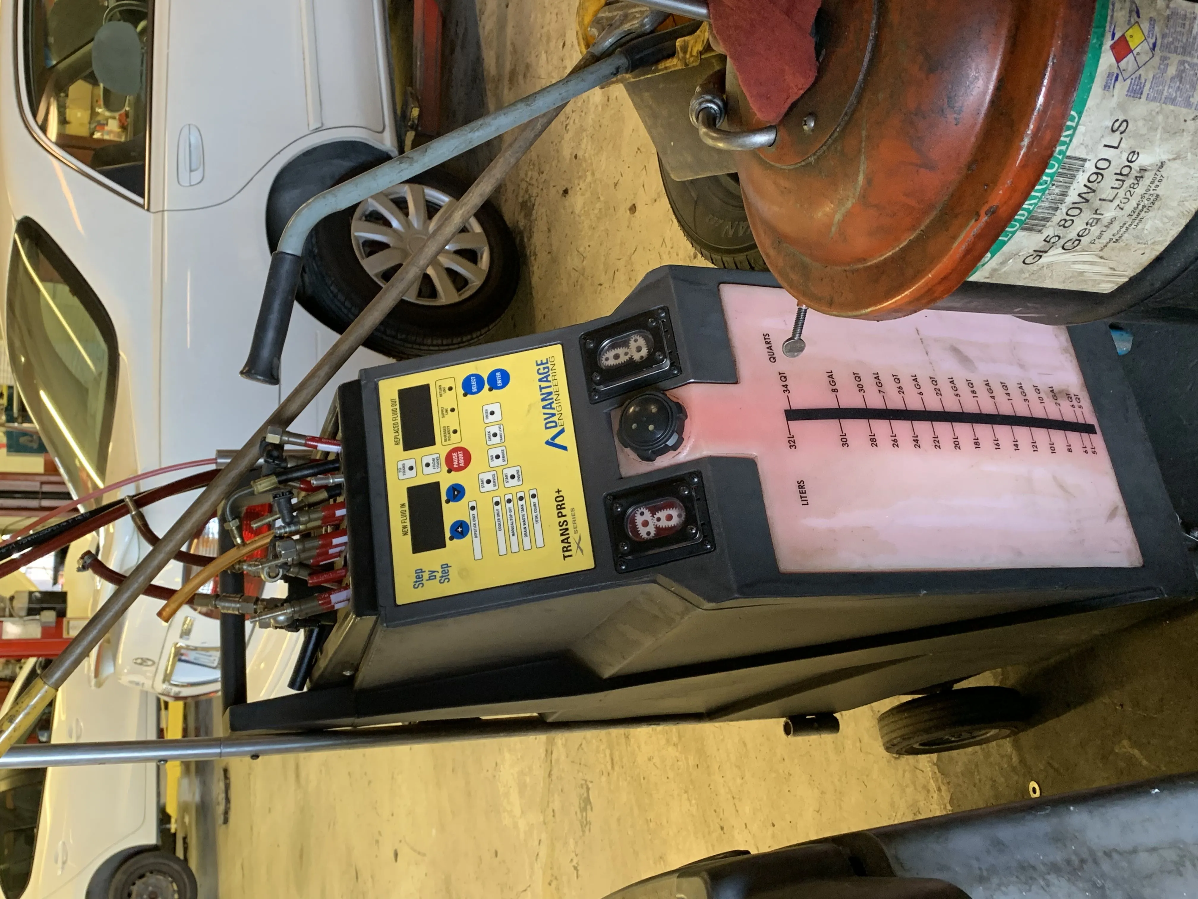

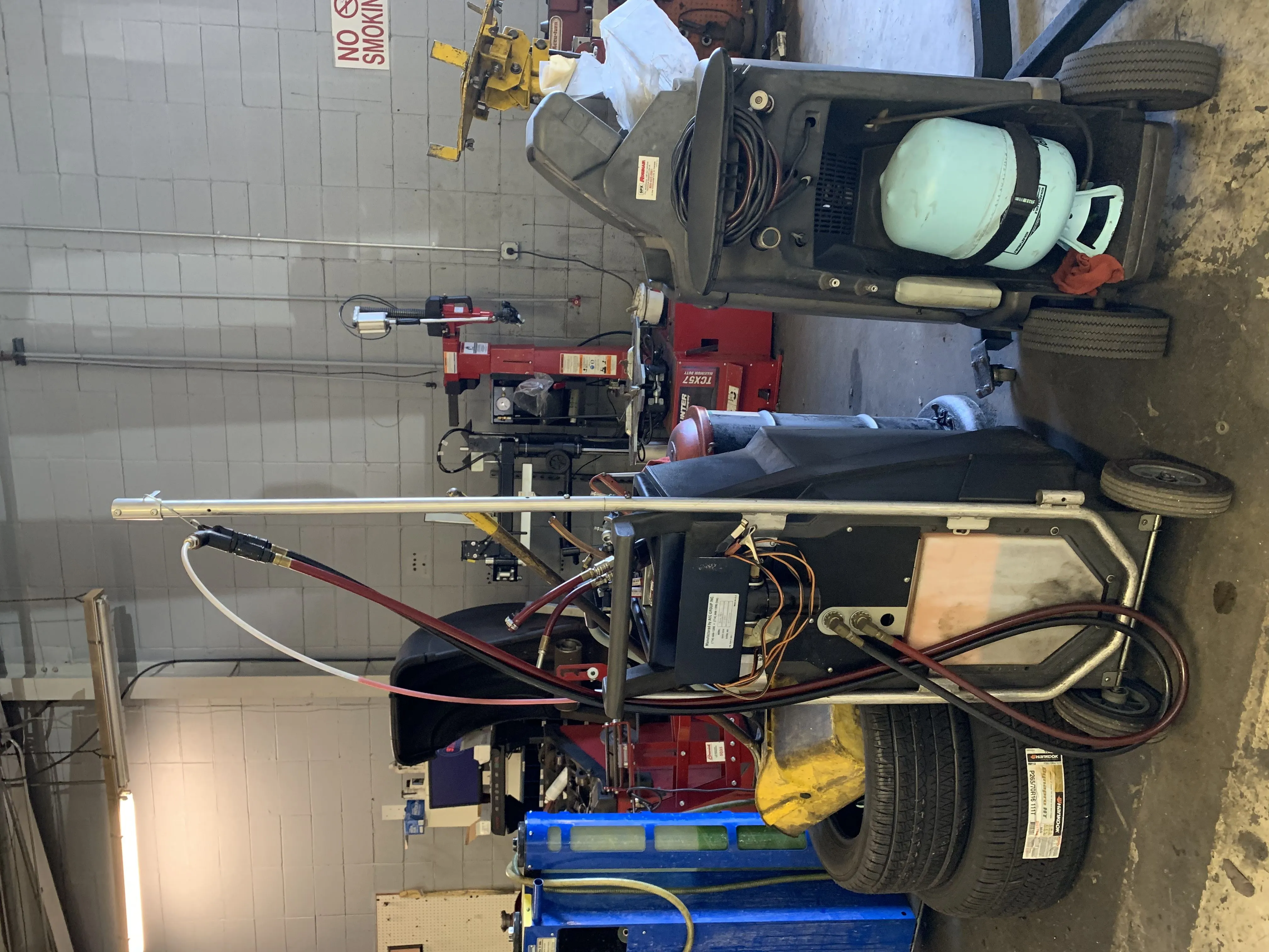

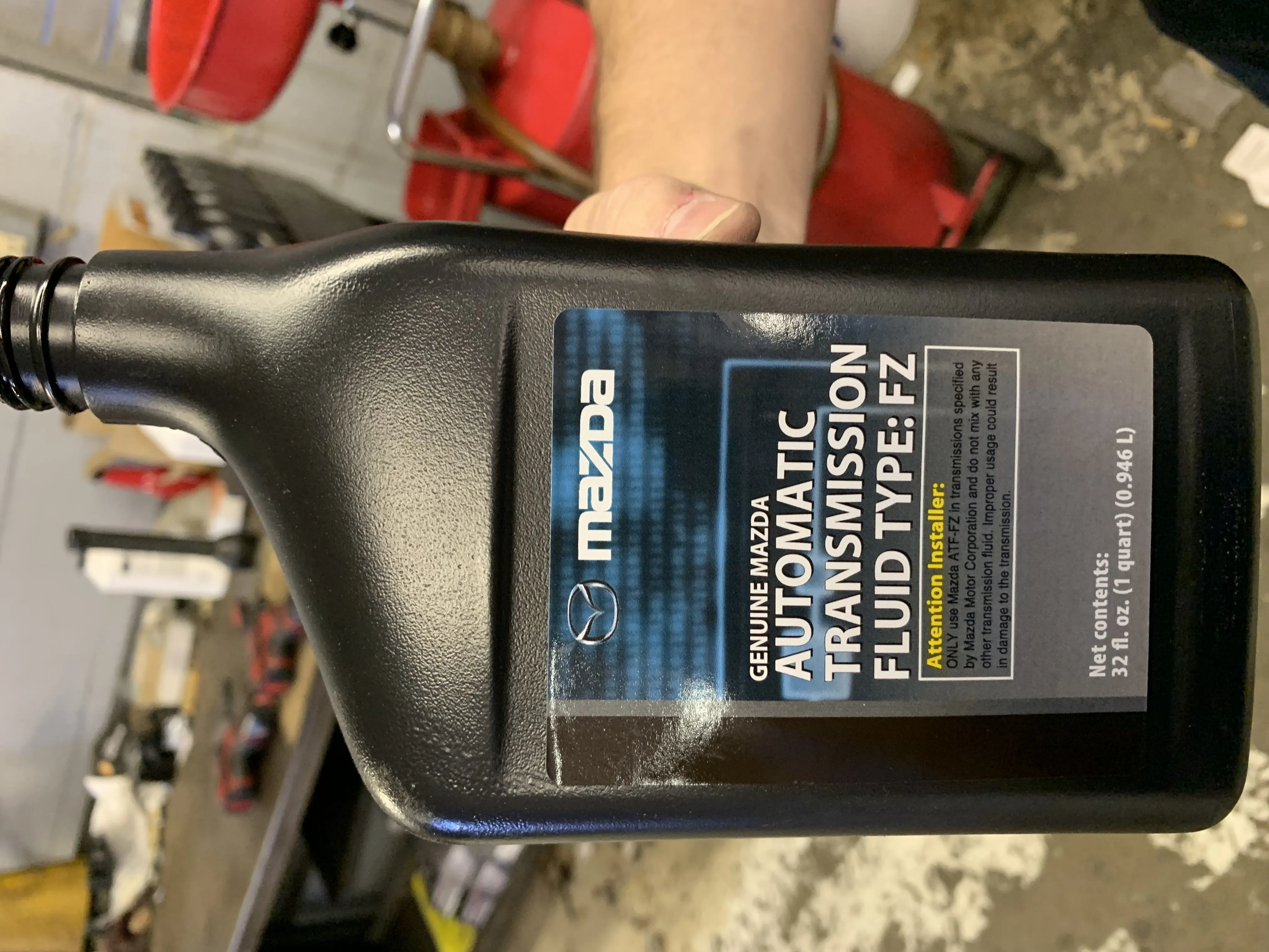

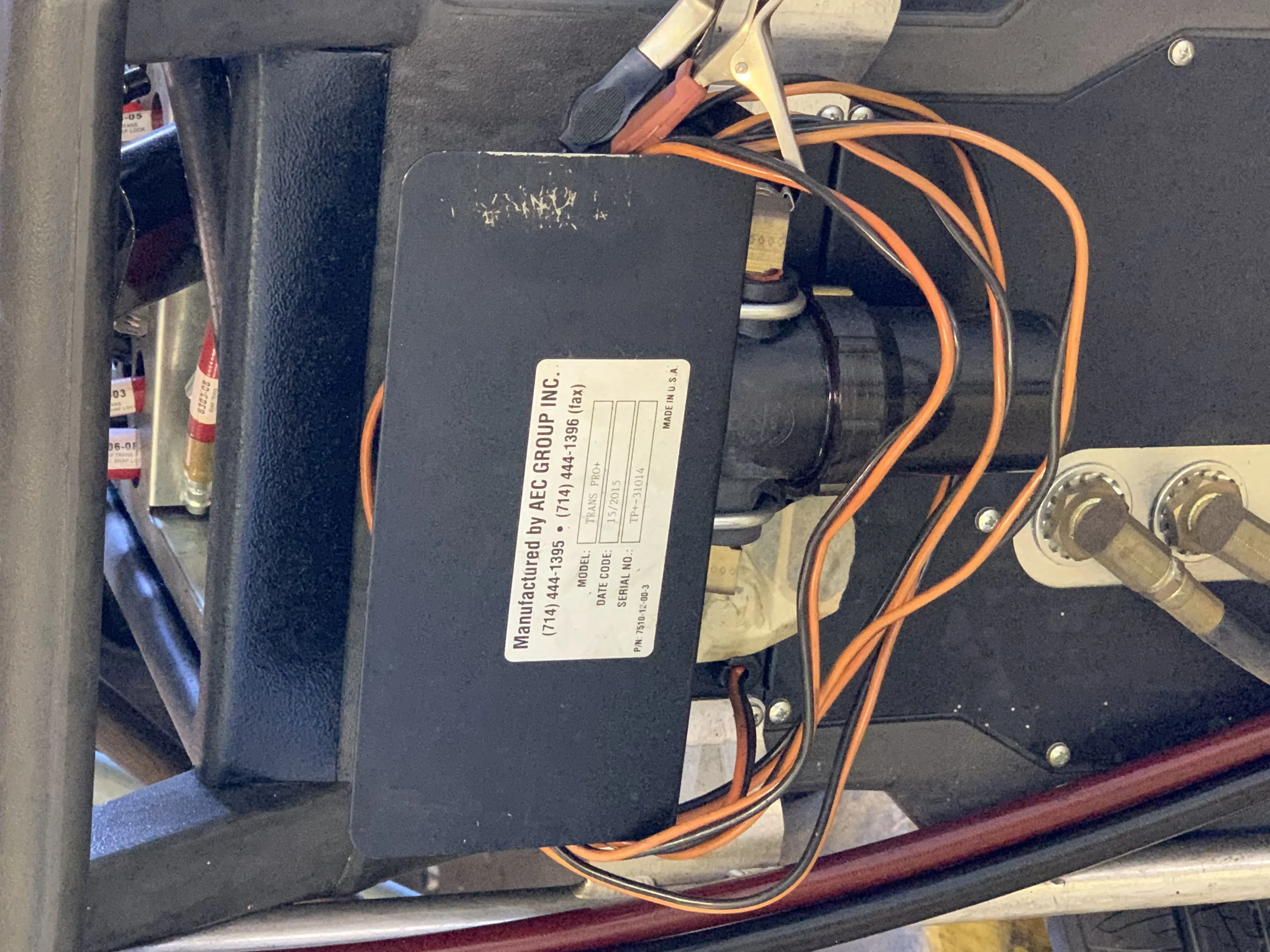

Got my ATF change done. I have attached some pics of the machine and the fluid they used. I was able to apply a coupon and get it done for $140. Not bad I guess.

Can you tell from the invoice that how many quarts of ATF the Mazda dealer had used? For $140, it definitely is a good price with genuine FZ ATF for a job done by a dealer.
The Trans Pro+ X Series in the cart is a standard ATF flushing machine. Based on pictures they seemed not to have a special ATF cooler adapter. They sucked old ATF and fed fresh ATF through the ATF dipstick hole. It's not ideal but this's one way to do it with a commercial ATF flush machine when there's no external ATF ports to hook up.
They billed me for 4 units (quarts?) at $18.40 each, added $90 on top (labor?) and then applied the discount.
