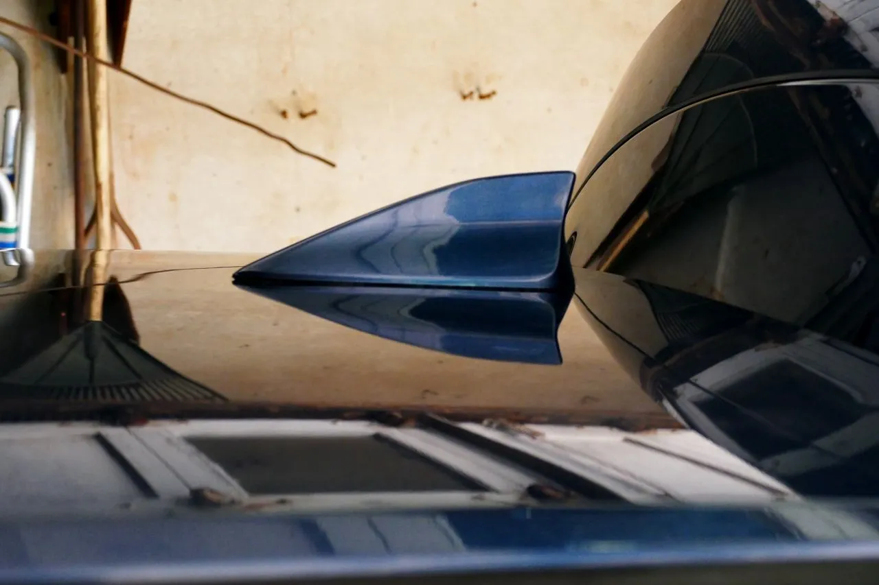

In my haste, I pressed the garage door button and the garage door stopped before opening full, and when I backed out, my antenna hit the garage door and it is now loose. Does anyone have experience with taking off or reattaching the shark fin antenna?

It beat me. I learned that there are two clips that have to be pressed to get the antenna out, which would be fine. But I could not get the wire connector undone. They have some kind of trick connector that somehow hooks in, I could feel it have play pushing it in and out, but there are no tabs or anything to depress to undo it. Struggling with it got me close to messing up the headliner. So I put it all back together. My antenna is tight and the front touches the roof but the back has a quarter inch gap.

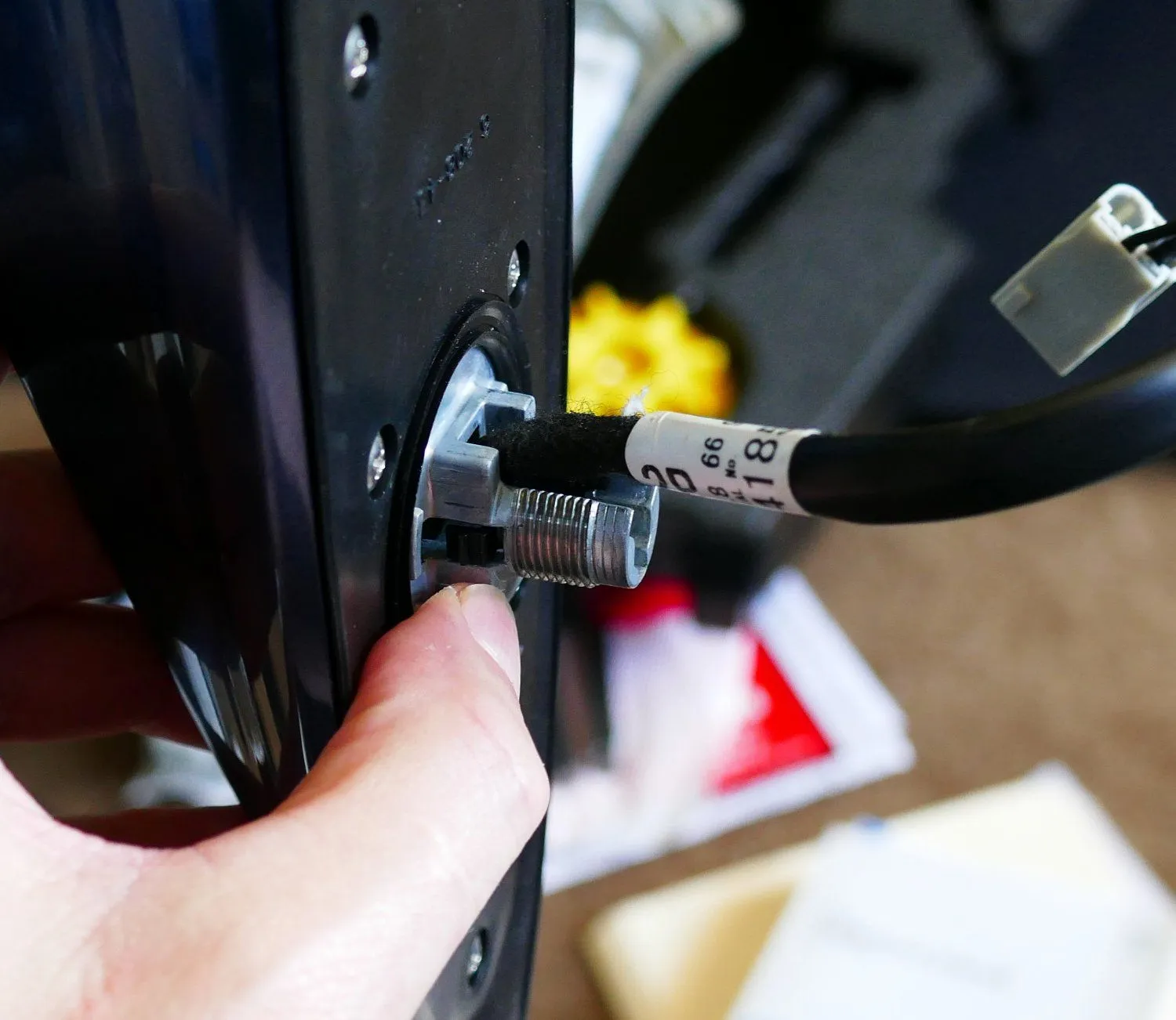

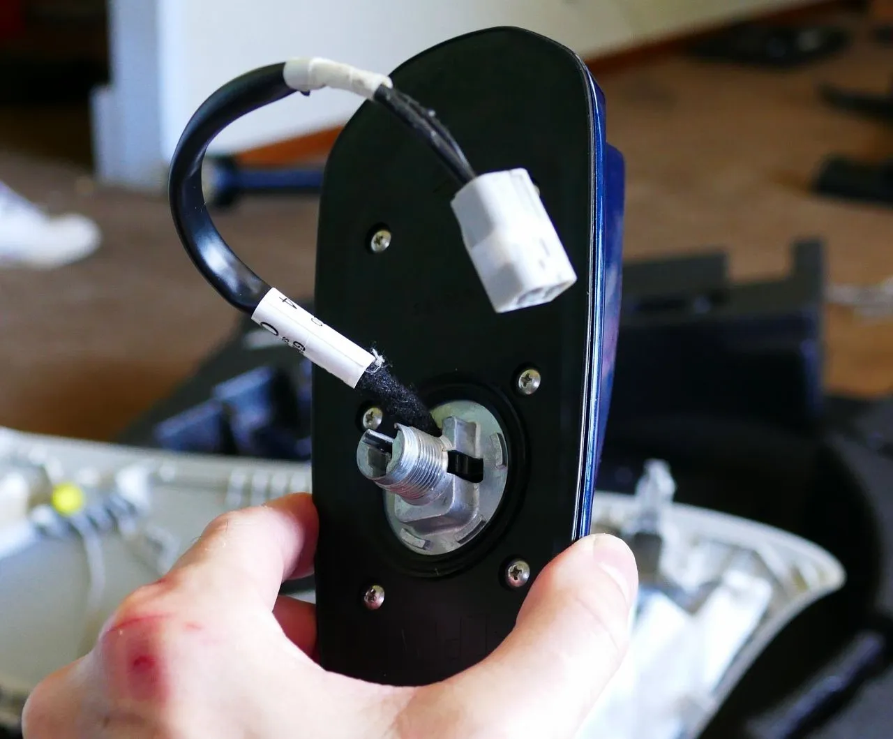

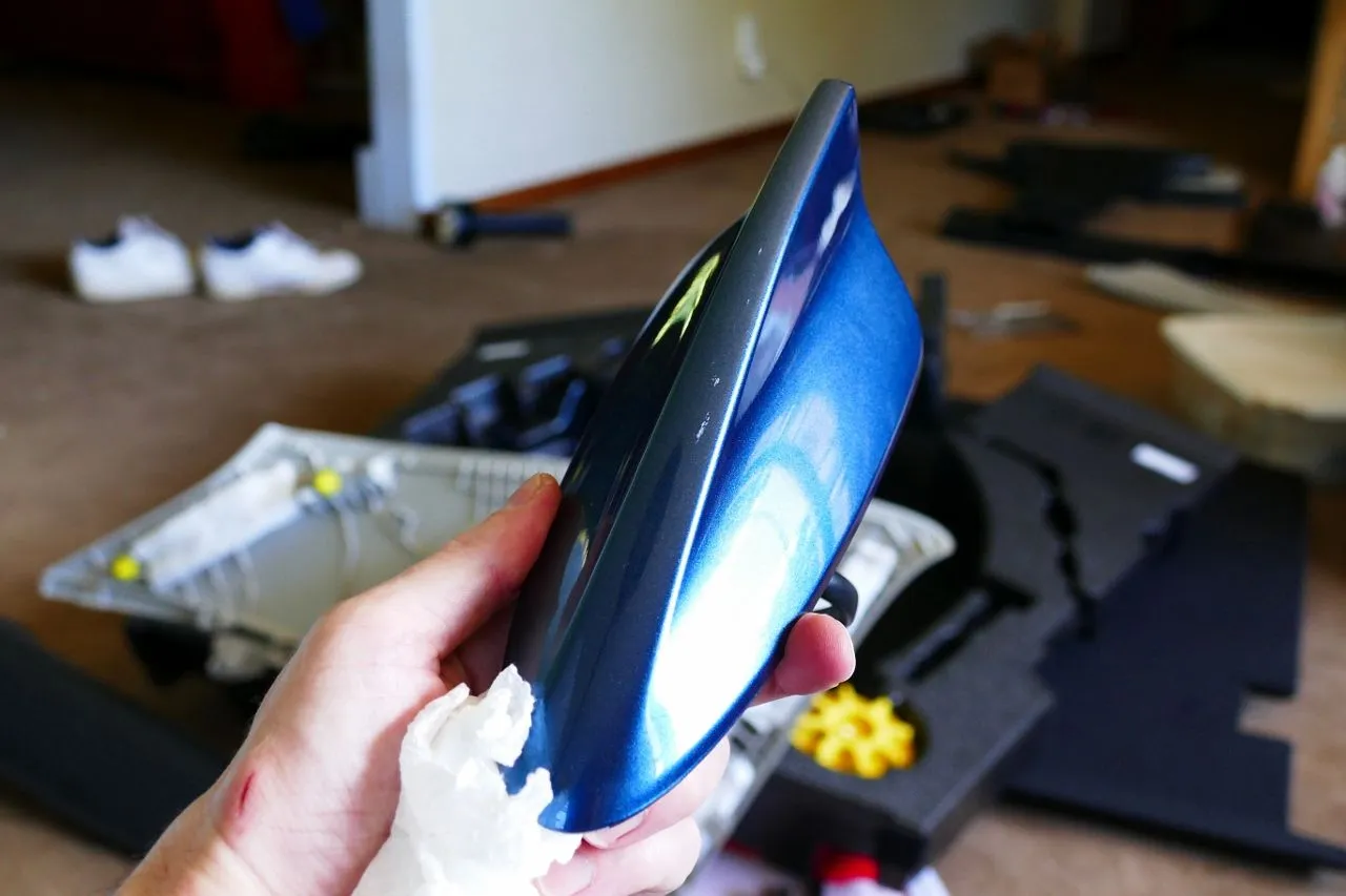

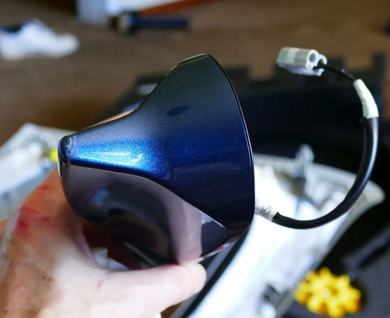

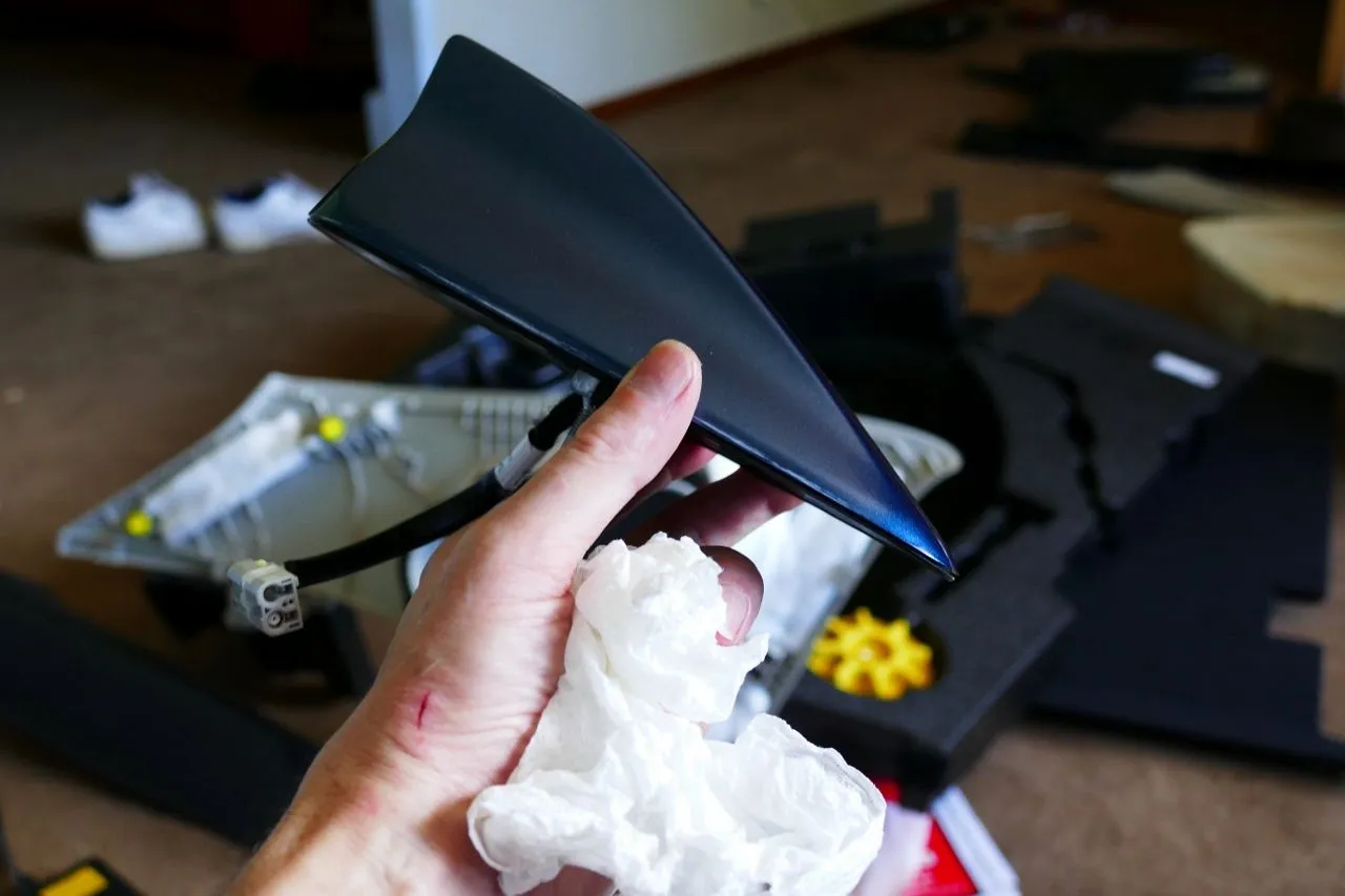

I got it off. The stupid clip was easy after all, the push down levers were on the opposite side of the plug to pull out. To get the antenna out had to squeeze the two tabs and push from the inside. The antenna looks fine, I was thinking the metal connection pulled out from it, but nope. Now I have to figure out why it doesn't fit flush on the roof.

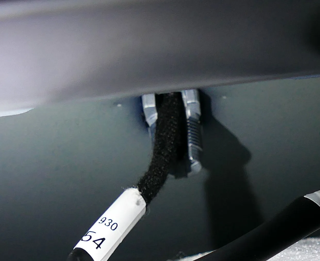

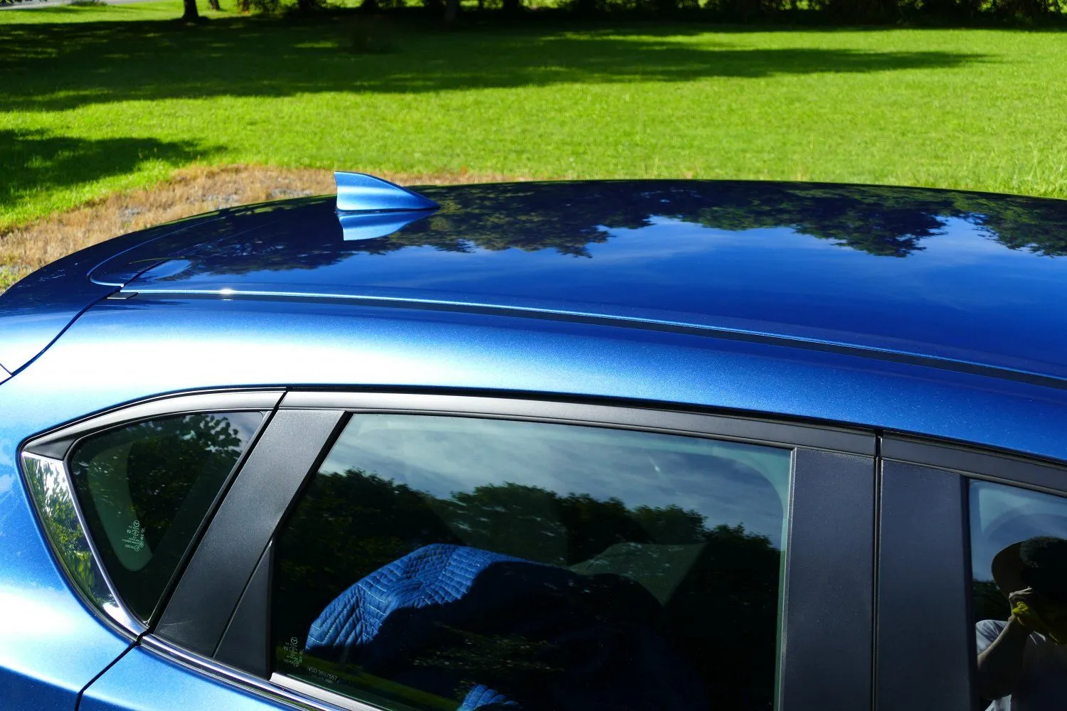

Taking a break. I think it didn't fit right is because the roof bent upwards where the hole is. I used a flat block and then a bolt tightened down from underneath to flatten it (Pic1 before pic2 after). I am hoping the antenna will now will fit nicely. My roof also has a slight impression in the front where the antenna sat. Not going to worry about that.
