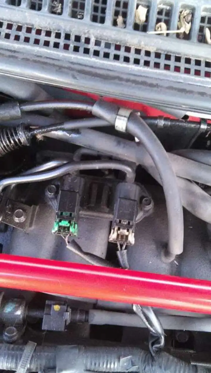

the 401 is most likely one of the valves on top of the manifold. check vacuum lines first. fixing that would probably clear the 456. yeah, remove and clean egr.....known to carbon foul itself.

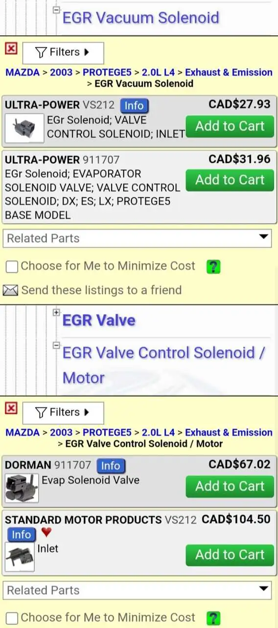

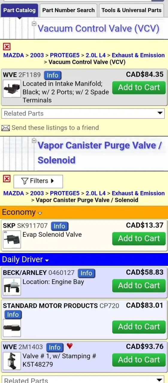

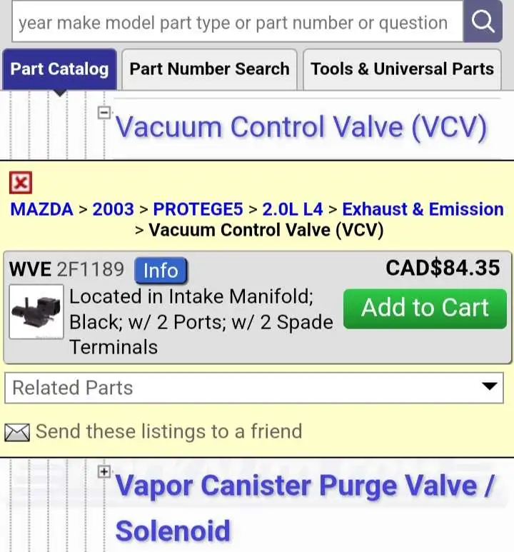

These are the two valves i12drivemyMP5 is referring to.
I think everyone here on this forum has had to replace one or both of those valves.
These are the choices at Rockauto.
The $13.37 one is all you need.
The other ones that have the same design are the same thing.
View attachment 316932View attachment 316933View attachment 316934
