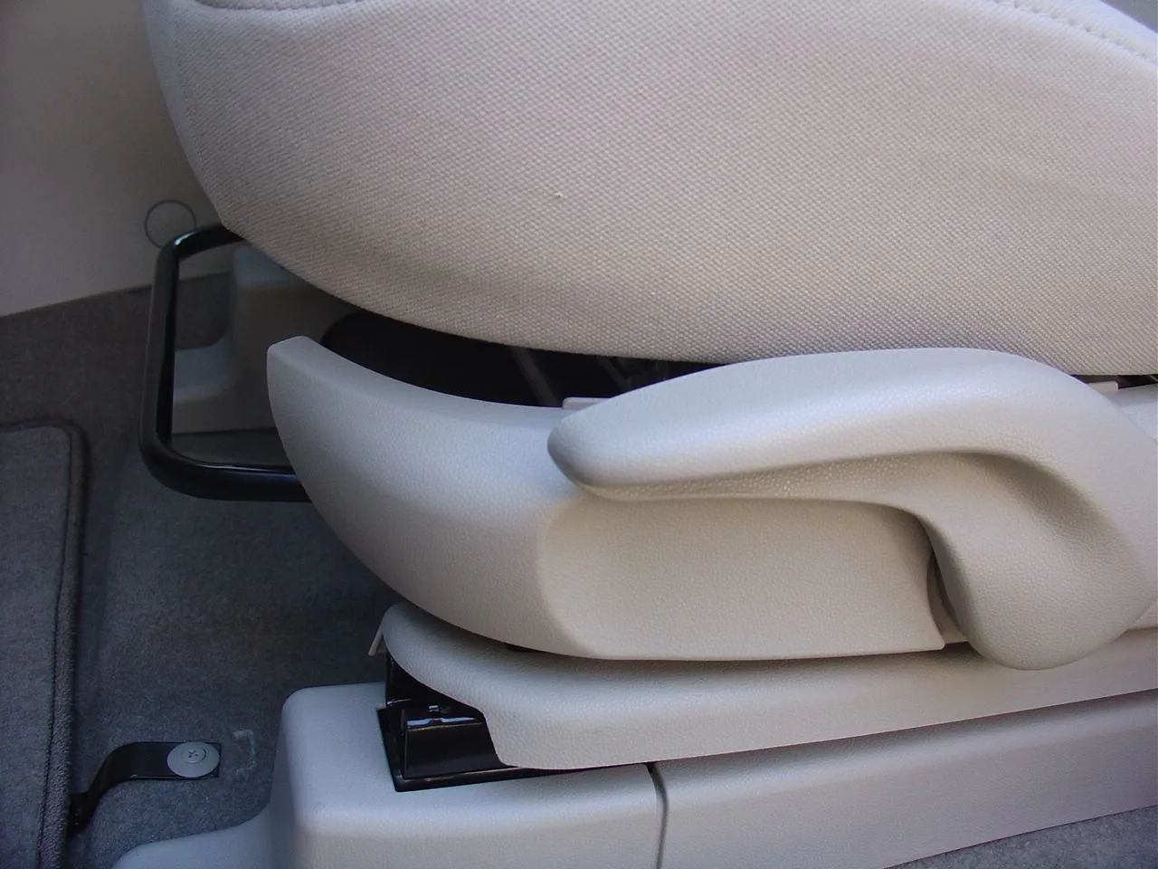

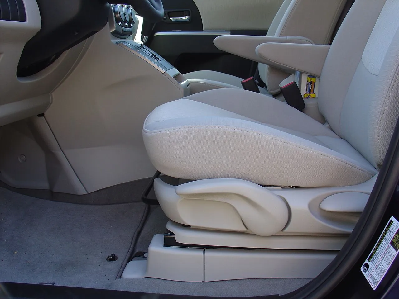

Here are some pics :
#1 shows the gap from close up
#2 is what I did temporarily to make sure this is a mod I can live with. At the moment I have a long bolt from underneath and 2 nuts on top to hold the spacing. The bolts extend just enough to "locate" the cushion from sliding around. I will get proper bolts after I get some seat time to ensure its what I wanted the seat to feel like.
#3 is the view of the gap from further back.
I should have taken another shot from eye level so you can see how it looks when you open the door, if anyone wants that shot too, let me know. I would really like to get some solid blocks of aluminum in order to space the seat and distribute the pressure evenly, so I will be looking for that and post where I got it. I thought about moving the trim to close the gap but there are too many things poking through to move it easily. Also you should be able to do this without removing anything more than the front bolts on the seat cushion, there is enough play in the cushion to place them in. Enjoy!

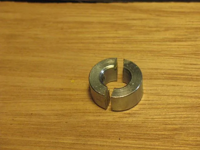

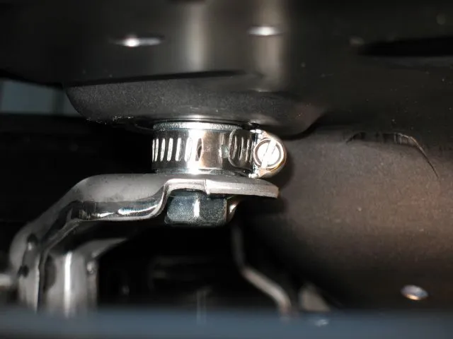

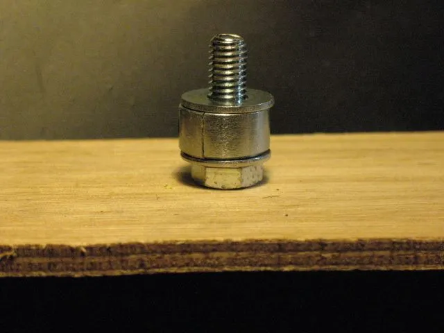

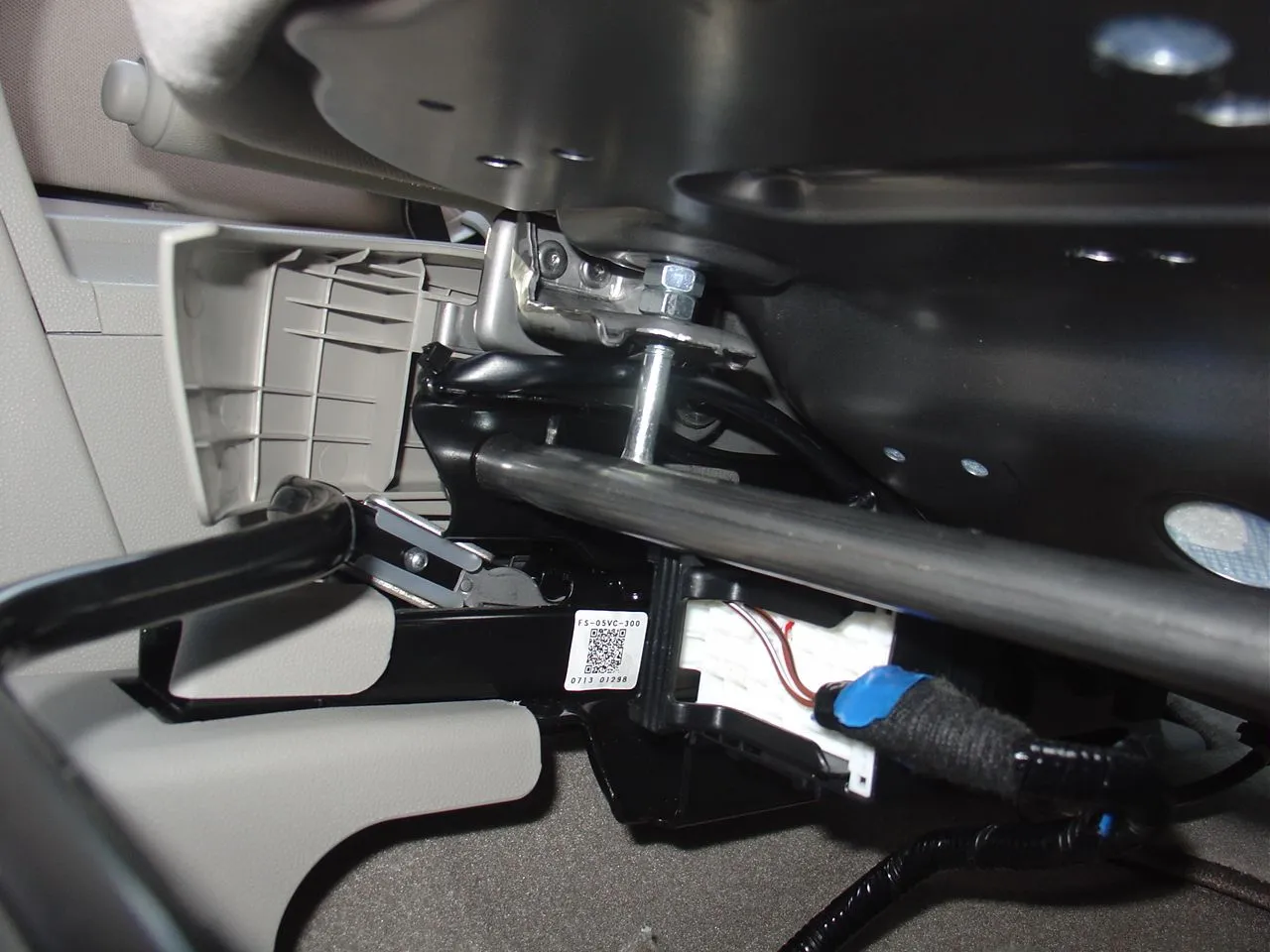

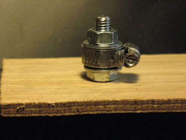

Well I finally got back to this project. I was concerned about threading the longer bolts into the seat bottom due to the new angle between the support and the seat bottom threads. I could not find tapered bolts locally in small quantites. This is the current fix. I used a 3/8 X 3/4 shaft coupler that was at the local hardware (True Value) in those many pull out drawers. Basically I cut the coupler in half and added it after the new bolt and with washer was threaded. Since there was only one washer thickness, the bolt threaded easily.
I threaded the new bolt with one washer into the seat. Then the seat was lifted, and the two halves of the coupler were placed around the bolt. I added a hose clamp just to insure nothing moved when I tightened the bolt. Hopefully the pictures will give you an idea of what I mean. The nut on the bolt in the picture would be the seat bottom. So far I have only done the passenger seat so my wife will be driving me around for testing. Note from the pictures I went to one washer during installation.
This almost equals 1/2 inch of lift. So far from just sitting in the seat I like the results. Time will tell. A bit of a pain this way but worth it.
Not good at adding pix so let's see what happens.
