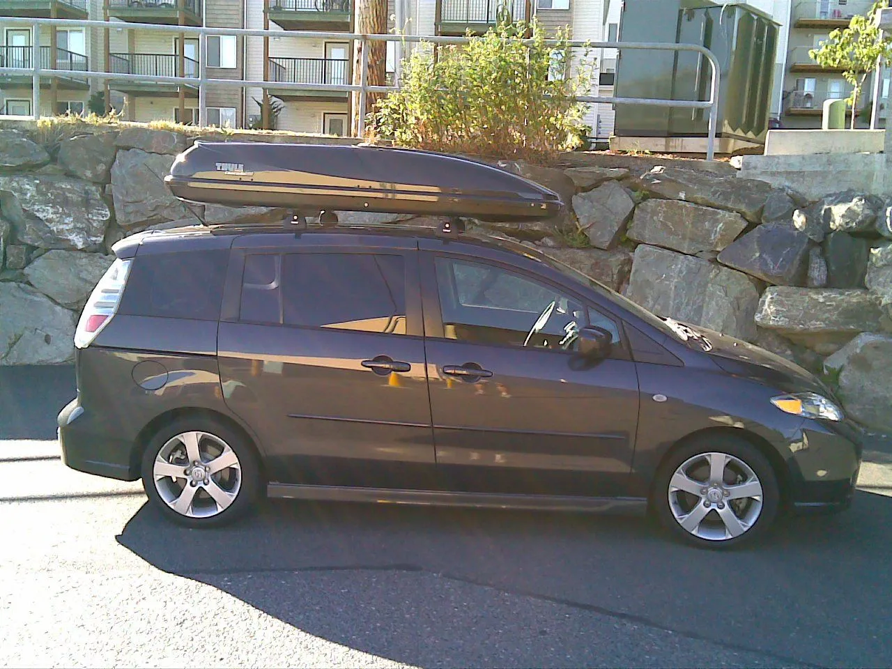

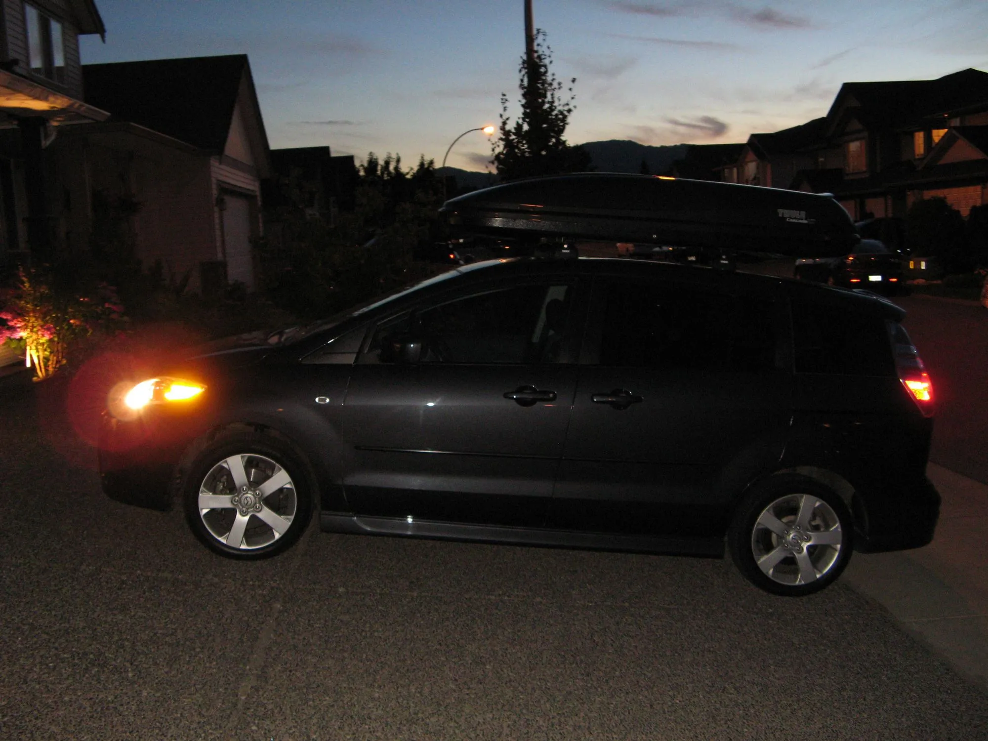

Installed a Thule rack yesterday with the 460 Foot Pack, 3069 Fit Kit, 50" bars, and a Cascade XT 1700 cargo carrier. Also took pics of the install enough to put together a "How to" but not sure if anyone would gain from it. Here's the pics:
That carrier box seems much slimmer but longer than the 1500, that is for sure. It is almost touching the antenna, no wonder you asked earlier (scratch). Regardless, it looks it fits pretty well the MZ5
It's got about 3 inches between the box and the antenna, but that's with the box adjusted so that it's as far back as possible. With the adjustable Quick Snaps, the box can be brought forward more. I'm surprised at how cavernous it is inside...it'll be good for the 2200km roadtrip from Vancouver out to Calgary, Red Deer, Edmonton, the Rockies, Prince George and then back down to Vancouver. It's gotta hold everything a family of 5 needs clothing, etc. wise for the trip. I'm looking forward to how the whole thing performs AND if we can squeek 40 imp. mpg on the trip (thumb)

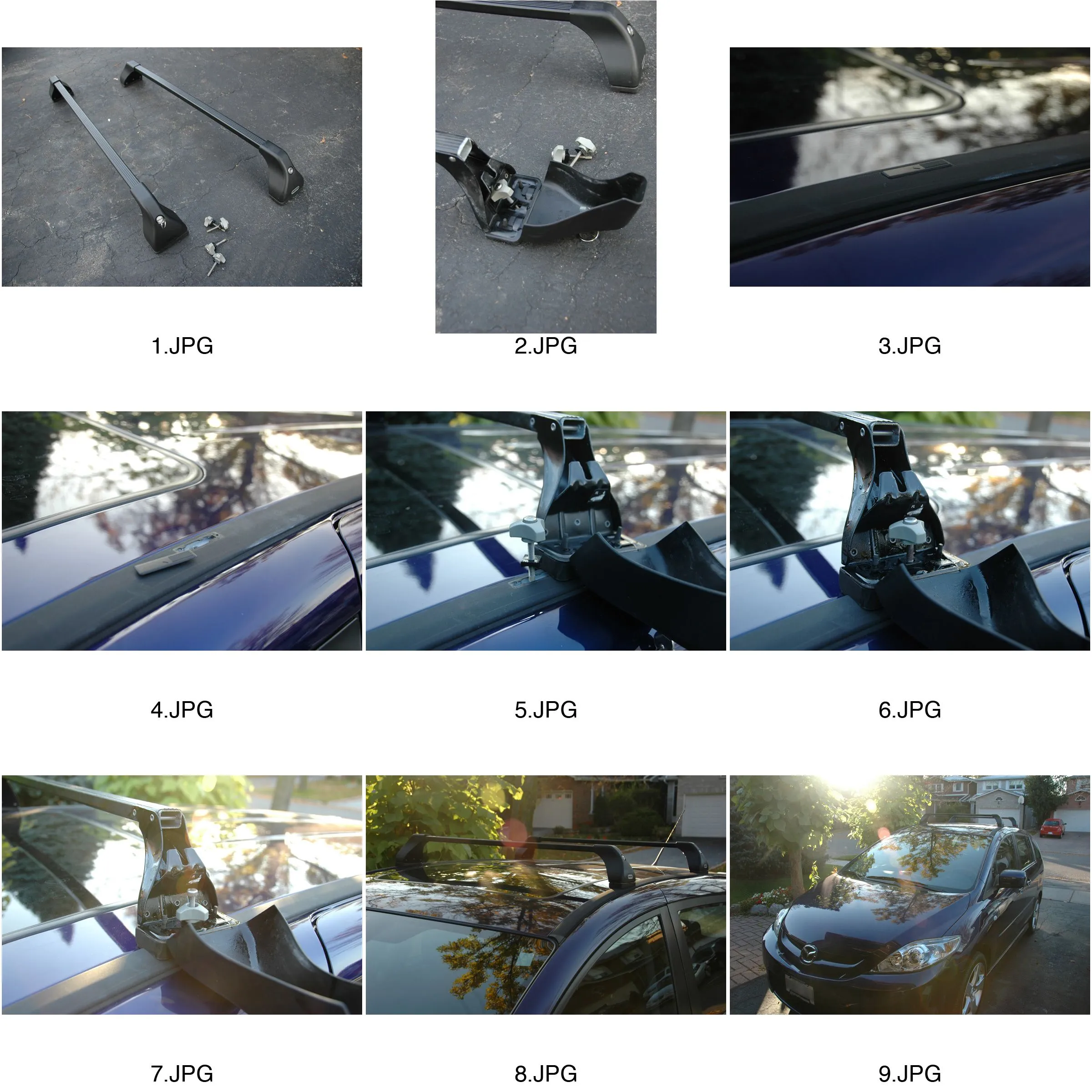

Hi guys. This was an informative forum which help me with info about getting racks for myself. I ended up finding some Mazda 5 racks on ebay and purchased them there. I recall someone asking about a step by step instruction on installing racks so I took it upon myself to photo document my installation process. It was very easy as most of you have mentioned. The only other thing I would add is to spray the racks with a rust protector (you can see it on picture 6). This is especially important if you are using the racks through winter as I will be carrying baby stuff such as strollers in a thule box throughout these months. That way the bolts won't rust to your car, something I learned from my previous vehicle. Hopefully I have installed these racks correctly but if I didn't I am sure you guys will let me know. Hope these pics will help any future mazda rack installer. Good Luck.
