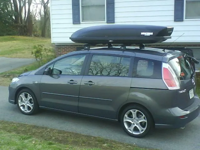

Rack and cargo box installed. Thanks!
Just wanted to add my info.
After a long search I finally decided on a rack and cargo box for our Mazda5. Thanks to all contributors here for helping me decide. I will post some pics later when I get around to washing the car :D
I went with the OEM rack after realizing that the Thule and Yakima setups with the respective adapters would not run any cheaper. So I figured I might as well take what's made specifically for the car. Found a good deal on Ebay, got it and the install was indeed just a matter of minutes.
For a box I found a near new Thule Cascade 1500 on Craigslist. It looked huge in the garage but once on the car it fit quite well. The Antenna clears and there is no interference with the hatch and no overhang over the windshield.
Now we're all set for our big camping trip this summer. And with an overall price-tag of just over $400 we're better off than with a rental van, like we did last year.

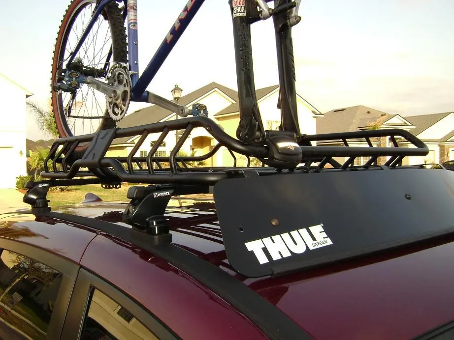

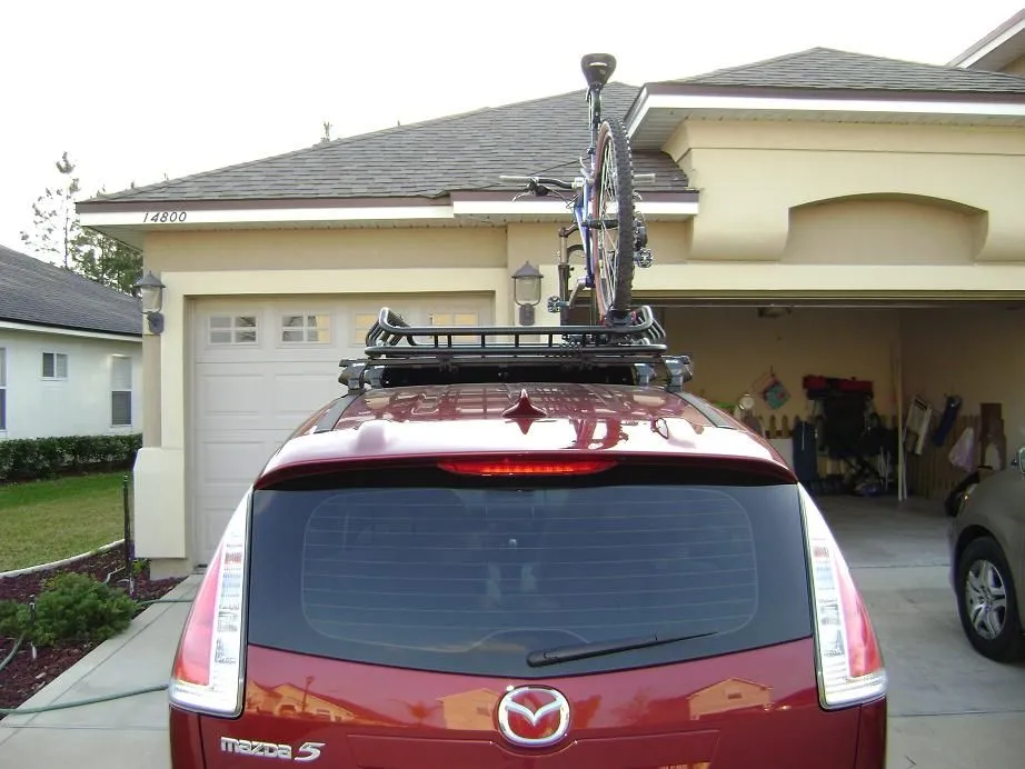

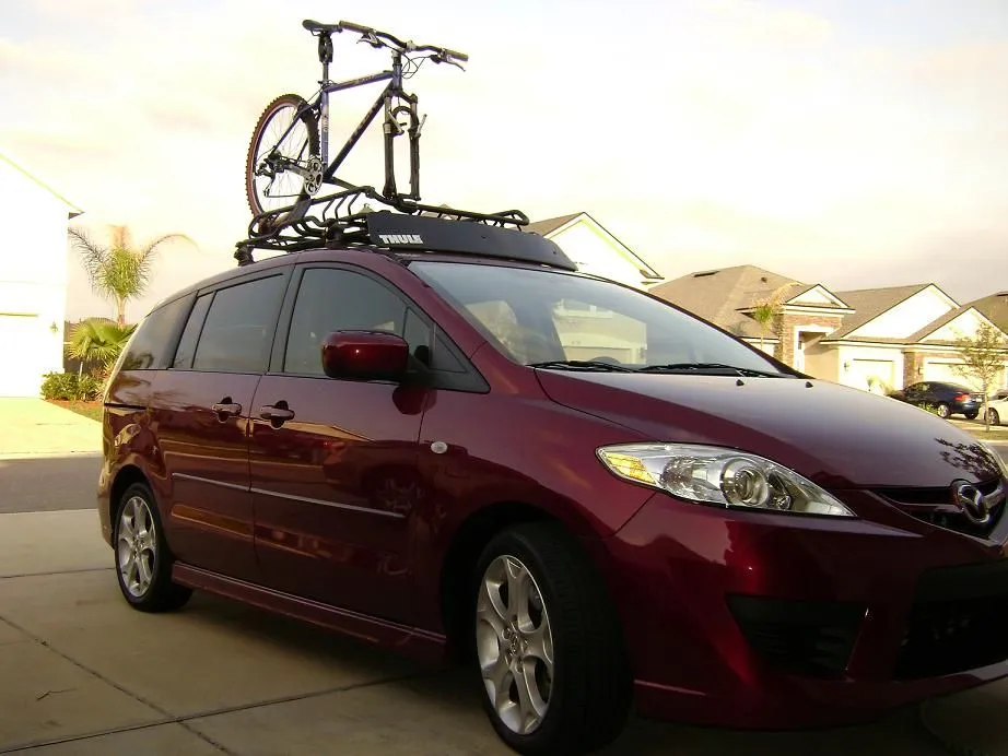

After looking all over the internet I got myself several pieces I was able to assemble together. Tried to drive and everything still in place.
Inno rack, 1 set of Yakima Boa on the RAGE basket, Thule fairing (removed from the other car and bought new one to replace).
Comments welcome.

Does anyone know the weight limit for the Thule roof rack?
I roll with 2 mountain bikes up top with 2 Yakima King Cobras.
It looks like there is only 4 small bolts that hold the rack on?
Should I be scared?
No, you should not. People behind you should. :)
I believe Mazda claimed 100 lbs is OK. Not only 4 small bolts holds the rack on - the whole roof is for this. Small bolts just keep it from moving.
For my bulky system I calculated the total weight - 25lbs basket, 15lbs racks. One bike is about 25-30 lbs - Mazda will hold all of it. Would not put anything else in the basket with two bikes, anyway.
Outlander -
