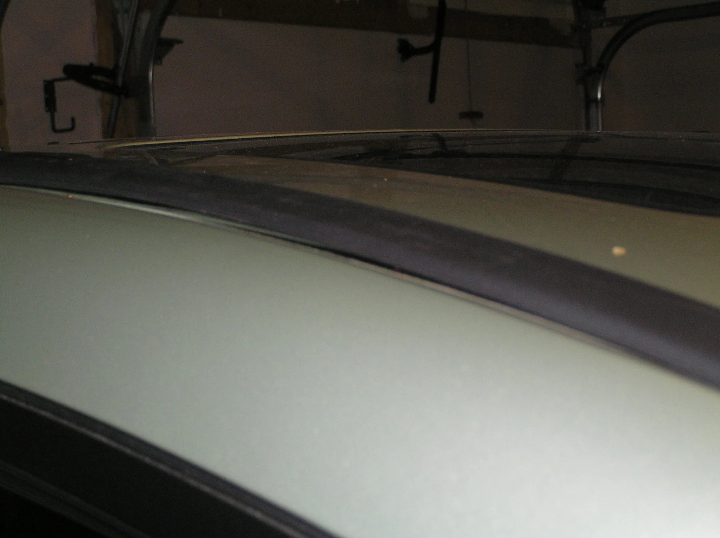

I just installed a Thule roof rack last night and it was pretty simple to do. I did make a mistake at the end, though. I was talking to a neighbor and I wasn't paying too much attention to what I was doing and I tightened the front right bolt too tight and it bent the metal underneath the plastic strip and it is now warped and lifted about a quarter inch off the car. I have removed the rack and tried to push it back in place, but to no avail. Does anyone know if it is doable to pop off the plastic strip and bend back (or replace) the metal bracket? I feel like such an idiot for screwing up right at the end. The rack really was easy to install.
On a related note, I bought the Thule 604 Ascent cargo box and if fits nicely on the 5. I will post some pics as soon as I reinstall the rack.
Attached is a pic of the damage. Basically, the black plastic strip is now raised a bit because the metal strap below it is bent (from tightening the bolts too much). I hope rain won't do any harm to the car.
I know it's not what you want to hear, but I don't think there's an easy fix for that. Unfortunately, you may have to go to a body shop to make sure it's fixed right.

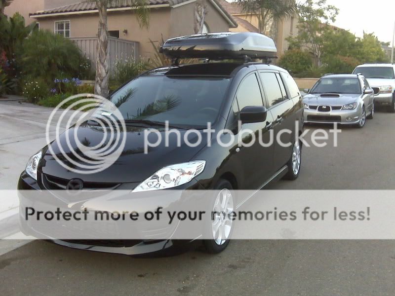

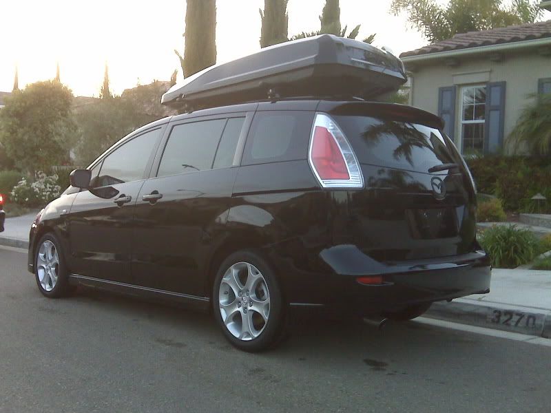

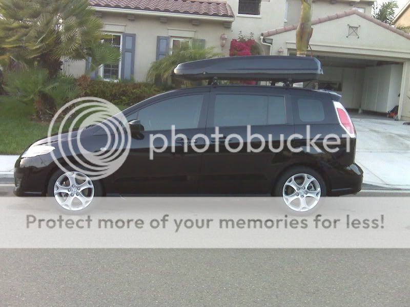

Here's my setup - Inno Ride Wide cargo box on Inno XR cross bars mounted to tracks I had installed on the roof. I can fit SO MUCH stuff in that box. I usually just keep my surfboard and wetsuit /inside so I can stop at anytime to get a surf in :p But I use the space this car offers for work, and the box just adds to the utility.
