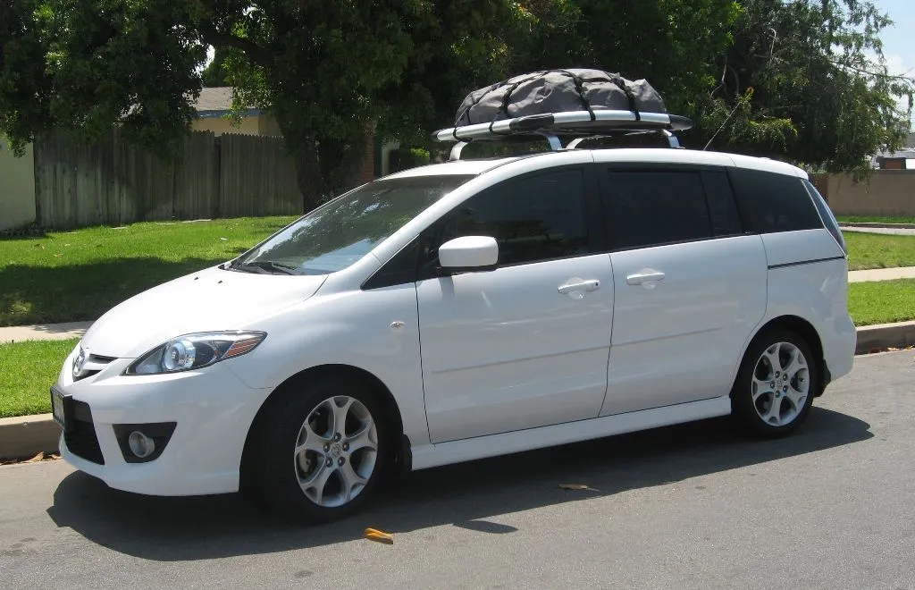

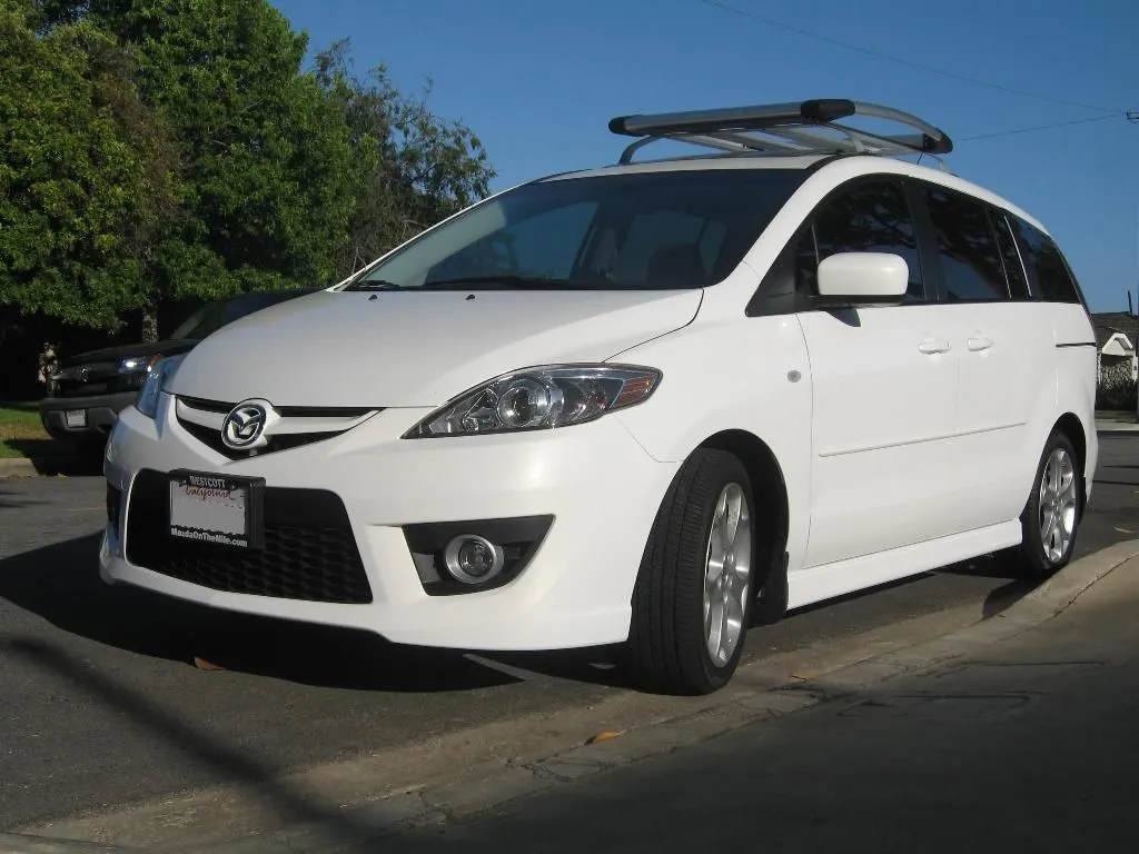

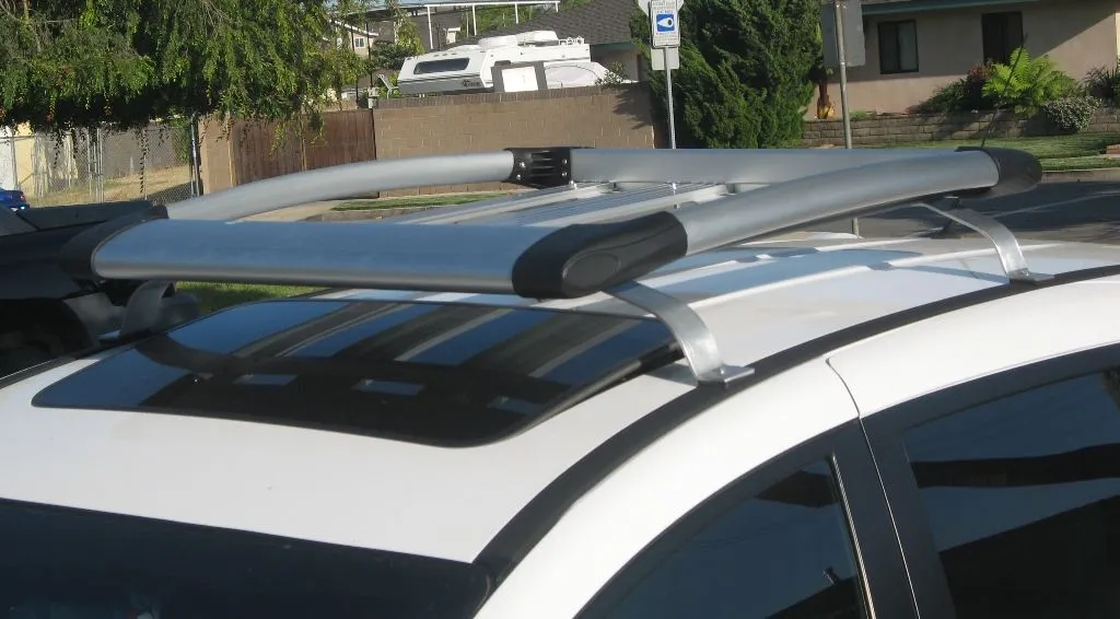

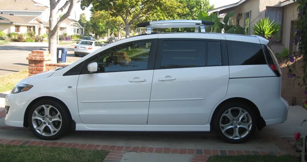

2008 Mazda5 custom roof rack basket and cargo bag
Here is a slightly different approach on a roof rack for my 2008 Mazda5. Using an aftermarket aluminum GARAGE-Pro Polaris Roof Basket from JC Whitney, 47x 40, I fabricated some custom crossbar/brackets using flat extruded 3/16 x 2-1/2" 6061-T6511 aluminum with rubber pads that fasten directly to the -4- fixed roof points with grade 8 bolts. The bracket and pads carefully clear and do not make contact with any paint, a very clean setup that looks like it could be a factory install. My first attempt the basket was about 7.5 above the roof line, enough to fully open the sunroof, but the basket sat so high it looked very much out of place. The basket now stands about 4.5 above the roof line, enough to fully pop the sunroof up, but not slide it open. The entire rack is light enough one person can install and remove it.
The basket cargo area is about 3 by 3 and is just the right size to hold our Axius Roof Top Cargo carrier soft bag for about 15 cubic foot of cargo volume on top.
We had a chance to try it out over the 4th of July loaded with 4 duffle bags, three sleeping bags and three collapsing beach chairs about 100 lbs of stuff. It handled well with little buffet or sway in high wind desert passes, and the wind noise was barely audible over the car wind noise with the sunroof door closed at freeway speeds. With the basket empty, there is a light high pitch whistle, so it is not great for a permanent install unless you like your music turned up above a normal conversation level.
Another trip we were able to stuff 3 roller style hard airline carry on sized bags, a soft duffle bag, a couple of backpacks, one sleeping bag and a pillow. This held essentially all the luggage for 6 passengers for a 5 day trip leaving the cabin free for comfortable seating without clutter. All in all, very useful $200 spent and about a weekends worth of fab time.

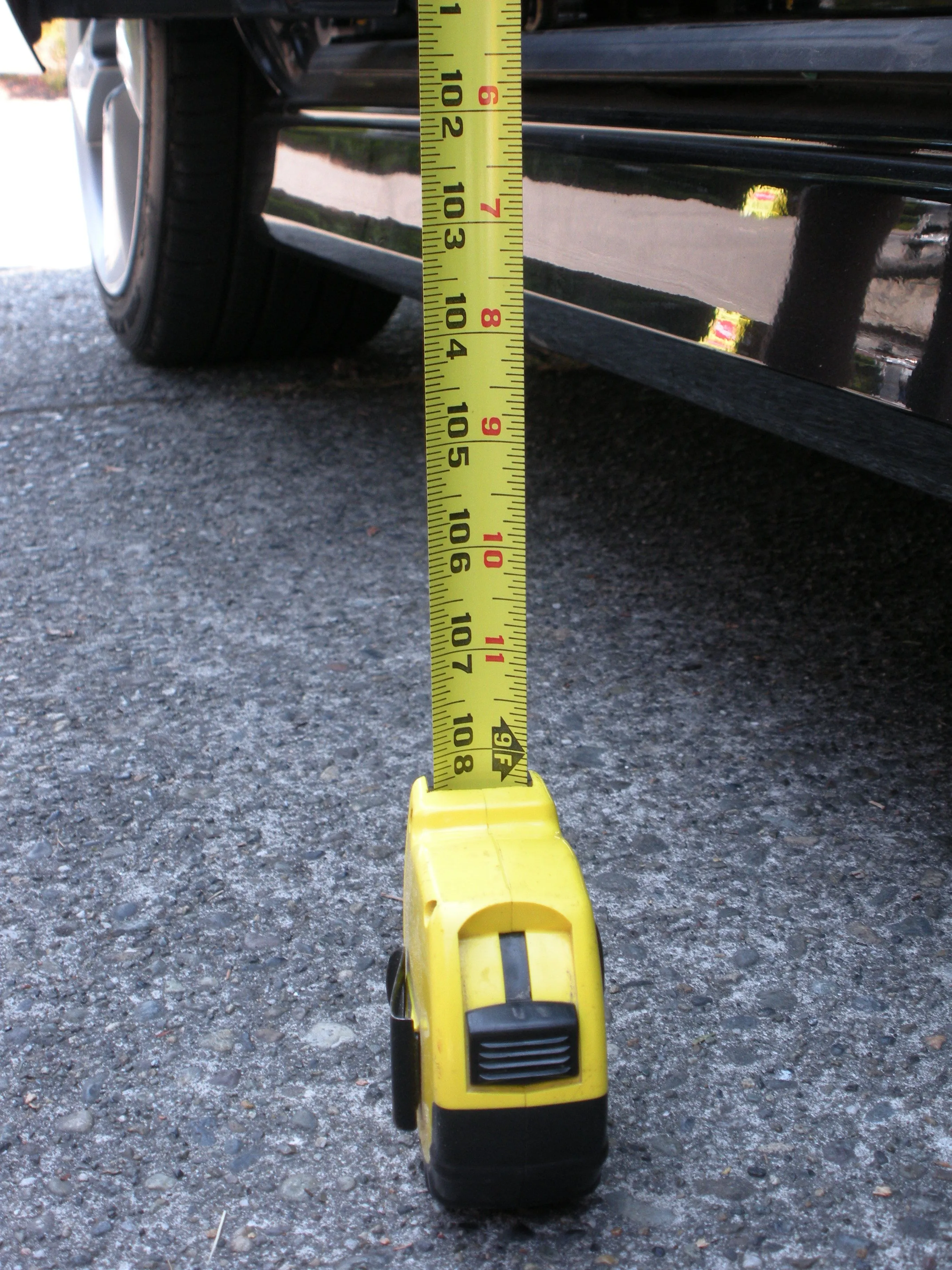

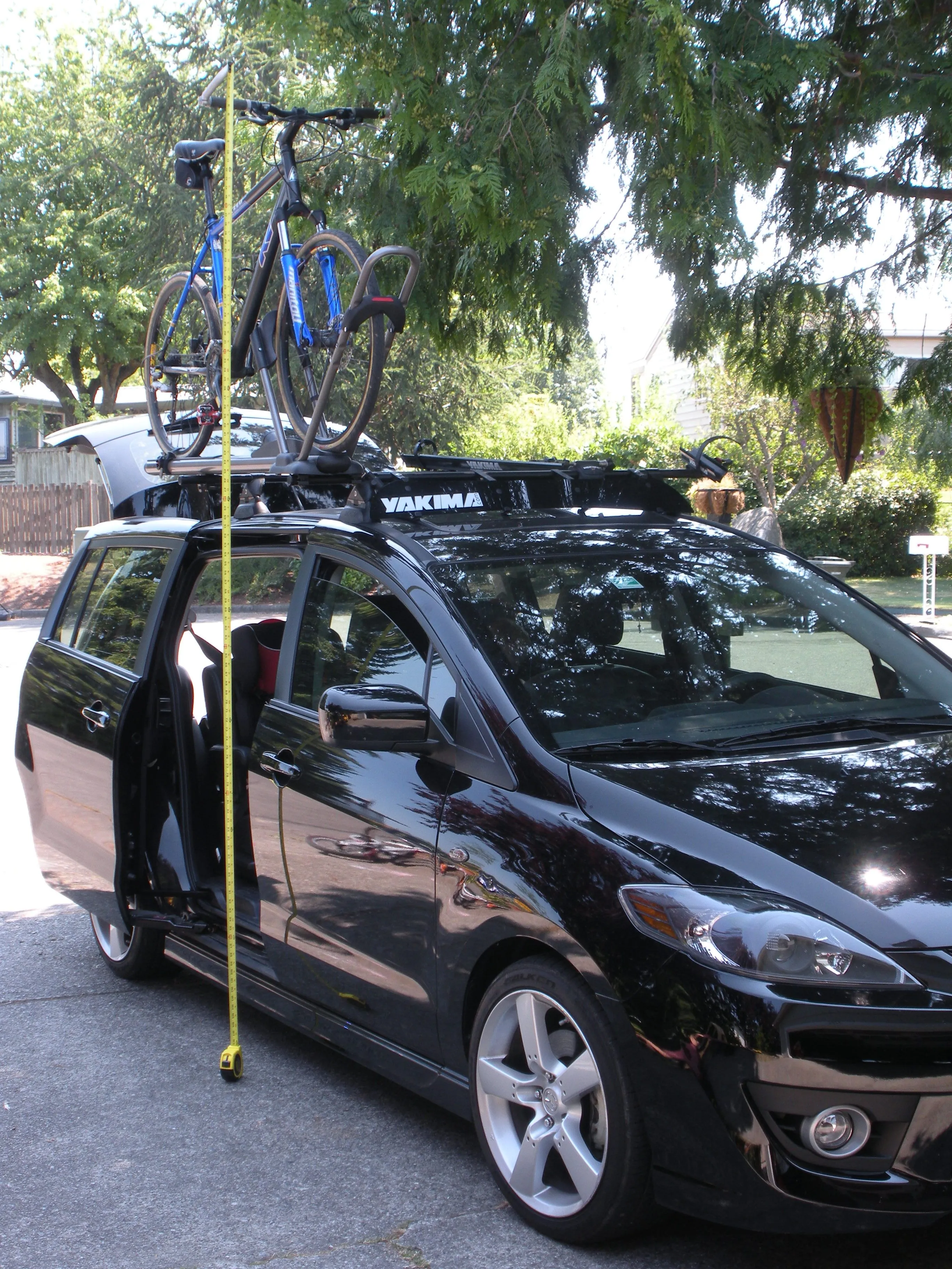

FYI -
When you are carrying a bike, 9ft is the clearance needed through tunnels, drive-thru's, and other low clearance disasters.
michael.
