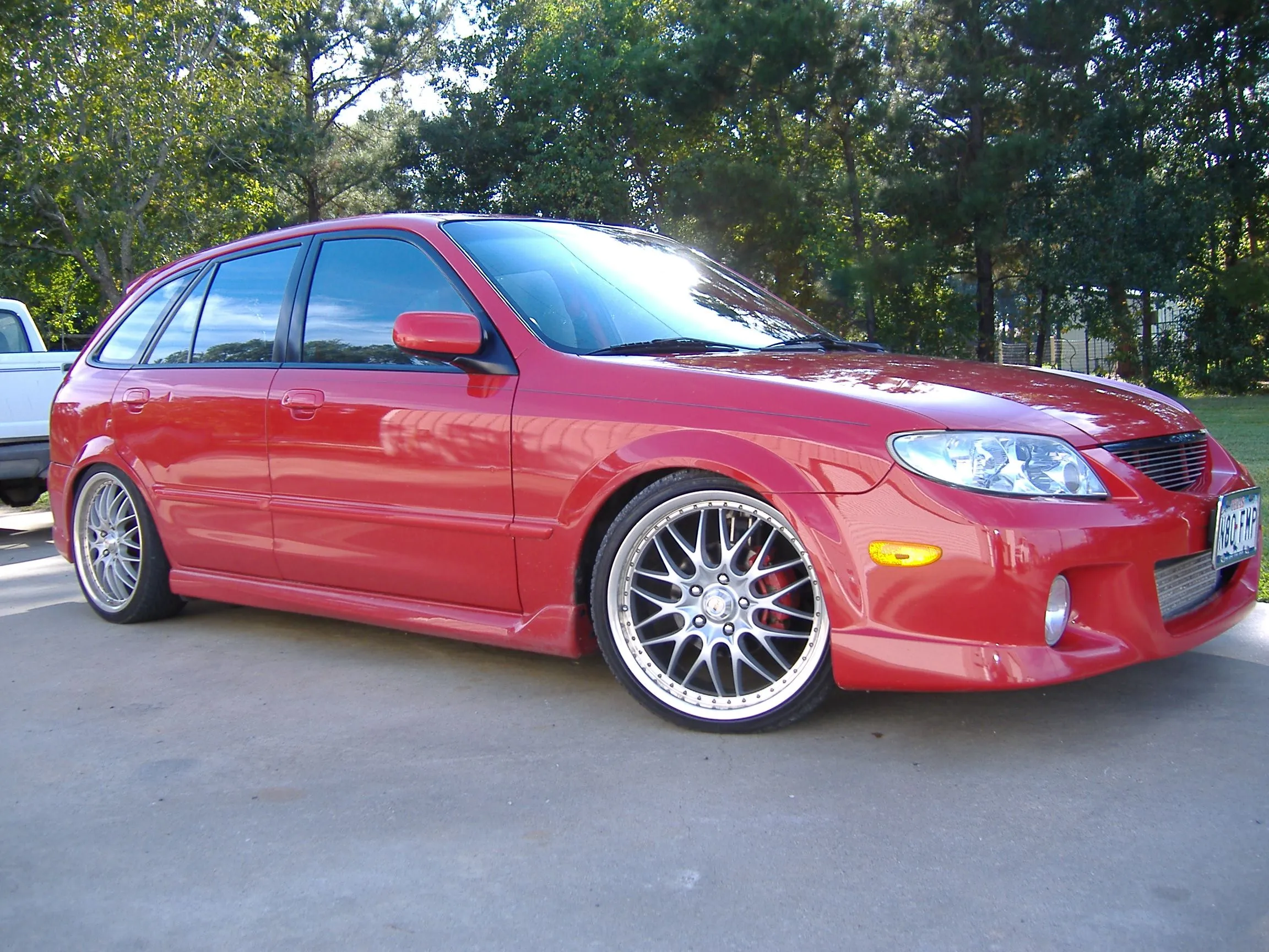

I have 215/35/18" on 18x7.5's with 50mm offset with full coilovers which actually give you less clearance due to the adjustmant collars. I have about .200" clearance to the collars and .200" to the fenders in the rear with about 1/2degree of camber. I am dropped about 2.5-3".

thats a sick ride mate, so u dont get any rubbing over bumps etc? i know what u mean about the coilovers had the same problem on a peugeot 206.
No rubbing in the rear at all. I actually had it about 1/2" lower but when entering slightly inclined driveways and such the fronts would barely rub. I had to roll into them at like 1/2mph and it became a pain in the ass trying to get out of the way of traffic coming up behind me. And dangerous!!
