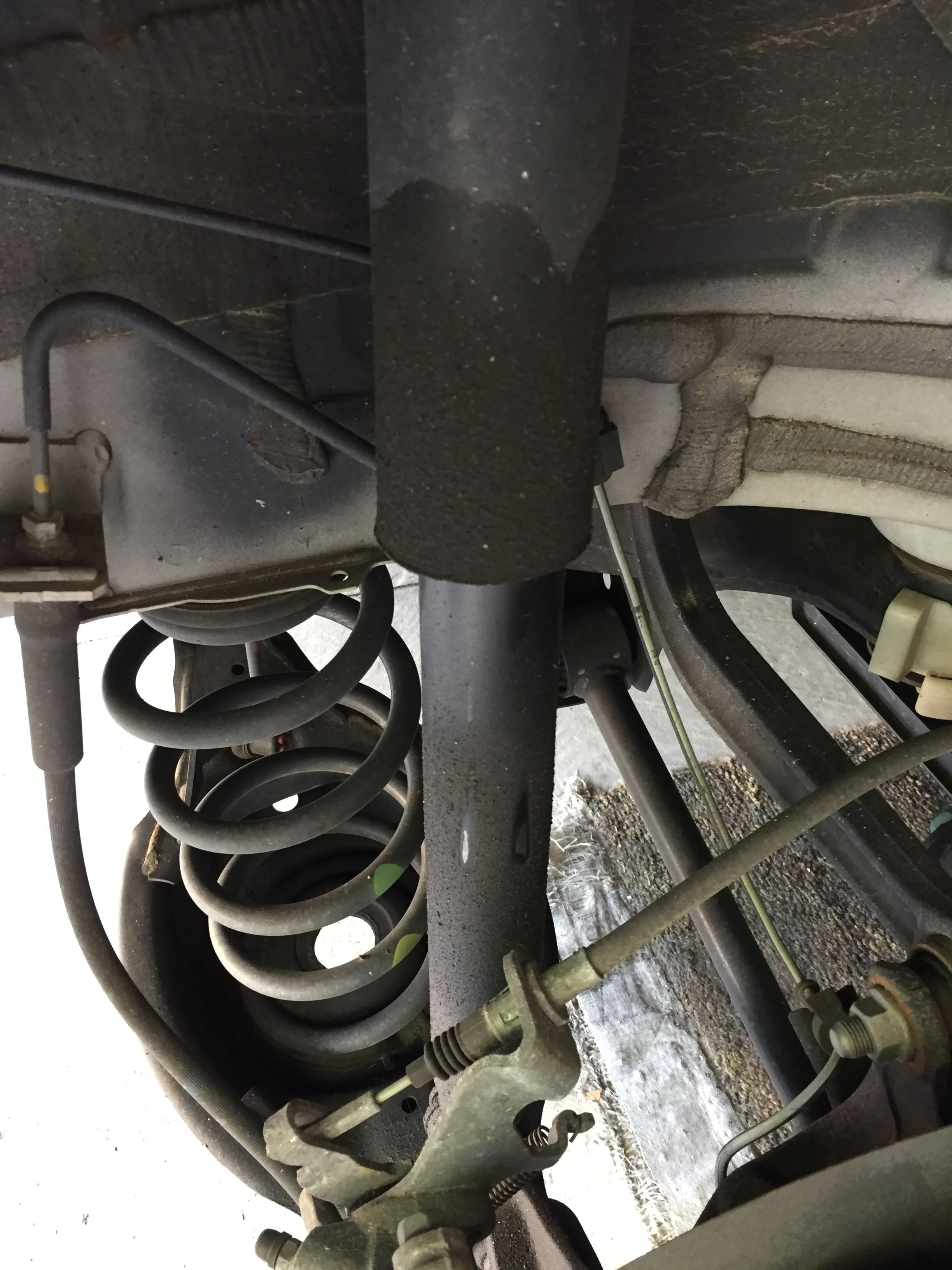

Right rear shock blown at 65K miles
2014 CX-5 Touring
I noticed a sort of "booming" sound from the rear when going over bumps on our 2014 CX5, and when rotating the tires today the right rear shock looked oily. I was thinking of just replacing the rear shocks. Or should I replace the whole set of shocks and struts? KYB GR-2/Excel-G shocks are $90/pair on RockAuto, front struts $120/pair, so about $210 for the set. Any other choices out there? Not planning on doing any aftermarket suspension work.

have you seen this TSB?
https://mazda.oemdtc.com/749/shock-absorber-replacement-guidelines-1999-2016-mazda
Some customers may complain of signs of oil on the struts or shock absorbers.
In most cases the oil that is present is normal, and a result of the oil that remains on the shaft during the normal sweeping process of the shaft seal.
Follow the inspection guidelines to determine if the condition is a result of the normal sweeping process or a failure of the shaft seal.
SERVICE INFORMATION
Inspect the shock absorber by using the following guidelines to determine if shock absorber replacement is necessary or not.
If it is oil seepage, the shock absorber does NOT need to be replaced.
If it is oil leakage, the shock absorber needs to be replaced.
NOTE: Warranty claims submitted for oil seepage shock absorbers will be denied or subject to debit.
CAUSE OF OIL SEEPAGE
Oil seepage is caused by the following factors and is not a problem:
A small amount of oil seeps outside through the dust lip during normal operation.
The oil film thickness is uneven due to production variation of rod and seal.
When the rod (A) receives input from the road and extends upward, most of the oil (B) on the rod is scraped off by the main lip (C) and some remains inside the dust lip (D). When the rod extends further, then most of the remaining oil (E) on the rod is scraped off by the dust lip, and a small amount of oil seeps out (F).
Check out my pic above, it has oily residue all down the entire shock body, and on the dust cover itself. It definitely needs replacement. When I press down on the rear edge of the cargo area towards that side, it bounces with more than one oscillation (down-up-down). When I press down on the other side, which has a totally dry shock, it goes down-up and stops immediately.

Received the new rear shocks on Tuesday of this week and just installed them this morning. 1.5 hours and $100 later it rides almost like new again! No more gross uncontrolled suspension noises from the rear. Now I'll be wanting to replace the front ones soon, once I have the money for front struts and an alignment. Might go for the Firestone lifetime this time.
