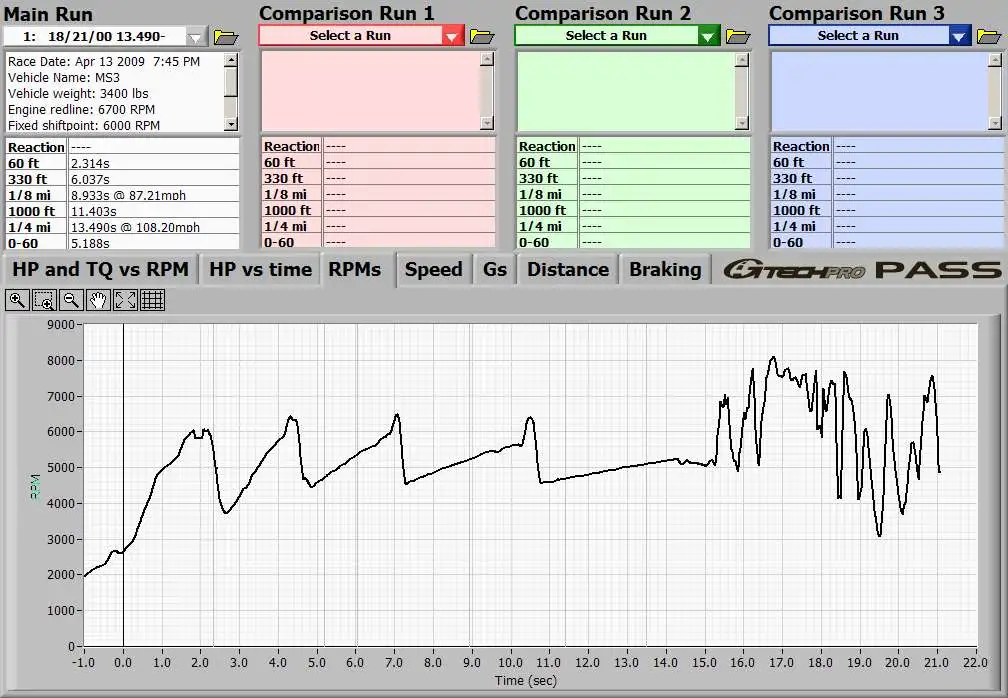

I flat shift when tracking or performance testing. I start the shift at 5,500 rpm, knowing that the reaction time will actually put the shift at about 5,800 rpm. With the go pedal flat on the floor during the shift, the rpms spike up toward redline and return. It is safe for the engine. (maybe not safe for the clutch, lol, to do this too often.
Here is what flat shifting looks like on an accelerometer chart. Disregard the far right, because electrical interference produces artifact when you let up completely on the accelerator at the end of the run. Notice the short spikes at the end of second, third and fourth gears. This is the quick run up in rpms during the shift. I've been doing this pretty frequently for two years with no problem.
That is not to say that I would recommend standing on the gas pedal in neutral just for fun. The the rev limiter is there, it's soft, it works, and it should prevent you from damaging your engine.
