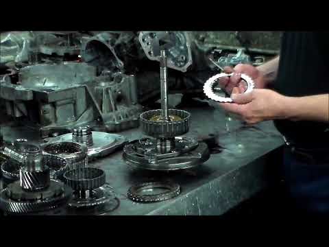

Did you take apart the TC and identify where exactly it is failing? Agree it is most likely TC but no one has been able to pinpoint the exact source (which component within the TC?) to confidently state so; I'd like to know why.

*Torque converter - internal leak/worn seal where it is not able to maintain fluid pressure/flow. Reaching out to a Youtuber that tore down an FNR5 and he suspects a leak in the strator/reactor. It does feel as though the TC has trouble unlocking. Worm clutch is a system to the problem.
