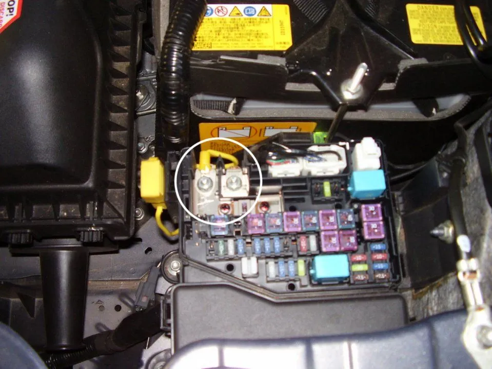

Red ACC goes to power that's only on when the key is turned to ACC.
Yellow Battery goes to constant power, typically the battery.
I don't know of a switched fuse location, so you may need to tap the main Accessory wire from the ignition switch.
The most reliable spot for constant power would be the main fuse block main terminals.

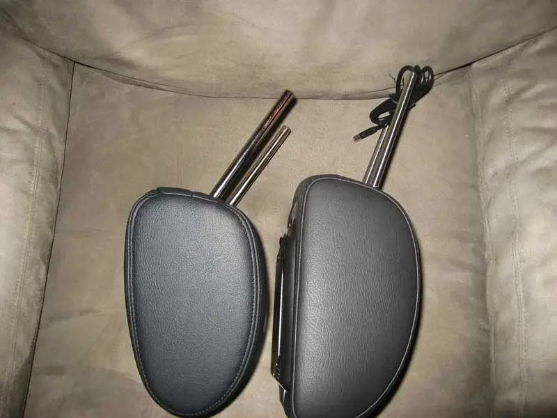

Has anybody who's installed the onfair brand in a CX-7 or CX-9 noticed that they don't tilt as far forward as the stock headrests?
This results in my head sitting 1-1.5" further back, and almost instantly creates a neck-ache. Turns the seat into more of a sleeping position than a sitting position.
The ones I just tried out were the 9" ones. Here's a pic to illustrate the difference in post angle that causes the issue. Curious if anyone else is experiencing this, or if perhaps it's just the 9" ones that have the issue.
Boy, that's gonna be bad for whiplash, coupled with the already poor rear crash test at 20mph for the CX-9 (marginal rating).

Agree. I used to have the factory headrest tilted all the way forward, but the onfair ones don't tilt as far.

Well I found my answer. The Onfair models do in fact lean back at a potentially hazardous level. In the event of sudden acceleration, or god forbid, a rear end collision, your neck will no doubt suffer damage. The travel is far more than stock.

3. The headrests leave a huge gap between the head and the headrest in comparison to the stock headrests. This seems dangerous, and of course uncomfortable if using the headrest.

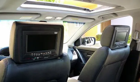

CX-9 Headrest DVD Player
They are great for the price i had a professional installation and they work great. beats spending 1200 dollars. The kids love them.
Thanks. Can you post more pics (larger and with screen on)? Some more questions:
- Does the screen tilt up/down?
- Can you have the same DVD play on both screen simultaneously?
- How would you describe the quality of the screen? what is the resolution?
