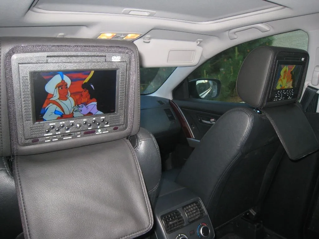

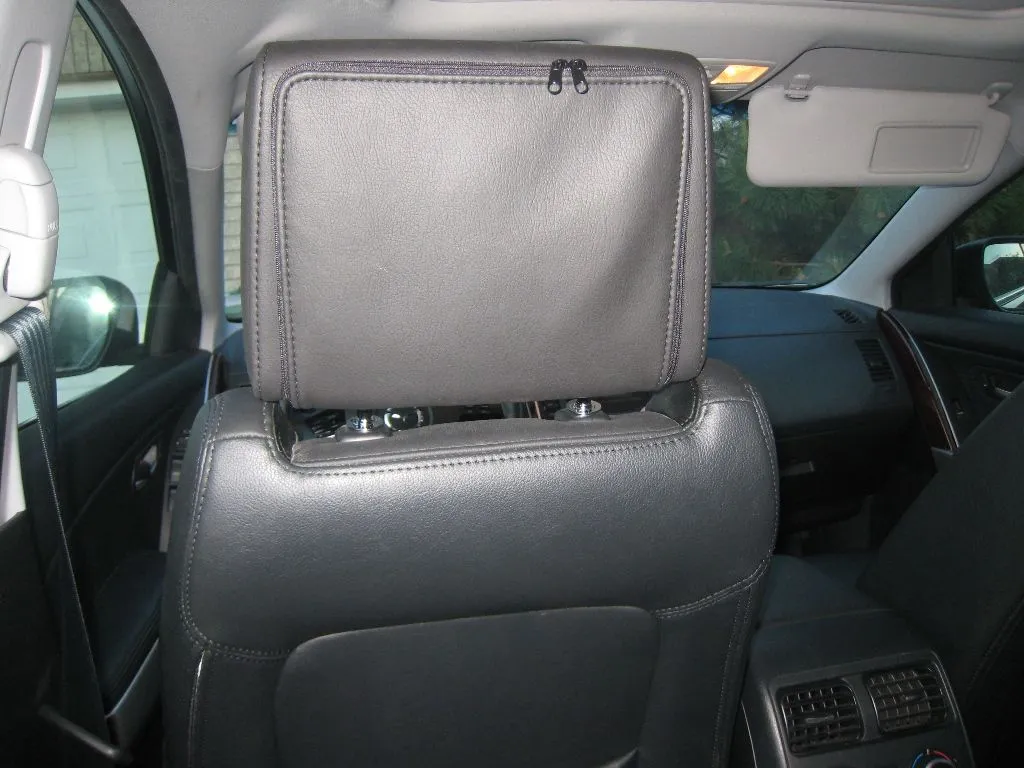

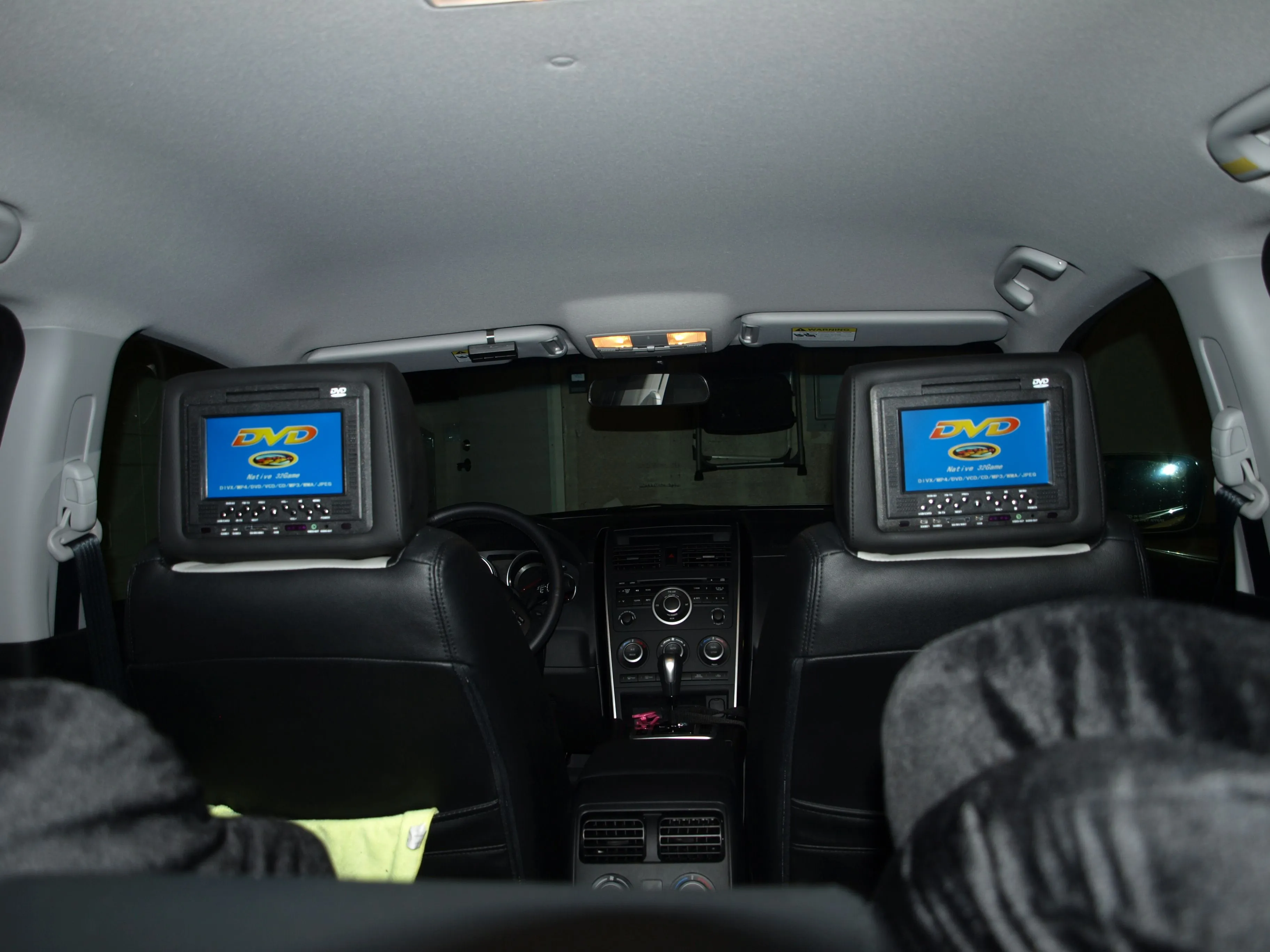

OK, so I did manage to get the Headrest DVDs installed over the weekend. Took me about 2-3 hours to get it all done. I ended up attaching the ground cables to a screw of the metal bracket at the bottom of the center console. I originally thought I could plug the fuse tap into an empty slot in the fuse box, but the empty ones do not appear to be wired, so I used the one for the side mirrors (the tap allows for the mirrors to still work and provides power to the DVDs), and it works like a charm. (cool)
A big thanks to trey169 and CX9 SportsOwner for the insights and instructions on how to do this!! (rei)
Some pics to show you the end result.

God I have to get me some of these. I like how you can zip them up and hide them. Do most of these that are built-in to the headrest have some way to cover them up?
