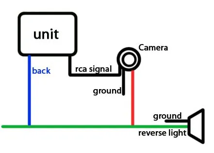

reviving an old thread here, but im trying to figure out this reverse camera.
i have the supplied power cables wired into the revers lights so that when they turn on the camera does too. i know the camera works and powers up when reverse lights are on because i tested in on a different monitor. but when i plug the video cable into the car advanced HU i get no rear camera. i thought this was just a plug and play deal, what am i doing wrong?
haven't been on here in a while....hope this helps

thanks, i figured it out and used the same power source as the camera, now the image pops up whenever i put it in reverse.
