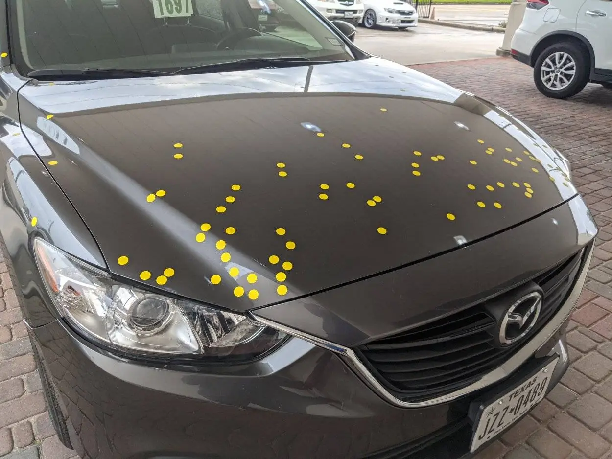

guys, the issues with Soul Crystal Red and to a lesser extent, Machine Grey, are absolutely NOT caused by 'chipping' from rocks, etc. It is a problem with the paints/primer used and the painting process. The paint flaking tends to cluster in areas of direct airflow. My machine grey Mazda 6 had almost 200 flakes/chips on it when Mazda repainted it under warranty. But because they didn't strip it down to the metal and remove the primer, the flakes are coming back.
I don't know if there is any rhyme or reason to which vehicles this happens to, but it does seem to be happening less now

Notice that there were no flakes on the plastic bumper cover. If it were road debris, it would have been hitting the bumper area too. I work at a Mazda dealer and the general consensus is that it's a primer issue
