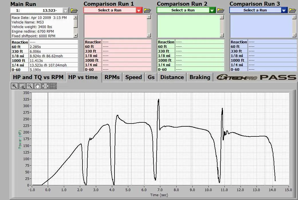

So I'm doing 0-60 in 5.1 seconds, 13.4 sec. (best) typical 13.5 second quarters at 106-107, 0-100 in 11.5 seconds. This is on stock tires, stock tune. What am I missing in my BPV?
Here's some data logging on hp v. time. Sharp short vertical lines are artifact and should be disregarded. Note how ECU holds back power in first and second, and note how aerodynamic drag pulls down power in higher gears.
My point is that in third, before drag takes over, the engine immediately hits its hp peak of about 265 whp just as soon as the shift is completed.

When I had my stock BPV in, I never saw more than 13.2-13.5 lbs of boost on the Dashhawk. Slapped a Forge in its place, and I now spike to 16+ on occasion, and see 15 lbs all the time. Guessing my stocker was leaky or something.
