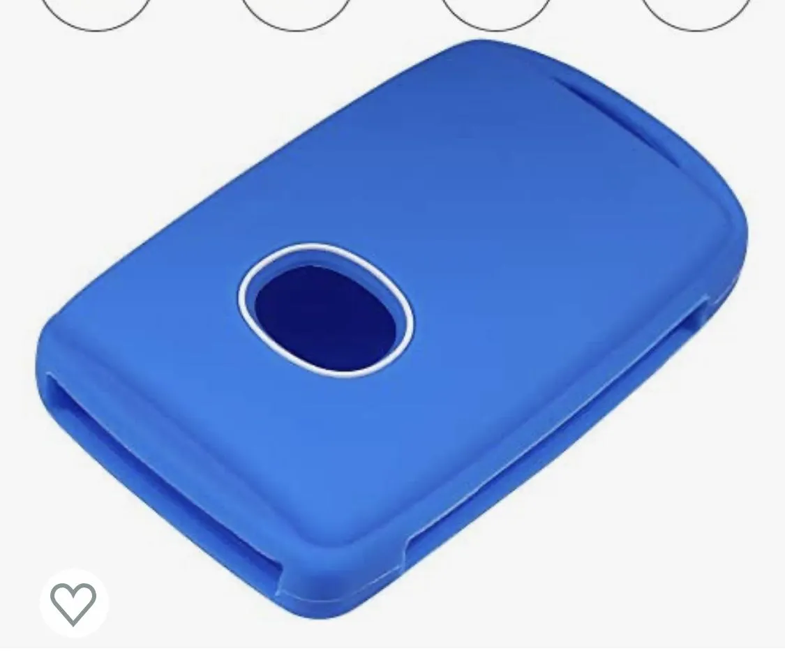

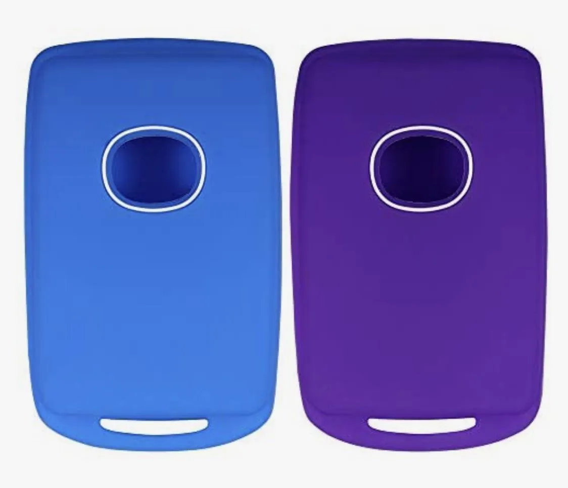

I have a 2021 Mazda cx5. My rear lift gate has come open by itself 6-7 times. I don’t believe the problem is as simple as sensitive key fob. I even bought a fob cover which didn’t help.
