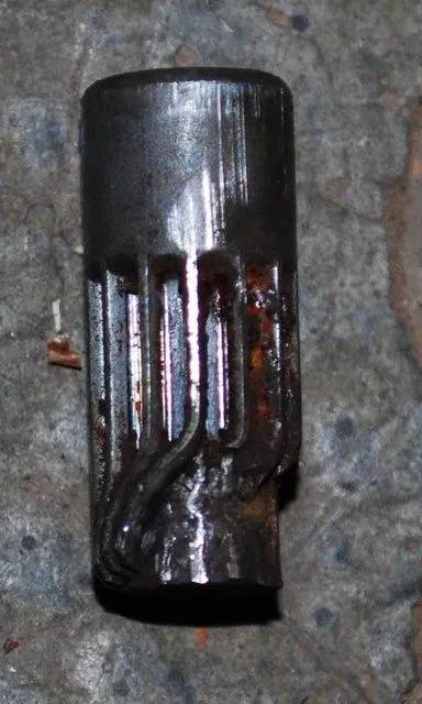

I have a similar situation with a driver rear caliper seized.
I removed the parking break clip, the screw plug and the lock bolt. I used a 4mm allen to try to decompress the piston, and while the gear moved (and stopped), when it came out, it was mangled.
I have the caliper all the way off now, and I can move the piston as if I were applying the break, but when I try to depress it, it only goes a few mm and then seems to click to a stop. I don't want to force it because it feels like something is definitely holding it where it stops.
Any advice? I'm going to (try to) take it to a local place, but my hopes are not high for a fix vs. replace.

Oh man, that doesn't look pretty!
