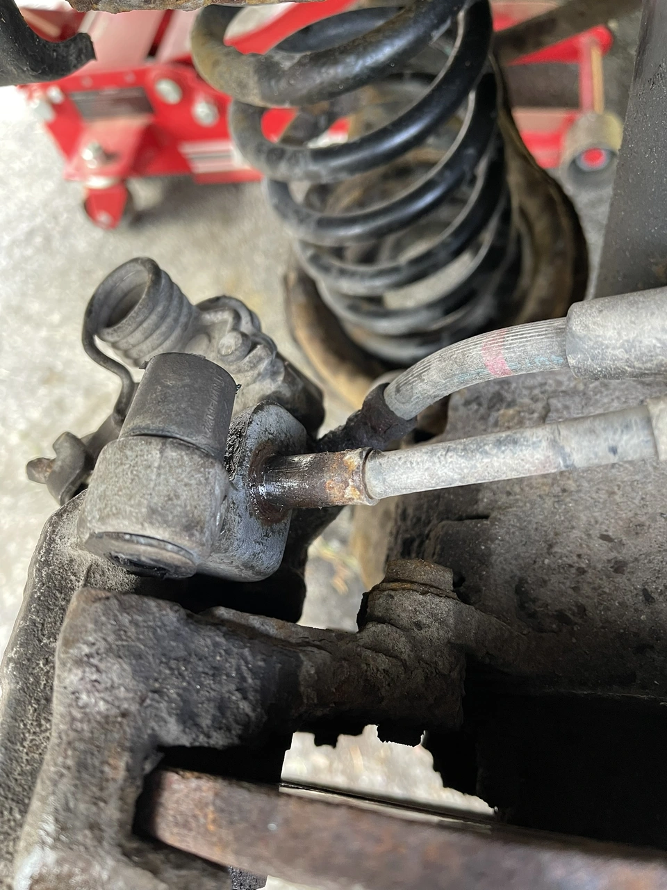

@Silentnoise713, here's the photo:
Online some people suggest punching from other side with a 10/11mm deep socket.
Did you take a pic of the 'other' end?
What I'd try before taking it to a grinder..
Remove caliper and rest it on a solid surface. Remove (replace) the slider pin boot. Hold the exposed sleeve with joint plyers with pressure in the opposite direction as you whack the mount with a few good hard hits. In reverse, I would hold the caliper body and "lightly" tap the metal sleeve in circular motion. The goal is hope to create some micro factures for the oil to work. Apply penetrating oil all around and leave it in vertical position where the flare end is facing down. Might take a little patience. You know grinding it out works and replacing hand brake line is not difficult -but the cost of the line might be more than a caliper!
