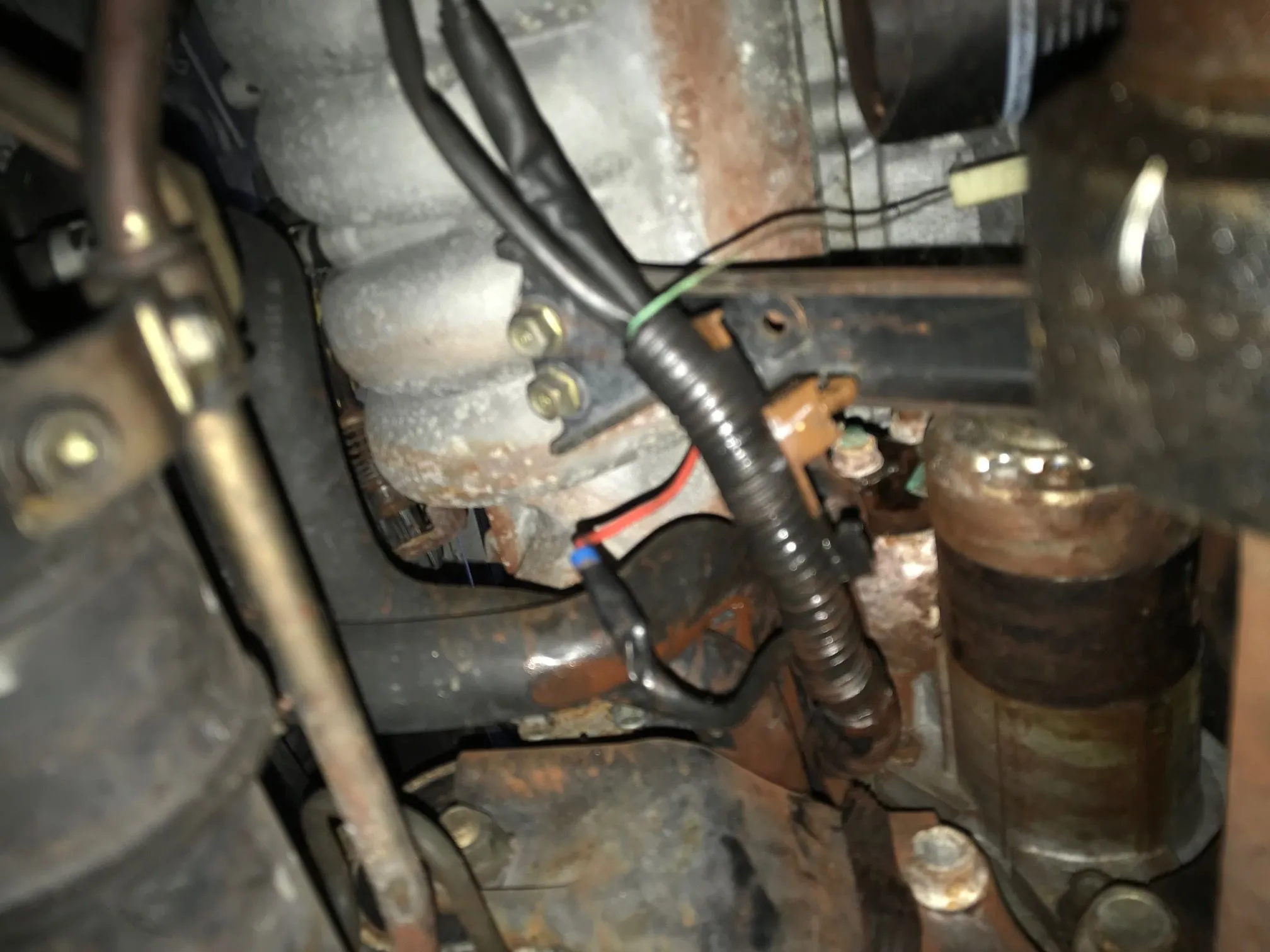

several years ago, I had the starter replaced at a local shop. when they did so, they had cut the main power cable from the battery to put a new connector on it attached at starter. unfortunately, the first starter they got was for an auto (I guess they are different... ?) anyways, so when they got the correct starter in, the mechanic found he had cut the battery cable too short to accommodate the other starter. so he put a short strip of line to reach the starter.
sound like a mashup ? it is/was....
here is a picture of what this idiot did.
so I wonder how this guy expected this "repair" to handle 500amps ?
the entire time, this has been backfeeding my electrical. it probably explains how I could blow a cell from a gel battery and 2 standard batteries, all in less than 3 yrs time. including a battery I got just after my last post in this thread. which thankfully they just swapped with no pro-rate.
it also explains the blown fuses (about a dozen now) a few relays and 4 pairs of blown headlight bulbs.

I got a new cable but its been raining all day and this is my first day off from work. if its not raining tomorrow Im hoping to be able to swap it around.
this should clear up a lot of the issues Im having, but I still may need a new starter.

I was having a hard time seeing how that little piece of wire could cause all those problems, thinking it would just add a bit of resistance to the circuit and maybe make the starter motor weak.
But if that's coupled with a bad connection with some sparking and arcing going on then I can see the back feeding happening.
It looks like he just crimped the wires together with a butt connector too.
Either way, I hope this is your last problem and your car is up and running again.

ok, so we replaced the cable, and it cranked right up !!
even after sitting for almost a year she just purred right along !
we also found that his "fix" caused a lot of corrosion in the cable (only way it could happen according to my mechanic) so the weak connection + the corrosion at the starter terminal that extended a good 12 inches up the cord is why I was getting so much back feed.
