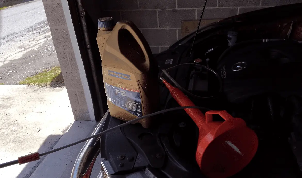

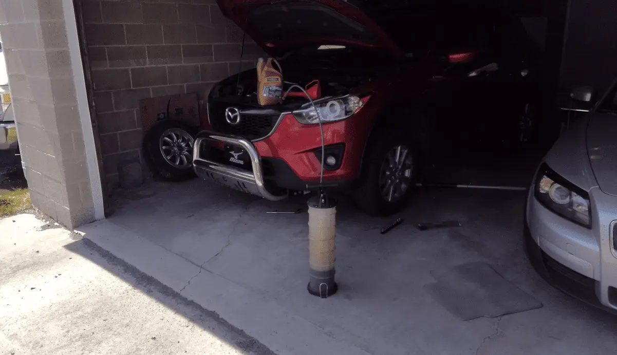

I just used the Ravenol FZ fluid, did two drain and refills with the extractor method, plan on a third next weekend.
So far the shifts are great, and I like that it is full synthetic, I could never find out with certainty if the Mazda OEM fluid is synthetic or not, most likely semi-syn at best.

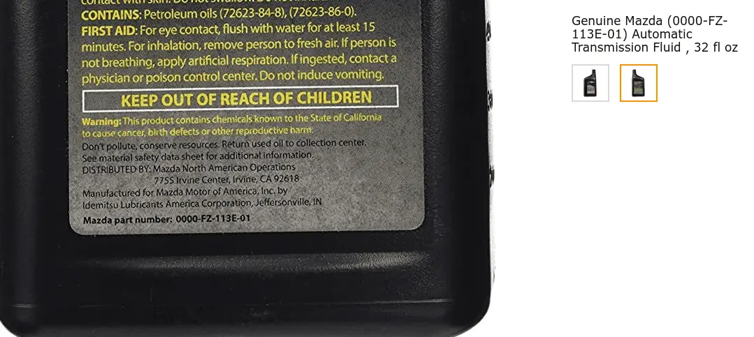

I agree, I saw somewhere that Ravenol is OEM fluid as well, however I looked at the OEM stuff on Amazon and it's clearly idemitsu lubricants america, at least that's what is avaliable at the dealers and various online stores in North America.
Perhaps they have a different supplier at the factory in Hiroshima and other countries around the world. The OEM is Petroleum vs Full Synthetic for the Ravenol, I noticed when changing fluids that the Ravenol has a much stronger odor than OEM FZ, probably due to the add pack and esters or PAO in the formulation.
