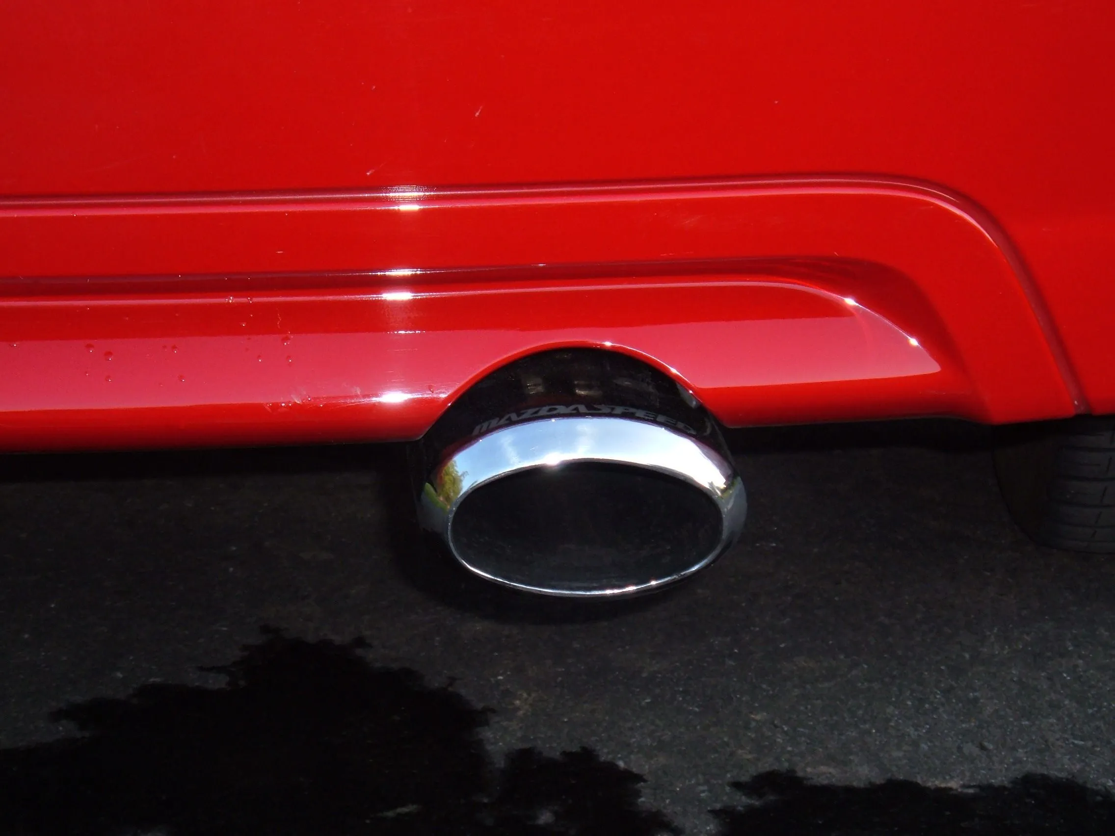

The aftermarket exhaust has the rolled tip while the 03 MSP is round and th 03.5 is oval (which I have).

have any pics or your tip?
Yup...however as theman has clarified this will not bolt up to the existing aftermarket piping. Guess a call to RB is in order, maybe they'll work with you?

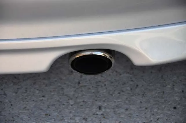

can i get some bumper and exhaust tip pics? I got ahold of racing beat, turns out that I likely have the correct muffler. Based on racing beats pics and dimensions they gave me, I have the one for the sedan. They are trying to figure out why its coming up short on the bumper. Tip should be like another inch longer. I didnt have any issues with the stock racing beat or corksport when i had it on
do you have a rear lip on the bumper? Cause Jeg's car with the stock exhaust is about an inch behind his rear lip
I got the final word from racing beat. Turns out its coming up short because of the bumper lip and that it wasnt designed for the mp3. They just recommended that I get the tip extended
so why does it look fine on my car?
Good question. Racing beat cat back with bumper lip. Is your muffler tip pretty much flush with the lip? My tip should be 1"-1 1/4" longer to be flush.
depends on how you look at it... the top of it is about 3/4" from the lip.. bottom of lip to the tip is about 1-1/4"
