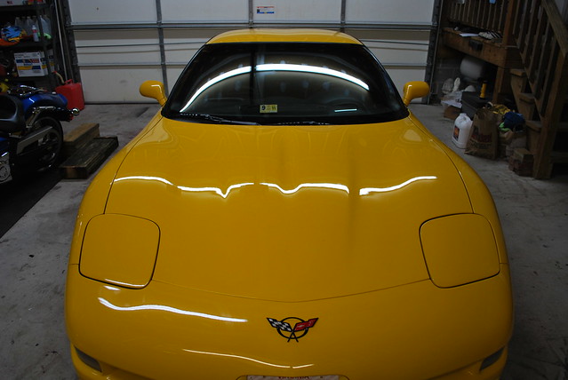

Friday afternoon I removed the rear spoiler and the side trims on the door. Friday evening I washed and clayed the car. I then cleaned the engine bay with some simple green. that stuff worked great and now the engine bay looks brand new. I then followed up with ziano paint cleaner, and swirl removal. I put on 2 coats of ziano polish followed with the paint sealer. Came back with with the gloss enhancer and followed with another coat of sealer last night. I also went ahead and repainted those side air ducts since the black was chipping off from rocks.

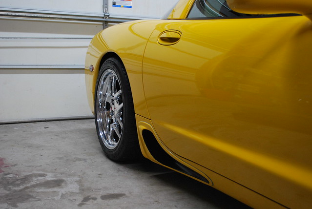

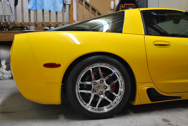

I went ahead and seafoamed the car this morning. It was a 10 minute smoke storm! I must have smoked the entire street. Overall the motor is a lot more responsive. I changed the oil out to Amsoil 5w-30. Also got the front and rear lowering bolts in. and to my surprise I have Bilstein shocks! I got in the fronts after a lot of cusing. I set them to the lowest setting which only gave me a 1.25" drop in the front. I have no idea how others are dropping the fronts anymore than mine since now my bolts are resting on the control arm. The rears were piece of cake. I did a 2" drop. Leveled out the car since the rear sits up so high. I still had another inch of drop to play with in the rear. And can raise it an inch higher at the fullest setting. But this is a nice drop. Should be fine for everyday driving. Though I do only have 4.5" of ground clearance under the car.

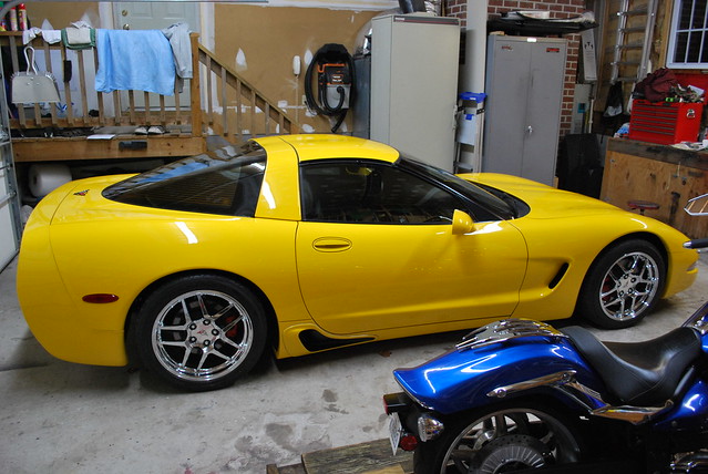

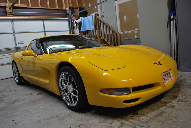

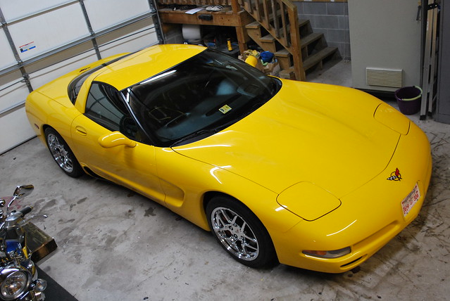

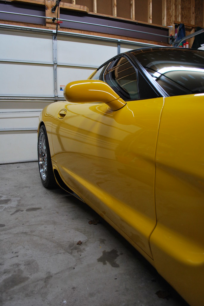

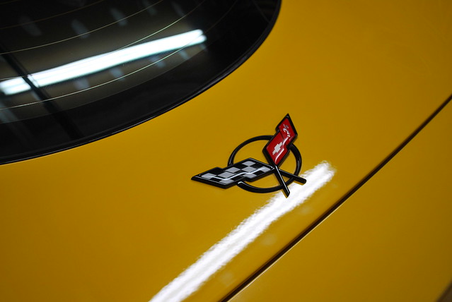

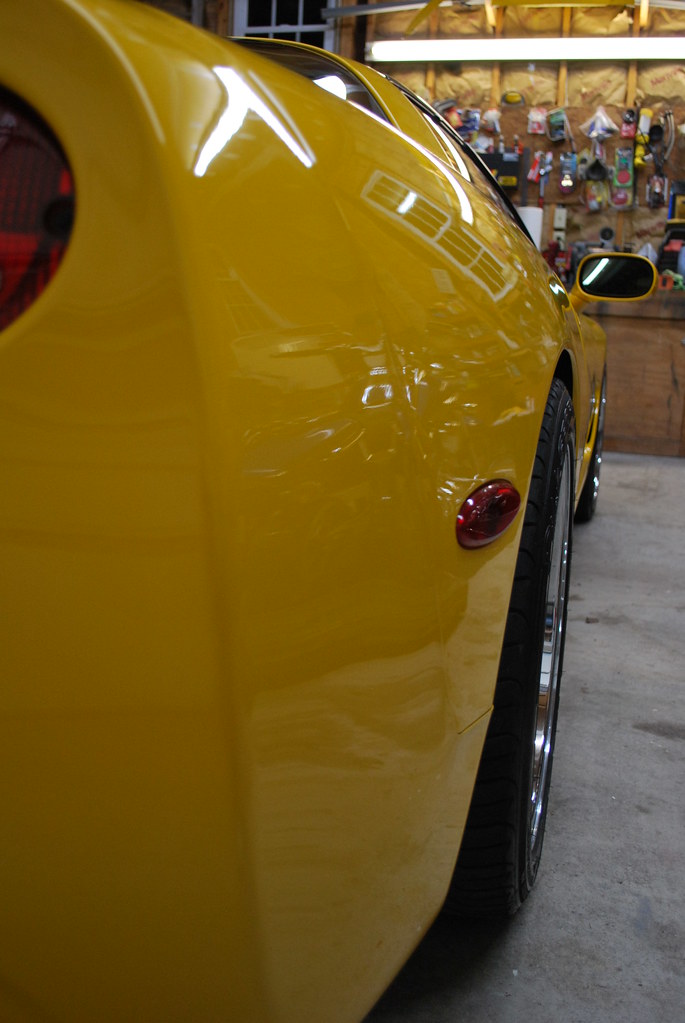

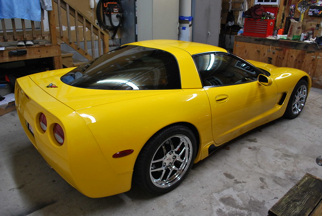

Here are some new pics of the new look. I decided to keep the wheels chrome. I also love the clean look without that banana spoiler or that door trim.
Wow, the car looks MUCH cleaner with the sides gone and the spoiler and lip removed. The stance looks mean now too.
One thing I've always liked with the C5/C6 is when they paint the roof and B-pillar trim black and leave the rest body color, since some of the trim is already black and it flows really well.
Did that new rear bumper come with new tails as well, or did I just not notice them before?
Thanks dudes. The tails were there when I got it. They are euro spec tails. Instead of lighting red with the turn signal they light amber.
I still hope the front end drops another half inch. They say you need to drive it for a few days for the suspension to settle then go for an alignment. So maybe there is some more drop to be had in the front. As soon as the weather is dry I will take it out the garage and go for a ride. Hopefully ride comfort wasnt too sacrificed. but I need to get some rear shots. It looks so mean from the rear and side now since the stance is a lot lower. It really completes the look of the car and gets rid of the 4x4.
This car is getting one hell of a good turnaround. I just scrolled through the initial pics and recent ones and it's a huge step in the right direction IMO.
Thanks guys! No pics with me and my dads yet. We need to take some together. He helped me out a lot on the lowering kit. I was ready to give up and he stepped in and helped. He then asked me how much the kit was as if he was interested in lowering his now too. I am pretty much done exterior wise. May go with some led tails and a couple little things. then I am going to the interior. the engine bay I will just leave like it is with the exception of some painted fuel rail covers.
