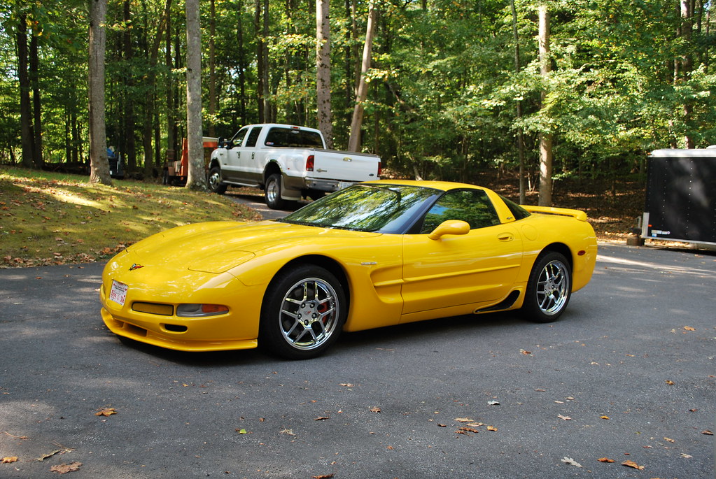

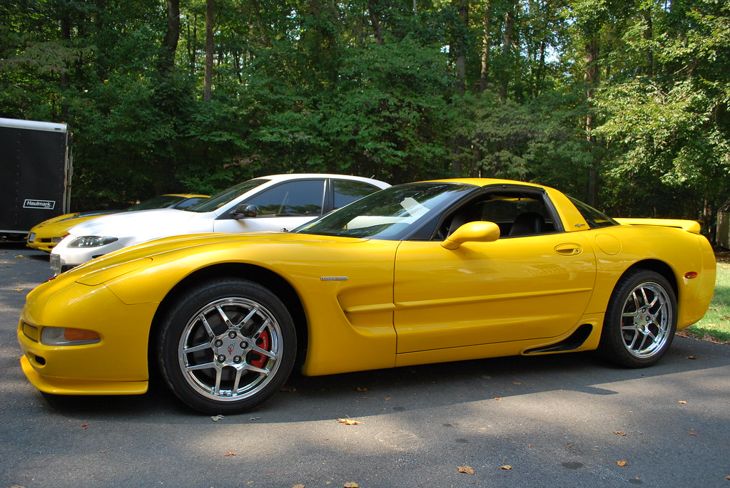

Sorry guys. The time has come for me to leave this platform. I have been wanting a V8 for a little while now. I have always loved the vettes. I came across one last saturday and had to have it. So far I love it. It is completely different than driving the speed6 daily. And in a good way. Mine has it's quirks than need to be worked out but nothing too major. Here are the pics thus far! (nana)
Specs: 2001 Corvette (6-speed) 5.7L LS1
Mods:
-Headers
-Cam & Head work

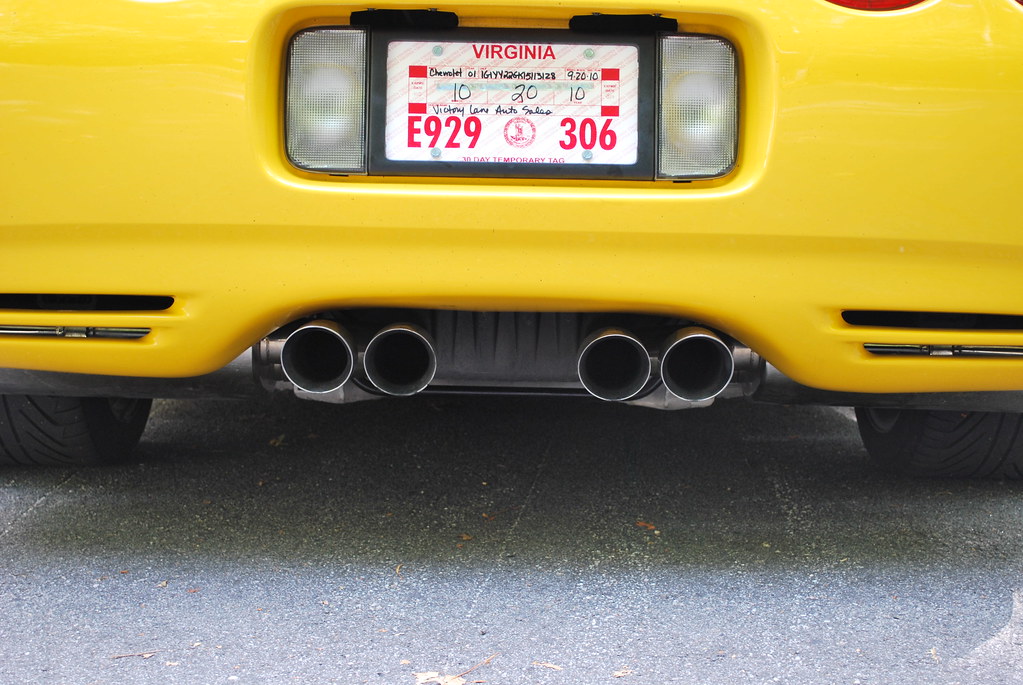

-Full exhaust
-Twin Cold Air Intake (not in pictures)

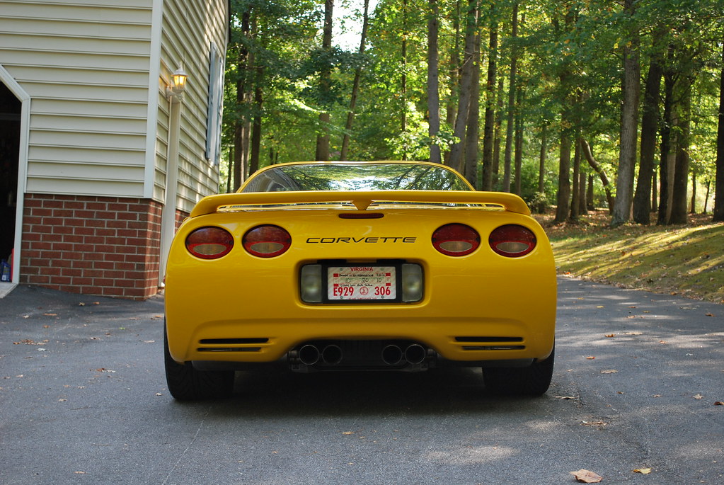

-Euro Tail Lights
-C5 ZO6 Wheels
Planned Mods:
-Lowering bolts (2" Drop)
-Front Lip Delete
-Debadge (so no one will know what kind of car it is . . . )
-Powder coat these ZO6 wheel a semi gloss black
-Fresh tires. Maybe a little something wider in the rear.
-Get this baby fine tuned
-AFR Gauge
-Dash kit for aftermarket head unit
-New stereo

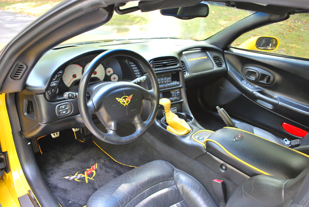

-Different gauge faces
-New door sill gaurds
-New console cover
-Possibly new seat covers
-LED Tails
-Flush mount rear spoiler
-Rear bumper black out exhaust surround
-Smoked front parking lights
It has been a great 4 years guys. I'm gonna miss this community. Now I can go be a noob on the vette forums. I should be having my car up for sale here very soon. So please someone buy my baby! I hate to get rid of her but I cannot afford insurance on both. She has been great and never had any major issues. I got it exactly how I wanted and now it's time to move on.

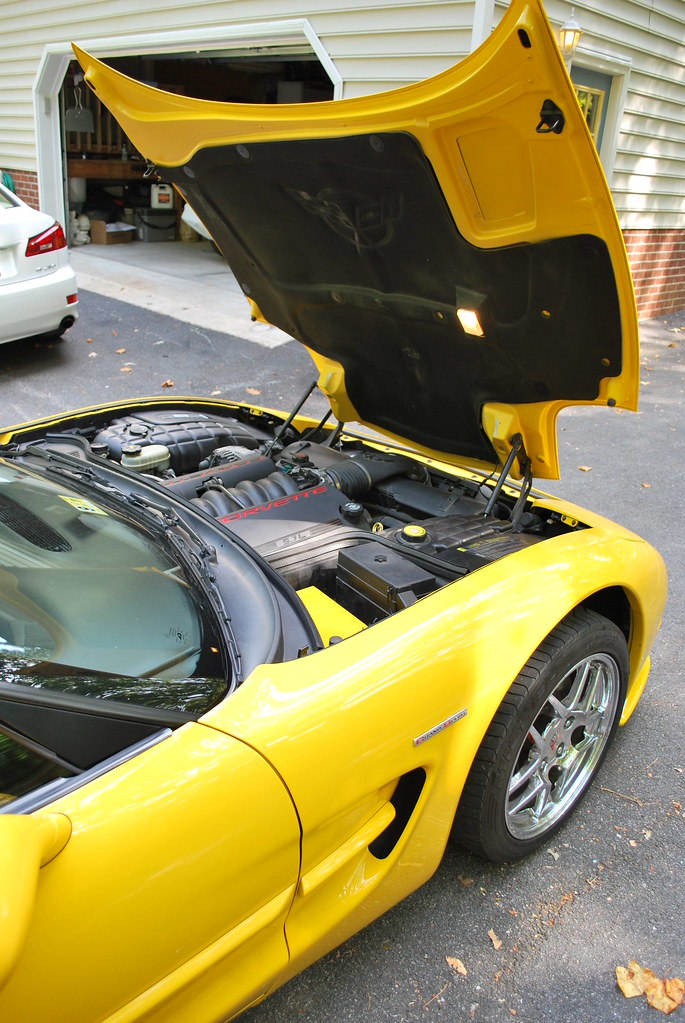

Thanks guys. I am taking it back to the dealer tomorrow morning so they can change the thermostat ad change the coolant. It gets up to 235 cruising at 55 and can get up past 250 at idle.

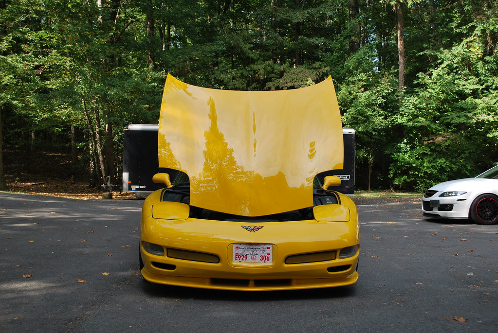

I tried to drive the car up on bricks today but it kept just pushing them. It looks like that front lip is bolted to the stock bumper. The bumper might have to come off if there is a nut on the other side of that bolt. As for the rear spoiler I am not sure. It is probably bolted on too. I will have to get the flush mount spoiler to cover those holes up.

good trade bro. car looks good. but i see one thing that bothers me, those side vent back by the door. look like they are stuck on to try to look like a Z06. am i right? if not, my bad, but for some reason they dont look right. just my opinion tho of course.
other wise, i cant wait to see the updates on this beast. kudos and good luck
Thanks! According to the seller when this car was new it was originally in florida. The guy who bought it did the motor work on the heads and cam. He also did the side vents and it was before they sold the actual zo6 kit for the vents. They are functional however. I may just get zo6 side sills but I am not sure how that will work out. They do need to be repainted. I will see if I can get a guy I know who does paint and body work to fill them in and make them look right. I have yet to see these on another vette. The zo6 has a smaller opening.

I removed the front lip yesterday. Much easier than I thought. I found the reason as to why I am over heating. The lip on the underside of the car that diverts air up to the radiator. Well the panel that seperates the air intake side from the radiator had 3 screws missing so it was just hanging. It was blocking a lot of air from getting to the radiator and putting it to the intake side instead. After I got those 3 screws back in I took it for a drive. Where before I was at 200-235 degrees at cruise it is now a steady 190. If I let it sit and idle for a bit it may creep up to 198. To think I was about to go in the shop for a thermostat. hehe.
