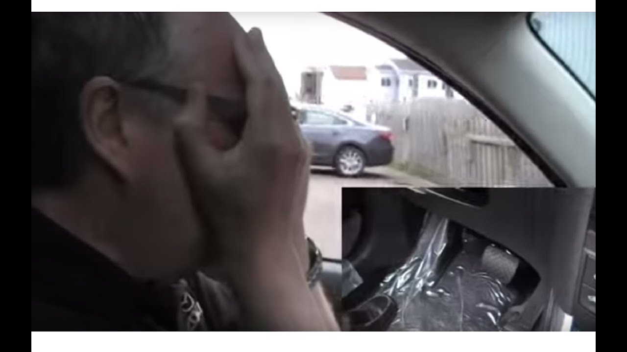

The object absolutely does not have to be metal.
Mine triggered on a brick wall.
2014 CX5 auto-stopped in front of wood fence by SCBS.
But you guys really want to suggest people using brick wall and wood fence to test the SCBS? 😛
I don't suggest testing it at all.
But what were you suggesting, Yrwie? Metal? Another car?
That was in response to your "metal only" comments. ;)
That’s my recollection during the discussion here in early days that the reason why the much safer paper box test doesn’t work on SCBS. And SCBS documents provided by Mazda at the time did say the SCBS won’t prevent the actual collision, but can only reduce the damage during the collision due to slower car speed. And the system designed is mainly to detect vehicles in front of you (metal), not for other objects such as pedestrians. I have doubt on that particular video, as the CX-5 seems to be stopped too soon, which is on the contrary to many other videos I’ve seen.
Here are a couple of videos testing SCBS or similar safety systems:
