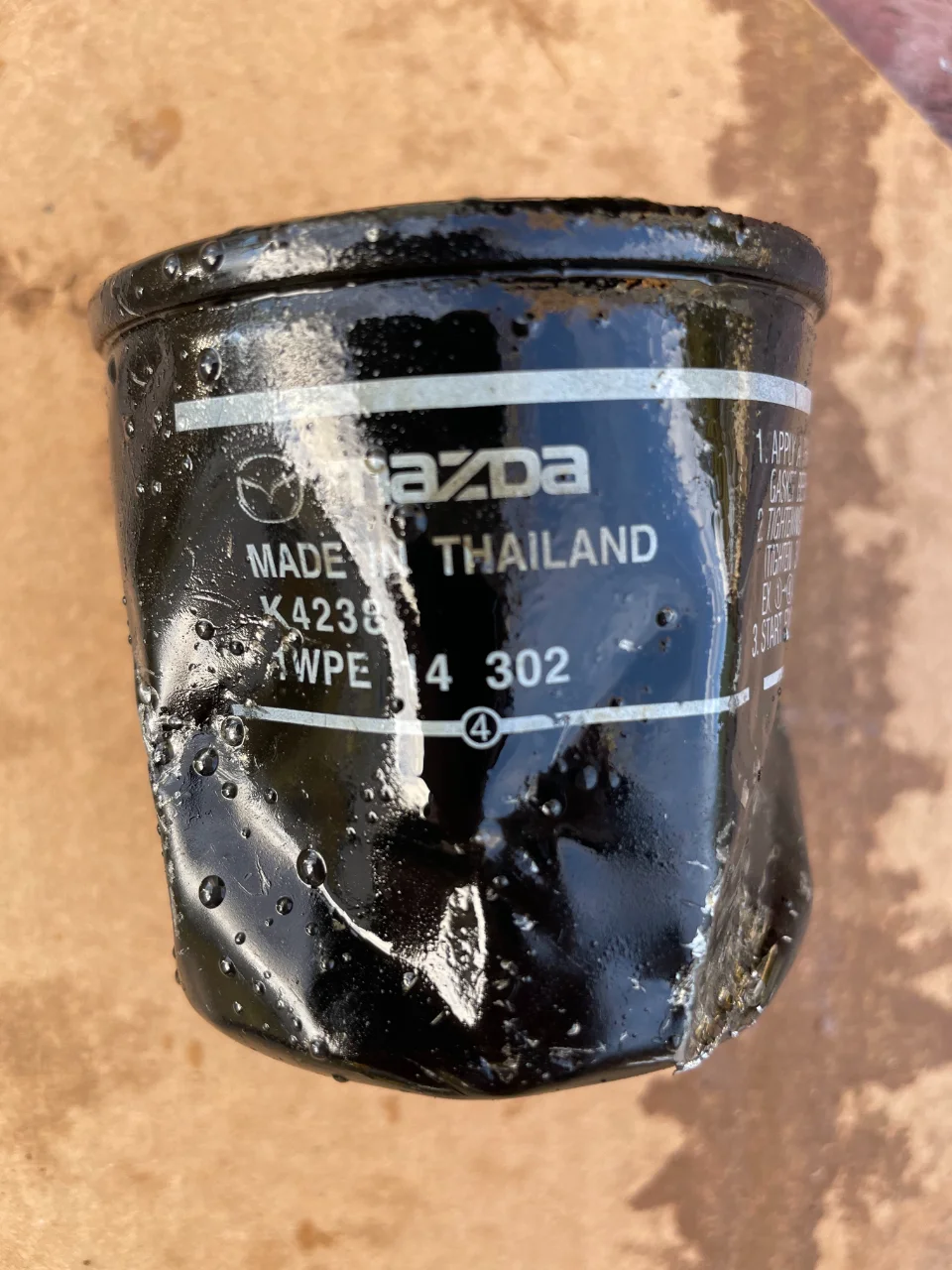

While I had it on the ramps I did an oil change which became an adventure, the last oil change was at the dealer by the cleaning person and I suspect the filter gasket wasn't given the film of oil resulting in destruction of the filter to get it off, not impressed. After refilling, following the filter adventure, with 4.73 L of M1 plus filter oiled and tightened to spec. the oil was about 1/8" below full so I guess mine has a 5 L capacity.

I found it interesting that the 1WPE filter I used over the weekend had white grease already on the ring. The 1WPY did not, so there I used motor oil.

Filters made in Thailand are usually pregreased, at least everyone I've used over the years were. No need to use oil.
