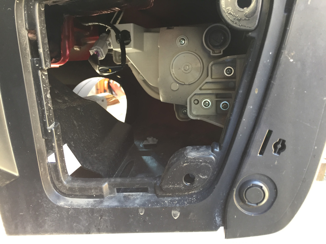

Here are two pictures. You really can't see the scratches because of all the reflections, but frankly, I don't care about having those buffered. In reality, unless you get really close, you can't see them. I figure, if we take a look at our cars, perhaps only a handful of people will have immaculate bumpers.
Yes, so if you go inside the wheel arch by the tire, there is a little door you can take off which will let you get at the fixing screws. You might be able to re fasten it - I think its just pushed through.
This is the back of the reflector from the door;
And not a one of those live in "The City"!
Well I think that there will be a lot with an immaculate bumper unless you have a very relaxed attitude about taking care when you park. I*ve just had a look at the parts catalogue and the reflector is actually very much like a lamp but with no bulb in it. I can*t give you a part number because ours has regulation *E* markings on but I can tell you it is circa $100. I*m pretty sure that one of the 3 fixing screws has just pulled out of the plastic and it should screw back in with a bit of care.
I would just try to push it back in place from the other side. It looks like there is a clip it should attach to in your second picture to the left
I believe the issue is that the part the reflector screws onto is what most commonly breaks in this situation. That part is actually part of the bumper. So a proper fix would be to replace the bumper, whereas a quicker fix would be to glue in the reflector.
A good look is what*s needed. The bumper could be off in 10 minutes and if the reflector can*t be replaced by picking up on an unbroken part, I*m sure I could hot glue some plastic in place to screw in to.
