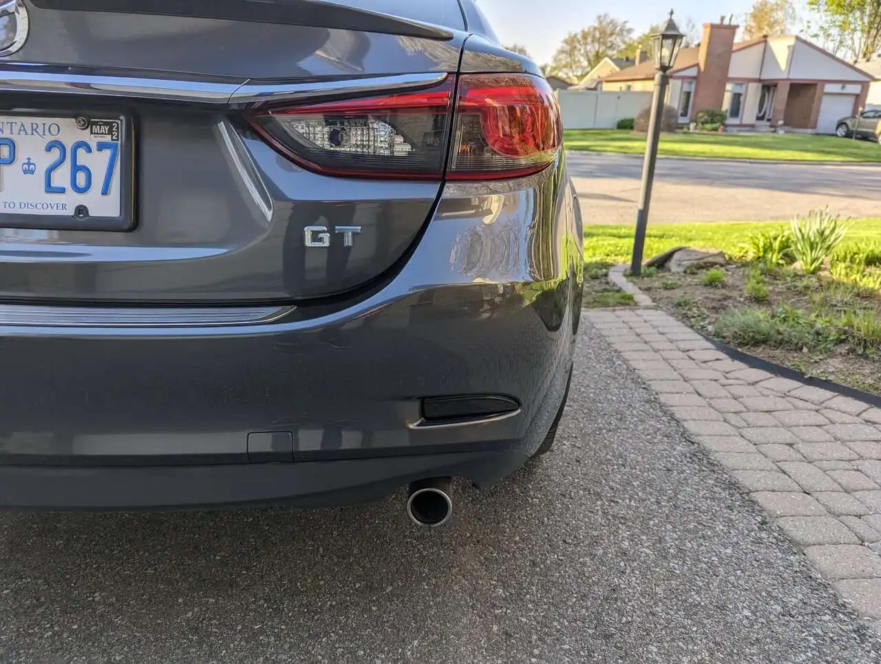

Hello everyone. I have a 2020 CX5 with the rear reflector lights on the bottom corners. WELL.... backing my car into the garage vibrated the garage walls a tad and something had fallen off of a shelf. in turn I received a pushed in reflector lens. My question is... will this "pop" back into place or is there a seal that I need to deal with? Just an FYI,,,,there are no broken parts or cracks on the lens, it's just pushed in. TIA.

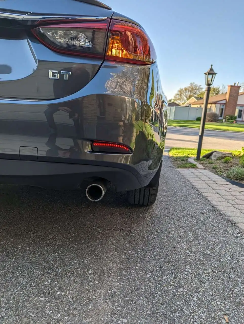

I replaced my rear bumper orange/red reflectors on my 2017 6 last year.
I installed wired black units that light up. They have the brake light and signal light leds in them.
The reflectors were held in with clips and one phillips screw. The screws were a PITA to get out.
I didn't install them in the new units. The clips are plenty strong enough.
