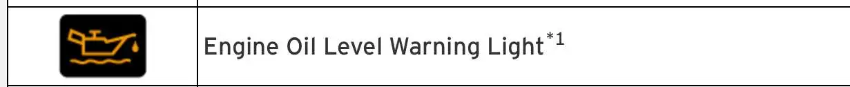

This is the light I see. Seems like for low oil level but still serious, right ?
Generally that is caused but low oil but issue might be related to this issue
Thank you. It says for the turbo charged engine. I don’t have a turbo one on my 2021 GT. Still applicable ??

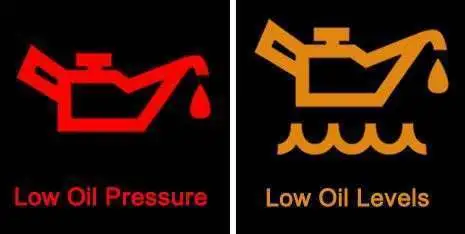

Low oil level warning light, although it isn’t a serious situation (hence it’s amber, not red like Low Oil Pressure Warning Light) that you need to stop the engine right away, but it does indicates the engine is either consuming oil from many reasons, or leaking oil from cracked cylinder head which happens sometimes on the 2.5L NA with cylinder deactivation. You can pop the hood open to check the oil level with the dipstick and see how dirty the oil is. This can tell many stories from the condition of the oil.
This 2021 CX5 GT with 34,800 miles shouldn’t have either of above warning lights on, or it simply means the engine is having problems that you don’t want to deal with even if the car still has some warranty.

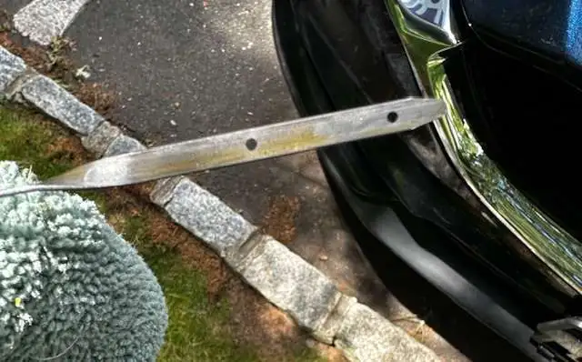

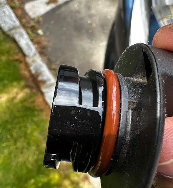

Drove around 30 miles today, no ‘low oil level’ light. It just came once yesterday for few minutes. Checked the oil level today. It looks like it is in the max-min range. Please see attached the pictures of the dip stick and the refill oil cap.
The car runs great but the oil level light that came yesterday for few minutes is bothering me. If it comes again within the next 5 days, I am 100% sure I will be returning it. If it does not come up then what you all suggest after the dip stick check ? get it checked with mazda dealer or don't bother and just return it to Carvana ?
