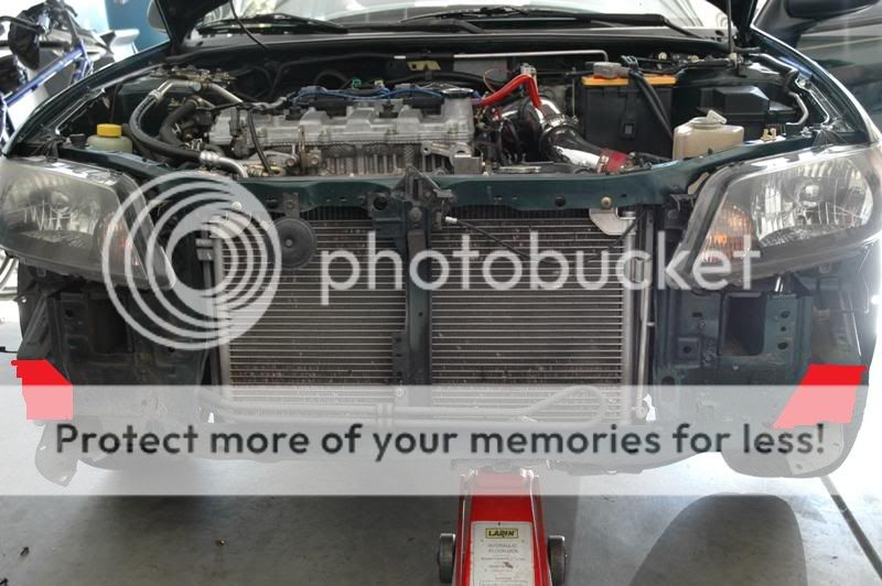

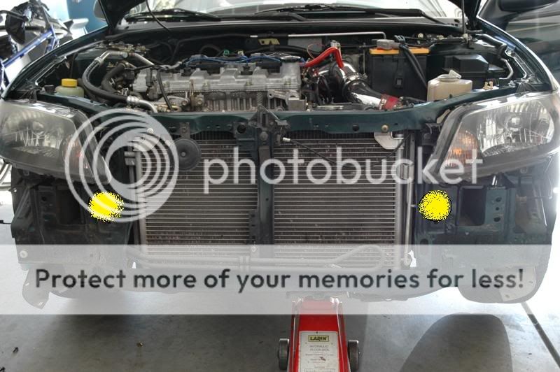

so today i took the front bumper off to take some measurements and check some stuff, and i dont really see anywhere to run 2.5" fmic piping.. can someone help me out?
heres how i did mine..made for some short piping
damn man, ur really comin along! lol
just saying, but when you doo the install do it live. its really interesting to watch![]()
it might fit, but if you're running a front mount, the smaller the better, you'll spool a lot faster and you're not going to get heat soak even if it's the smaller first option you stated.
how much boost are you planning on running with?
because unless you are going to be over 10psi, like i said, the smaller will be just fine.
i'd guess that the shorter the piping, the better, quicker spooling.
u cant put the holes up that high because the crash bar...i had to notch my bar for the pipes to even go in the holes i made
but you dont have the factory crash bar do you?
