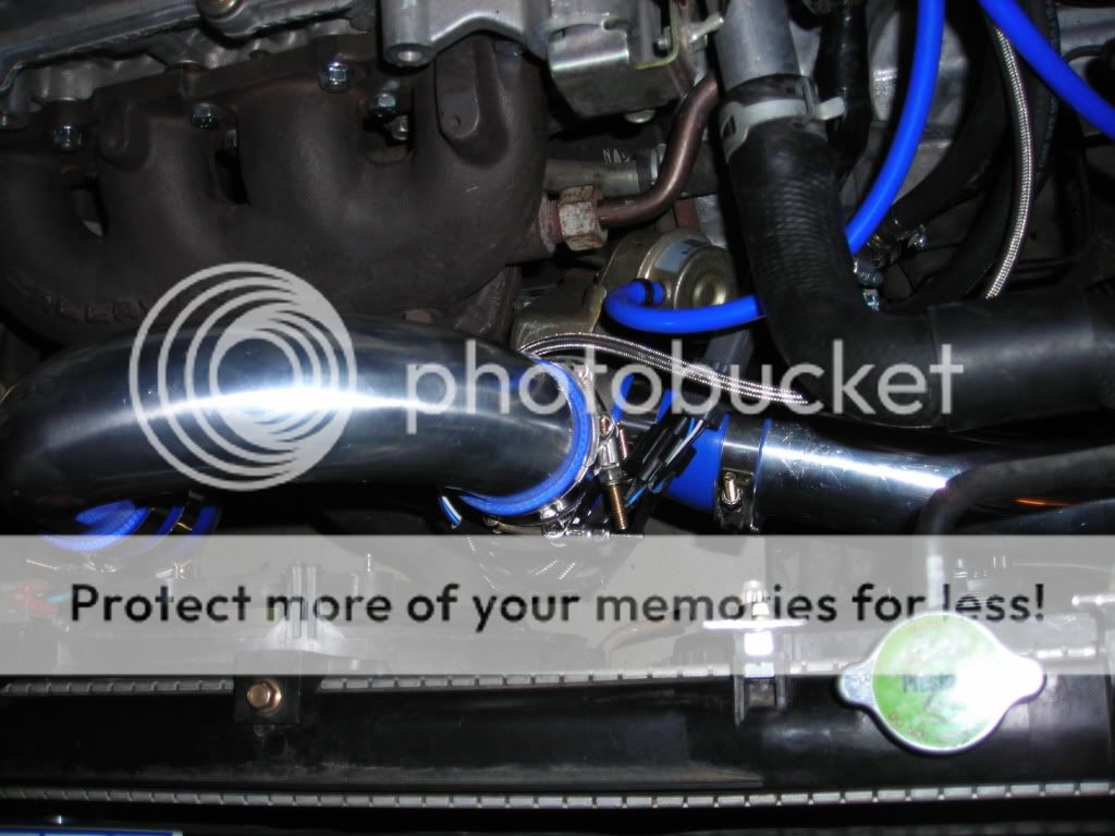

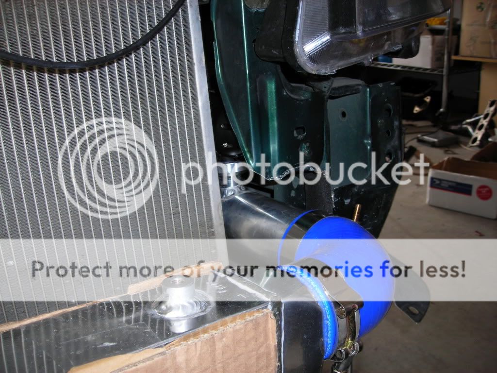

That last piece of the hot pipe is gonna have to be trimmed, thats way high lol. Lookin great dude

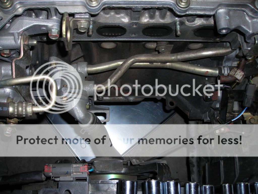

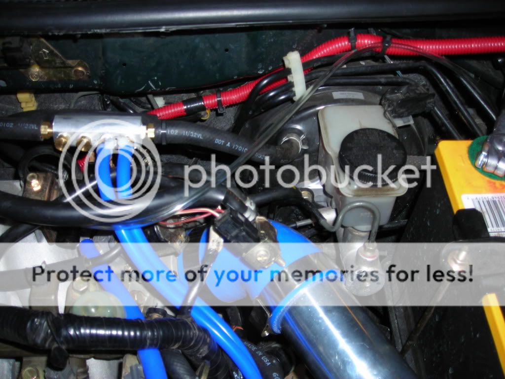

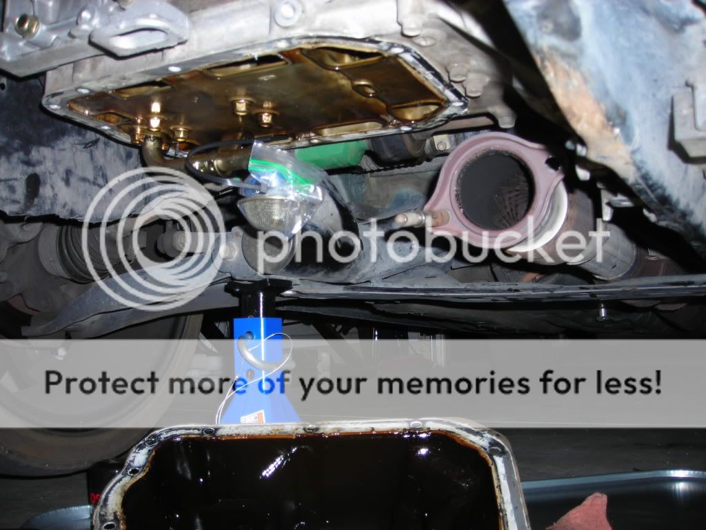

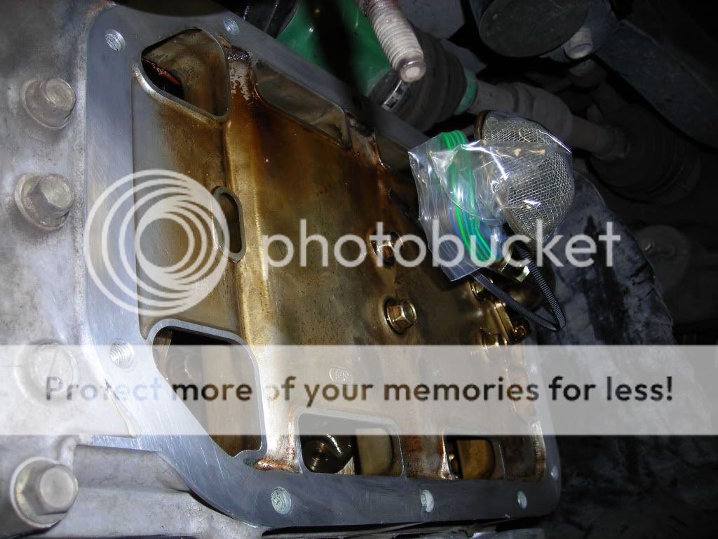

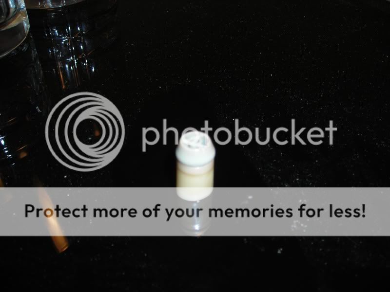

this came out of the brake booster..
what is it, and should i put it in somewhere along with the vacuum block?

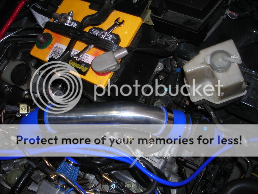

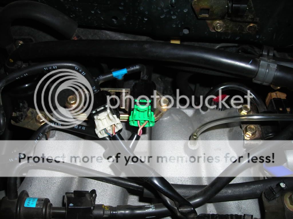

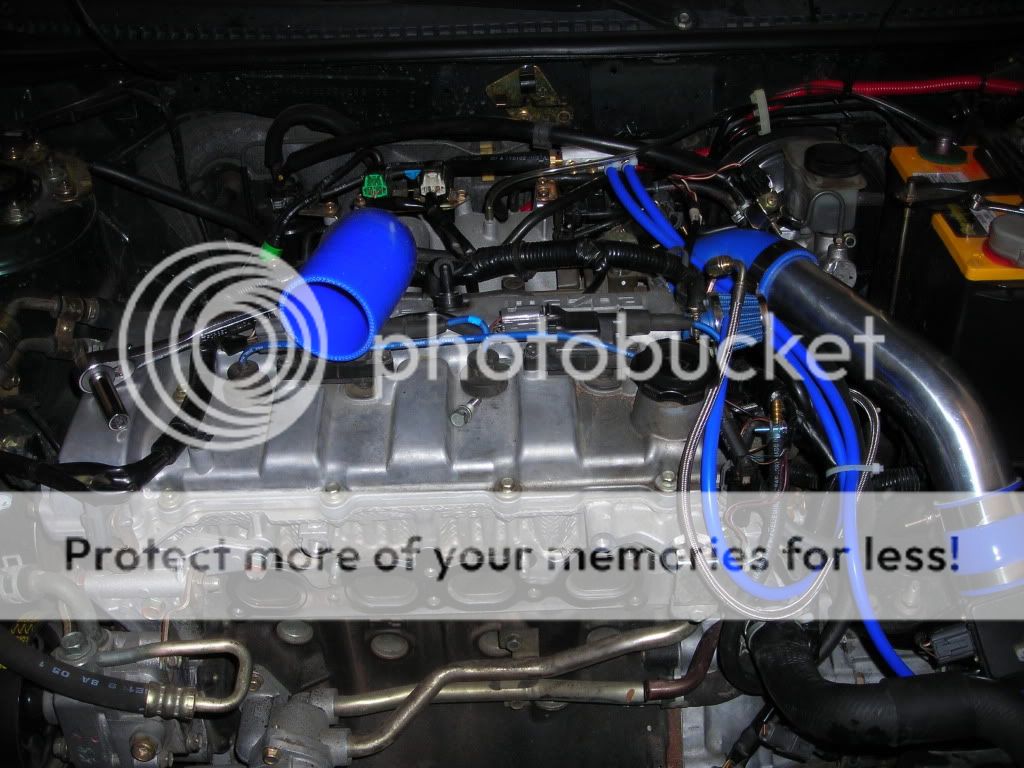

i will also mention that the picture with the connections on the IM is pointing out that i had to switch the VIC with the VTCS connection because the vacuum nipple broke off the VICS and was leaking therefor not opening it properly i assumed, i figured this work work because the VTCS are removed.

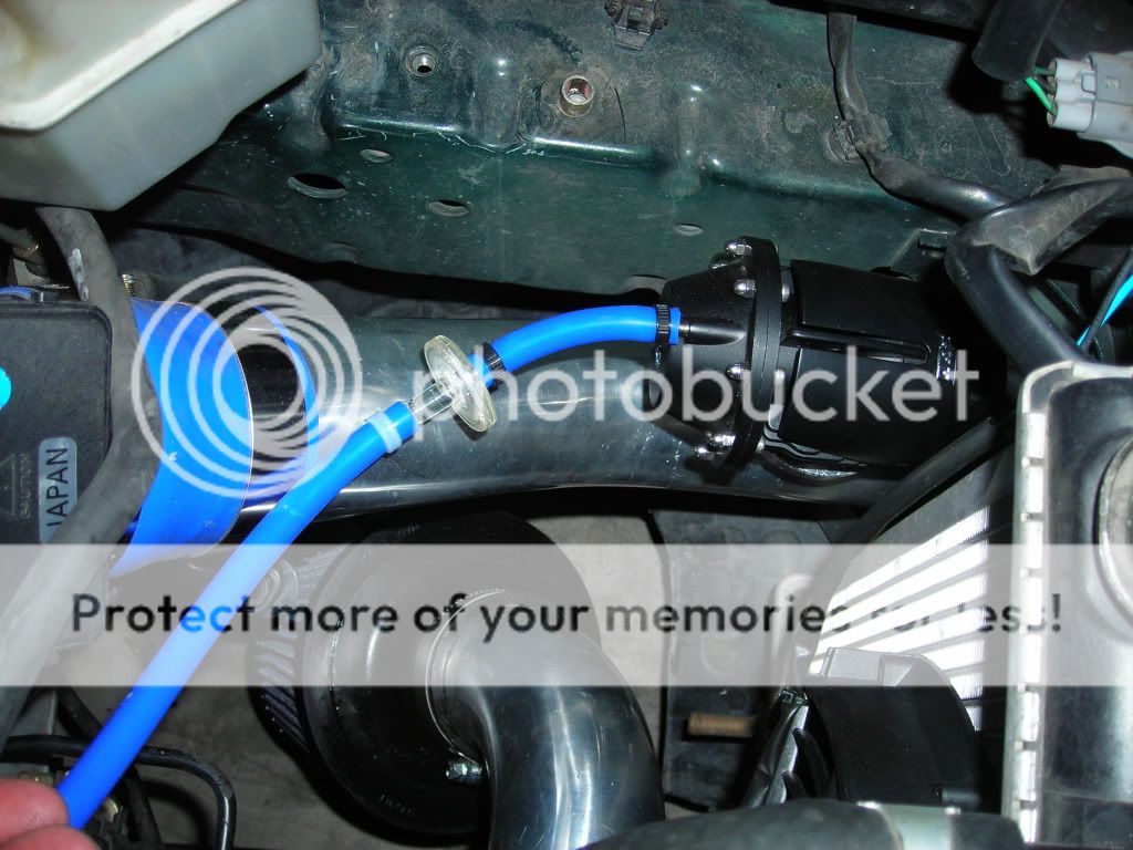

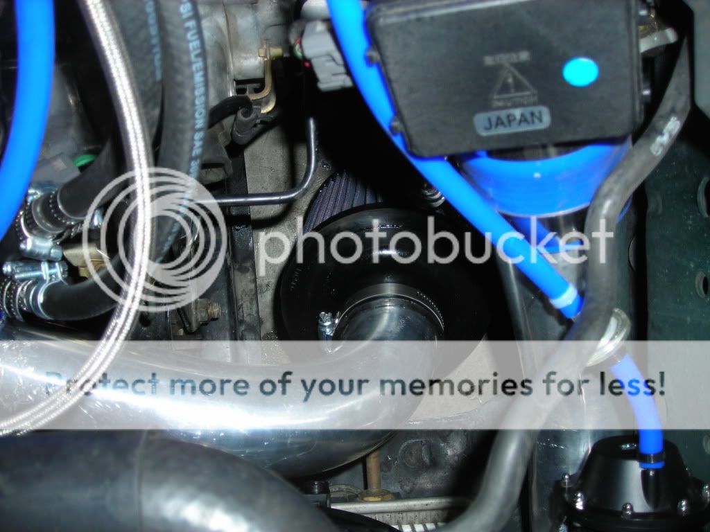

check valve on the bov? dont think ive seen that before but i dont know much about turbo builds

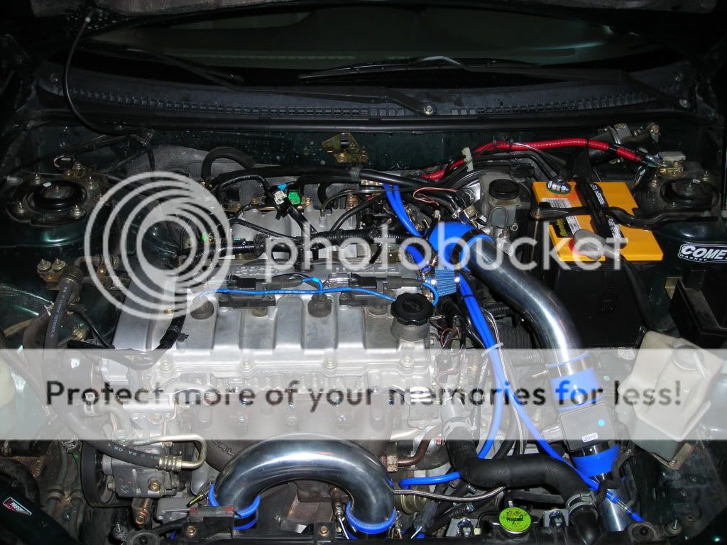

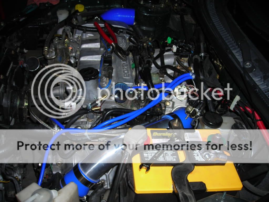

looks like a clean install though good job
