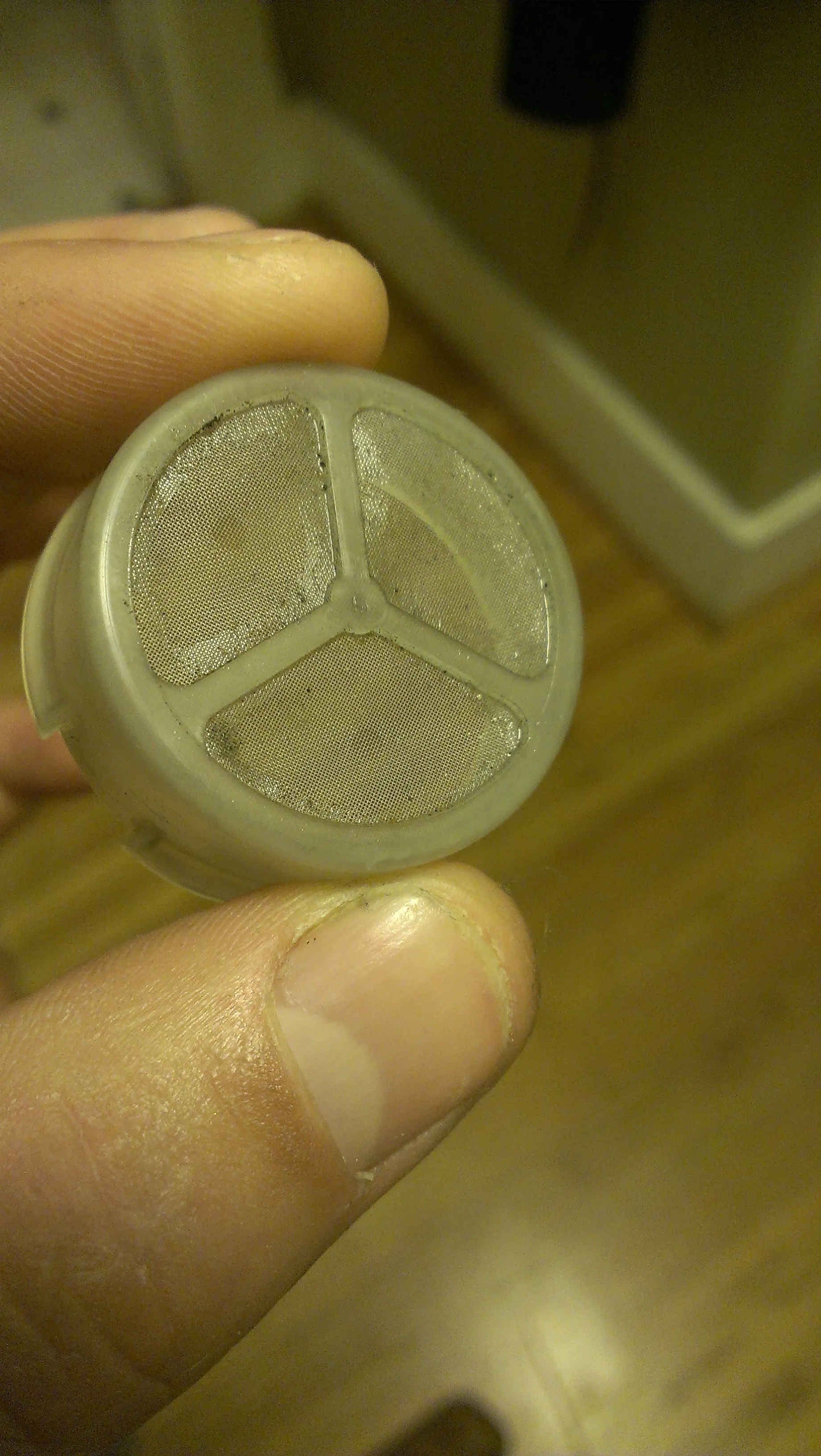

and also after looking around I saw this little filter sitting in the engine bay by itself, anyone know what it could be?
car has 190,000kms, automatic, 2003, driven everyday, has not had any issue until now.
I just went out and looked under the hood of my car trying to find that thing in the pic. No luck. If I had to venture a guess, and that's all it is, I would say it is a debris screen that sits inside the coolant reservoir opening. Under its cap.
^I agree,.. that's definitely the screen from inside the master cylinder,... but that may be the least of your worries now. You may have blown your head gasket or even warped your head.
