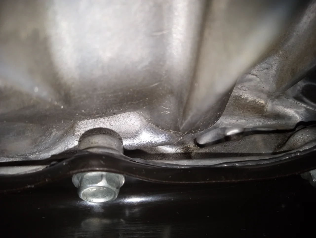

I didn't find clear evidence of leak. No oily residue dripping down the sides or through bolt holes. I could see or feel the RTV (it looks silver in the pic) in most areas around the pan, except near the wheel. The level was low though. I have 4.5 quarts in now. Will keep monitoring the temp and level. Temp went as high as 212 on a long drive after the filter job. After adding 0.5 quart, temp now goes as high as 208. I am looking for threads about ATF temp, found mostly folks trying to get the info displayed, but not much about the actual temp. 😬

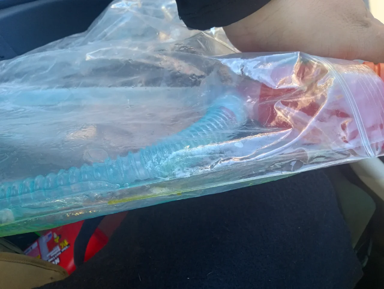

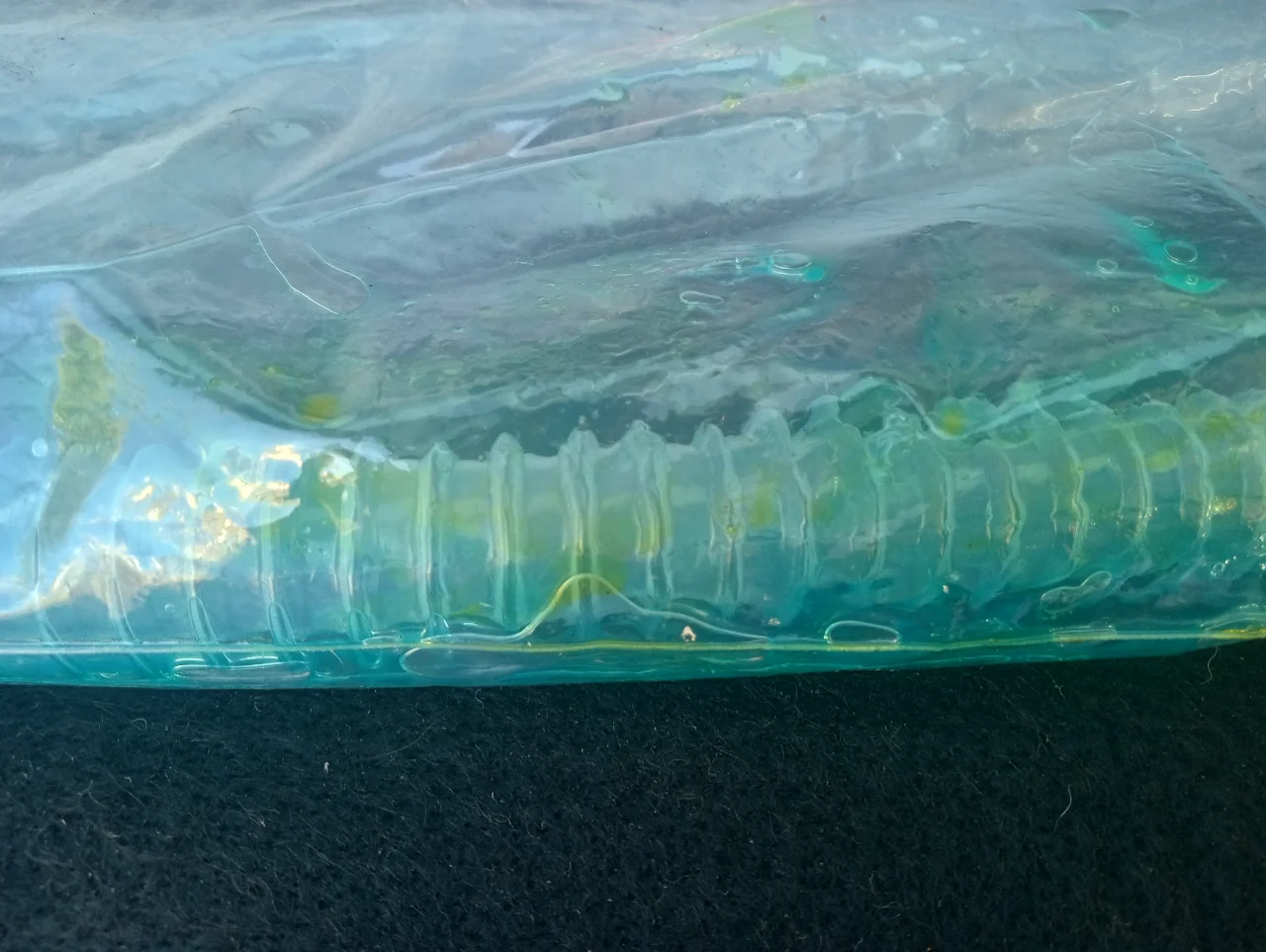

Here are pics of fresh fluid in blue and yellow. This was tucked in the deep end of the trunk for the most part. It must have got exposed to the sun while I left the hatch open at the campsite.
