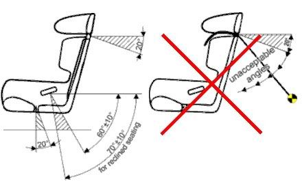

I don't think that harness routing for the anti submarine straps will pass tech anywhere. The angle has to be right, because in a collision as it stands, it looks like you could slide under the hip straps and the anti-subs wouldn't be doing anything for you. This should be what you're looking for:
Hm you are right, I used the same measurement locations of the stock locations I used before on the recaro's, but now that the seat has moved back and is floor mounted it is back further. Everything is still just tack welded until I got it finalized. I can move the eye bolts to the bar directly under the front of the seat for the proper angle.
Thanks for the catch.
