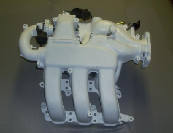

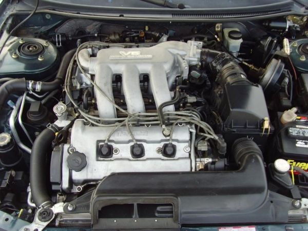

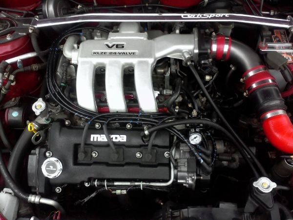

The easiest way to tell the difference is to look at the intake manifold.
Straight neck JDM KLZE (198hp);
Curve neck JDM KLDE and USDM KLDE (170hp);
Straight neckUSDM KLDE (165hp)
KLG4 (170hp)
