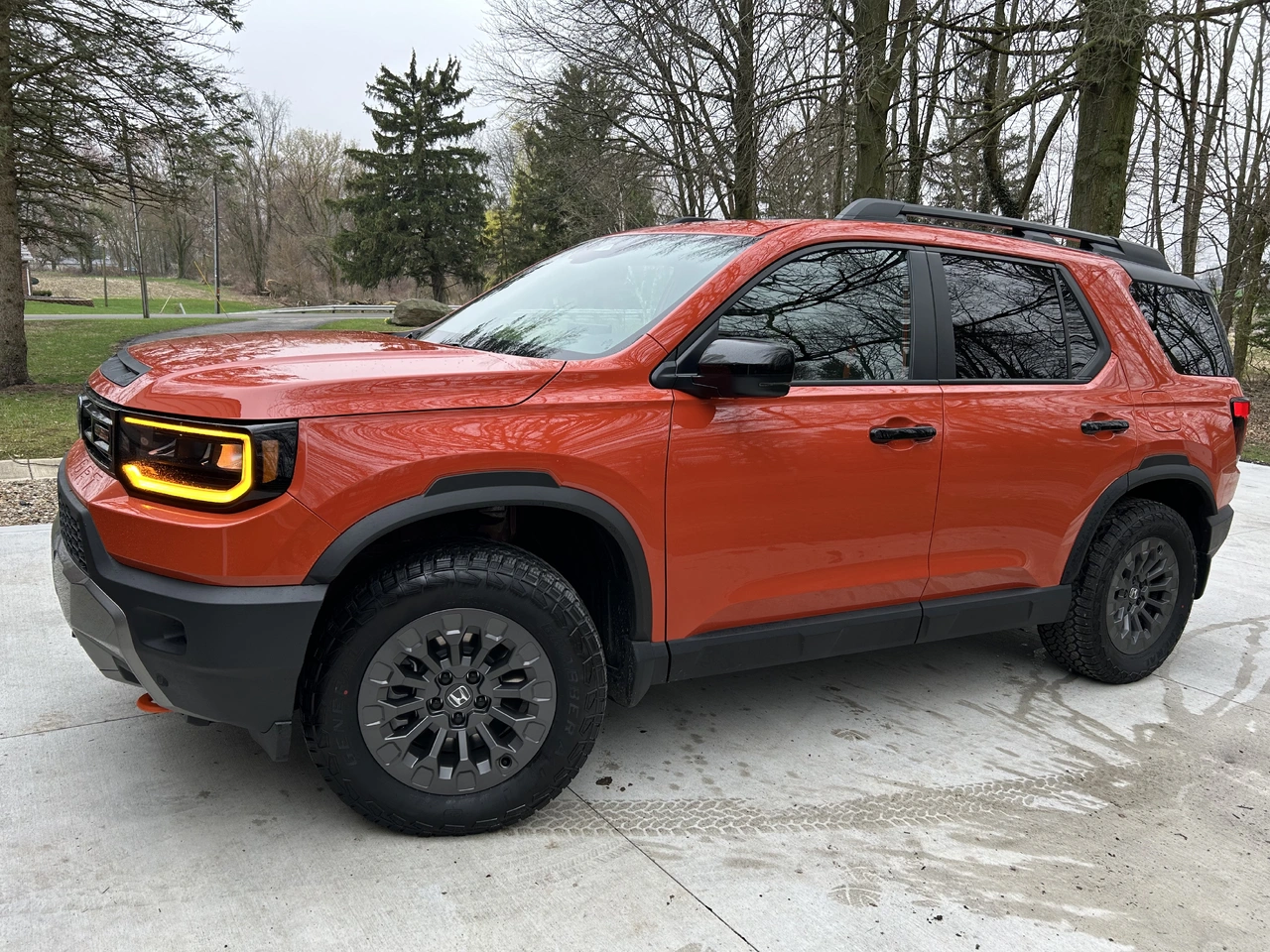

We traded our ‘22 Signature on a 2026 Honda Passport Trail Sport…The CX-5 was an amazing vehicle but it was time for a change, which we do every 3-4 years.

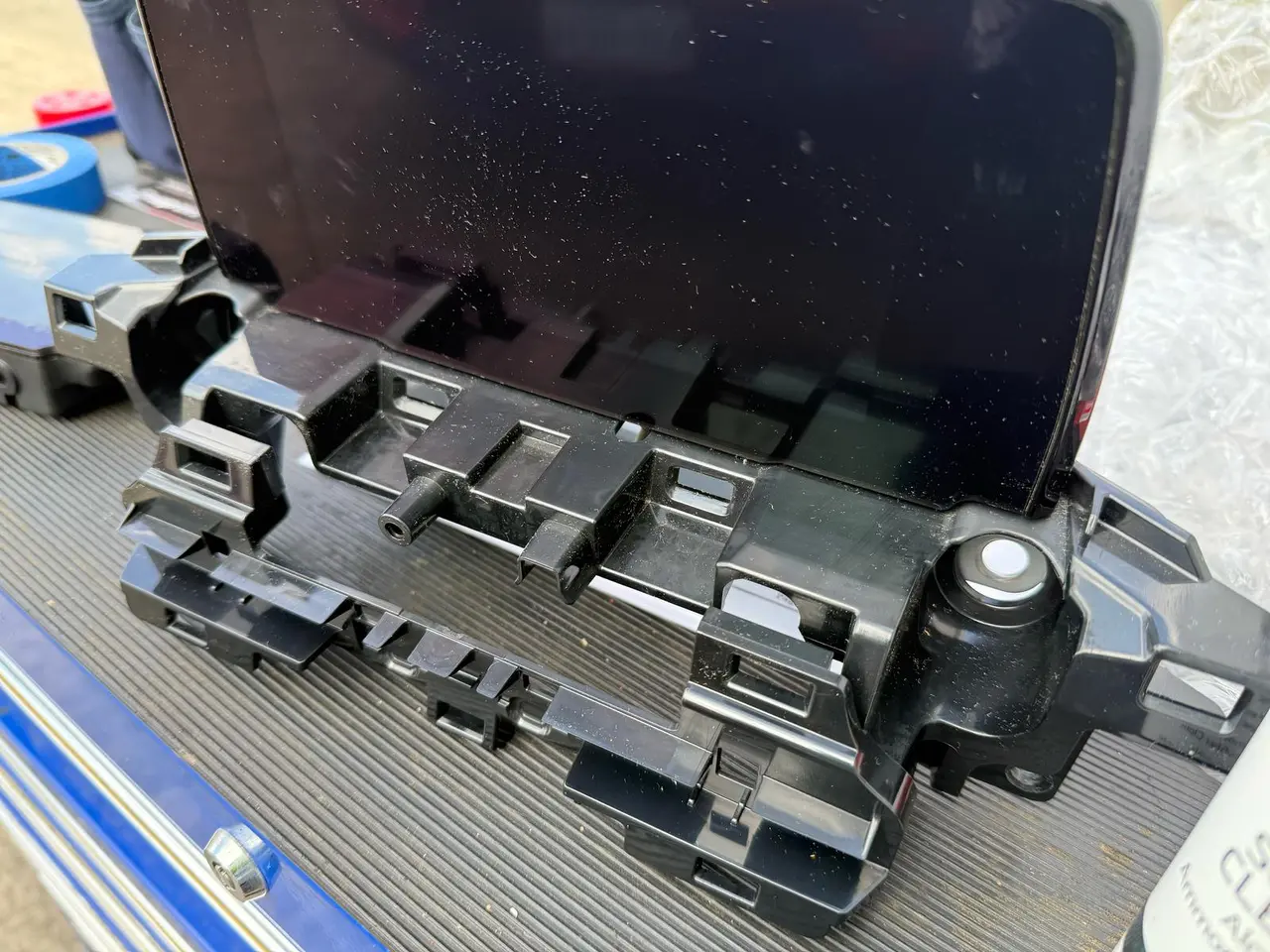

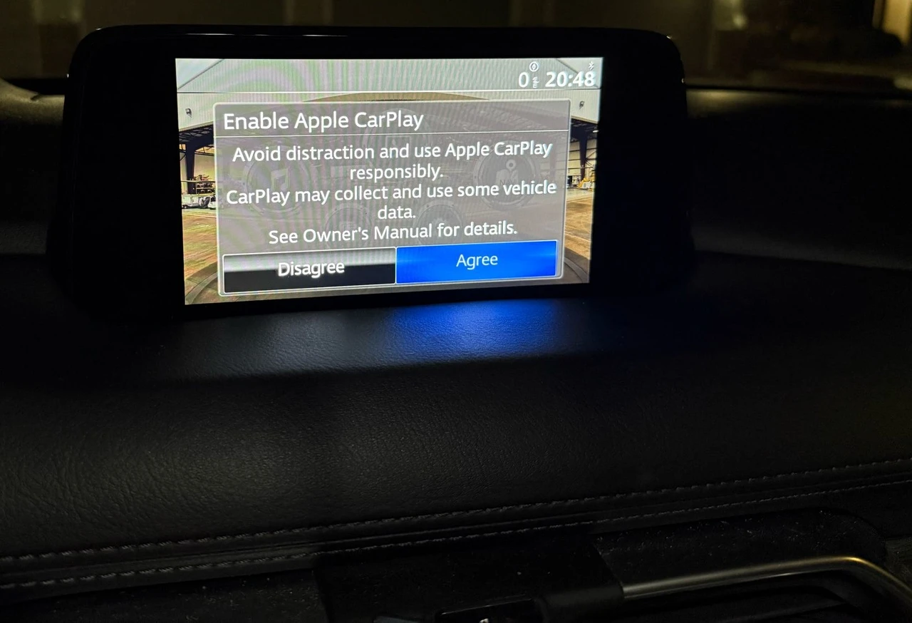

Removed and replaced the faulty centre display monitor. It took me around 50-60 minutes to do it by myself after watching some YouTube videos. No more ghost touch screen for me for a while
My wife has been complaining about hers. Did yours exhibit problems while driving? I had assumed that it would not, given the touch screen is disabled (while moving).
Also, where did you get a replacement & how much?
The ghost touch happens only when the car is stopped or barely moving. Once you gain speed, touch screen is inhibited. I found the display on e-bay, payed a total of 265. Ordered it Sunday, got it today and installed it immediately. Price varies, I've seen some under 200$ and other one even at 600. I tried to find one that was "grade A" and they even posted the VIN number and the mileage of the originating car. The lower the mileage, the better the screen should be. If you have a Phillips screwdriver, a No. 10 socket, a small extension and a ratchet, you're all set.

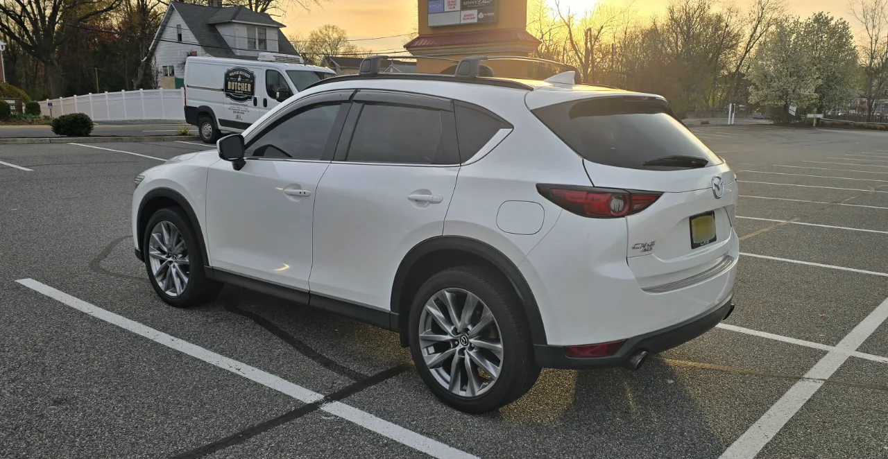

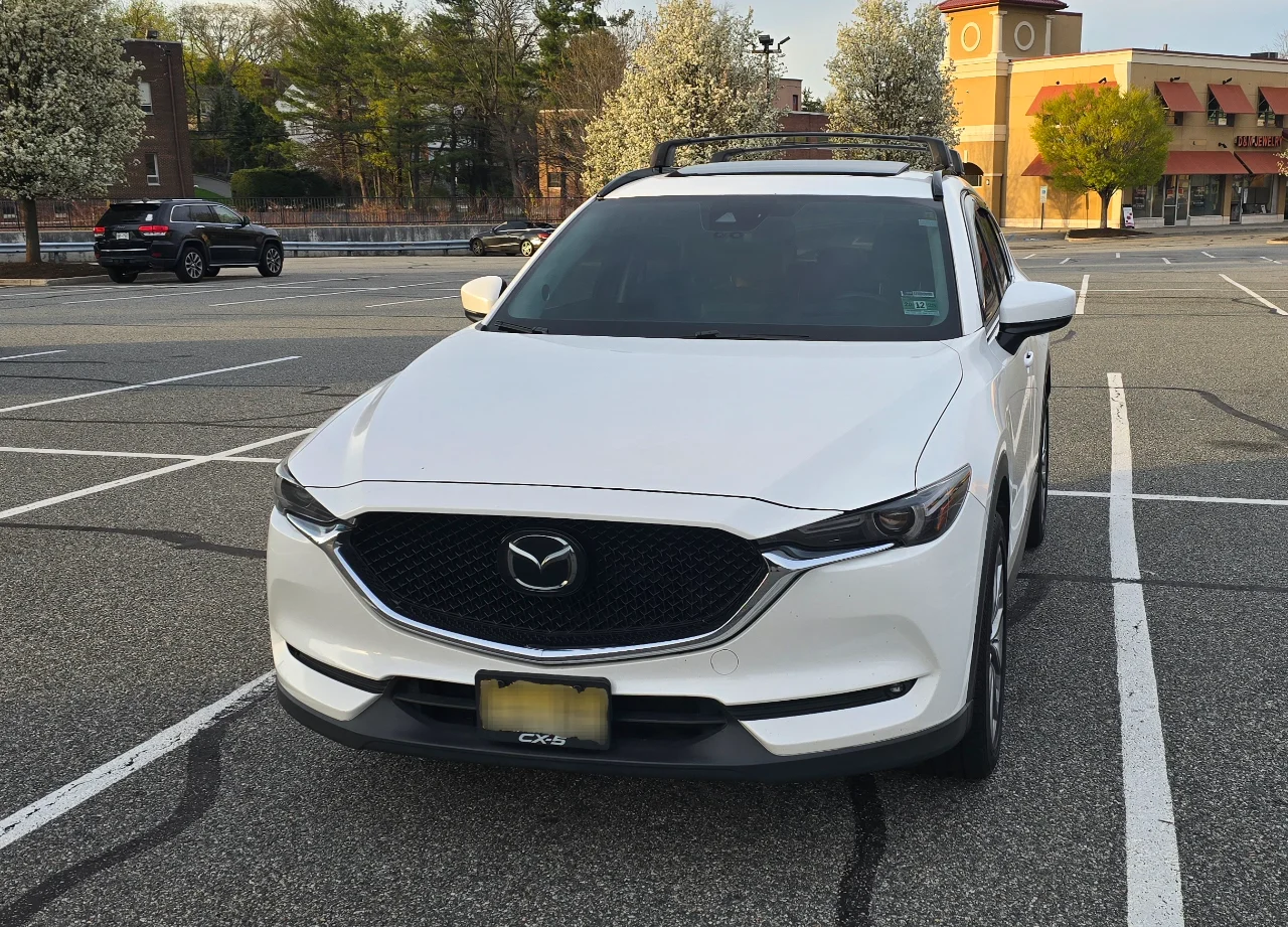

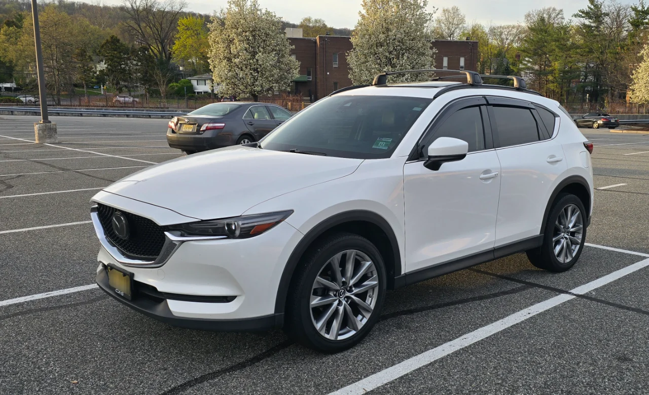

Hi, I'm new to the forum and looking forward to new mods or upgrades. Here is my 2018 CX-5 GT with the summer set installed.
