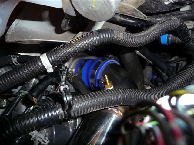

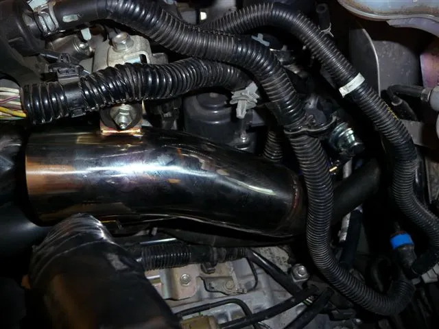

Here are a couple of pics of it installed. I like the way it sounds - my intake noise went down, and the forge is a little less harsh. Performance-wise, I'll wait 100 miles and see. So far i'd say it's money well spent. Thanks, Ken!
P.S. - I highly recommend a reticulating socket adapter for the two clamps by the turbo.
P.P.S. - Ken - that vac hose could be about 1/2" longer. Mine was a pretty tight reach.
