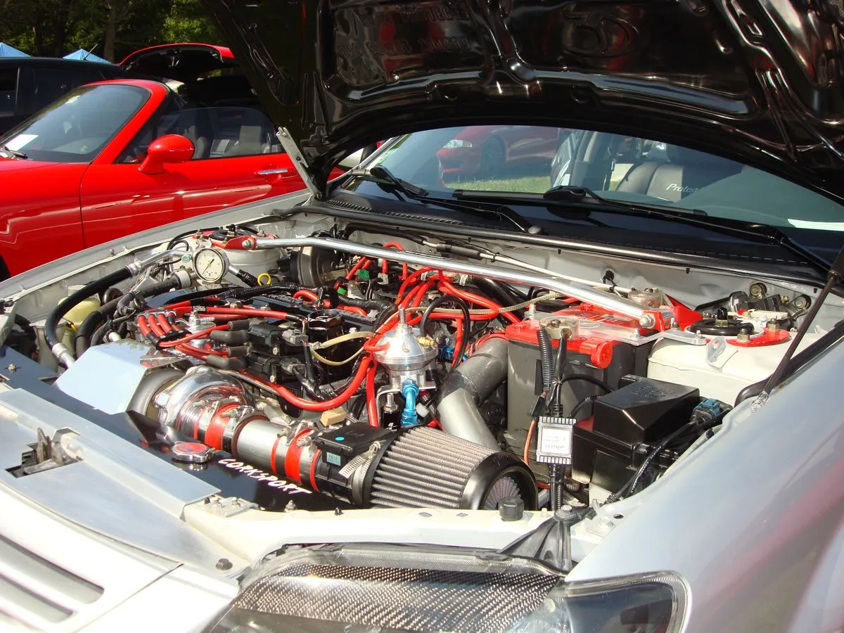

this is mine after a long NE winter, sand and salty roads

Very nice engine, I don't mind putting a few hundreds to get rid of the rust. I guess changing pannels would up that estimate from a few hundreds to a few thousands or is it still affordable?

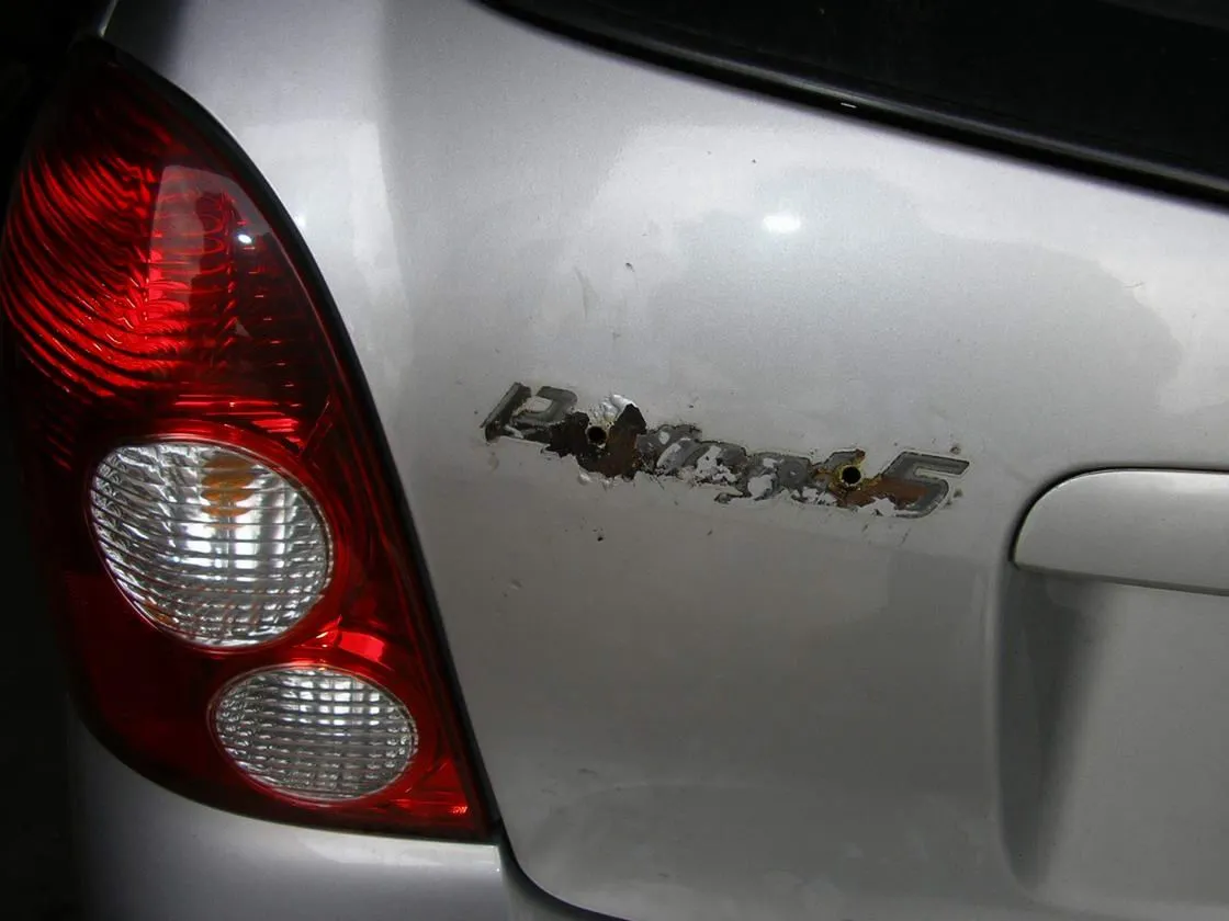

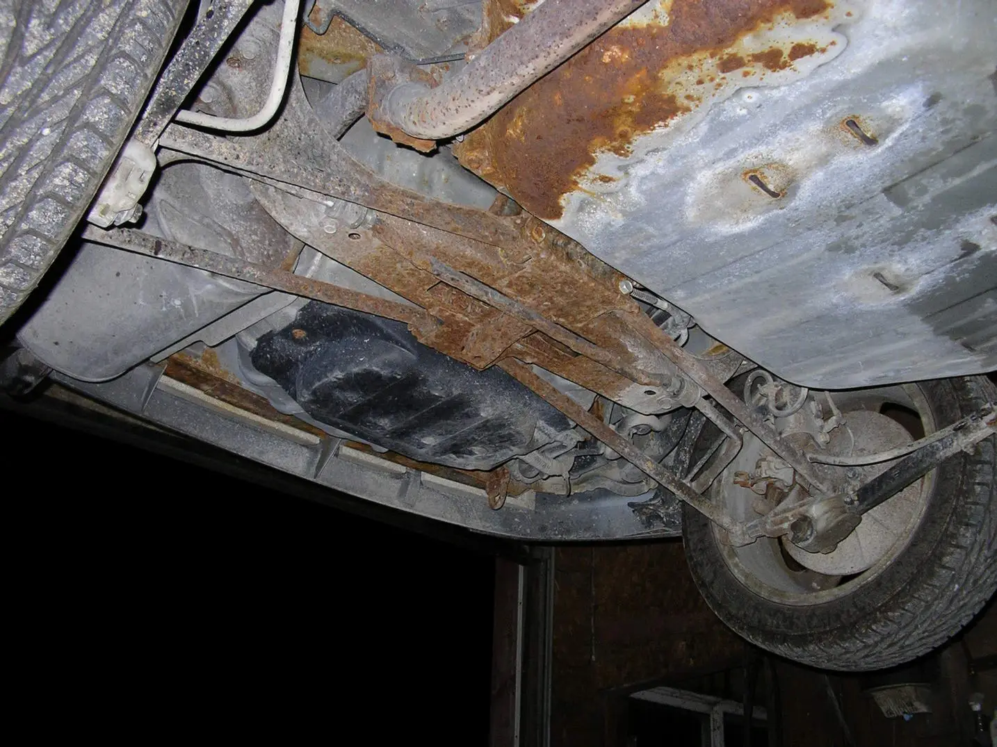

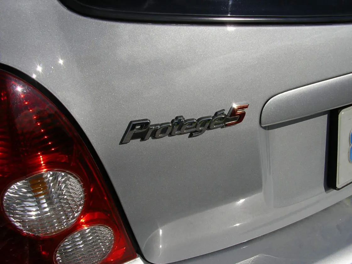

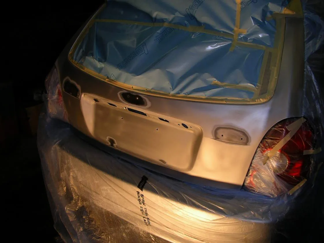

I have a 2002 P5 bought new and after the 4th year the bubbles appeared around the Protoge5 emblem and rear wheel well edge. Fortunately with a help of a friend we have repainted the whole hatch and it turned out pretty good. After 2 years still no rust on it. However I did notice a lot of rust on the bottom of the car so with my friend we have undercoated it with thick undercoating oil. Also, I would like to let everybody know about a product called Fluid Film. It's amazing stuff. It doesn't wash off and it's made of wool wax. I sprayed it inside my doors, hatch, fenders, hood and rocker panel. It's not cheap but it is cheaper than repainting or replacing body panels. You can spray it on rust and it will stop it immediately.

Damn dude, where are you from that you're getting rust like that? Do you live by the ocean or something?
We pay extra tax here in London, Ontario so that the sanders will put down more salt. (rant)
Nice job on the emblem repair, I have rust on my silver P5 in exactly the same place, plus I've been told that the oil pan is rusted out.
No, nowhere near ocean but we probably got just as much salt in winter on our roads. London, Ontario is about 2hrs North-East of Detroit.
