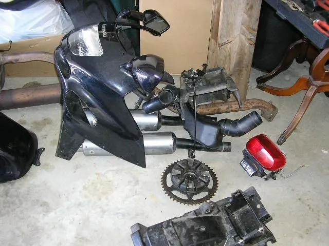

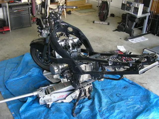

Project: Zero6E
Bike: 2001 Kawasaki ZX6E
Problem: Motor is shot (not sure which part I assume the rods)
+ Its kind of dirty, with everything apart I can put s*** in the dishwasher :)
Solution: Tear the s*** out of it and hope for the best
History: Purchased the bike for way too much and then came into a nightmare
Forks need to be resealed
Front Tire needs replacing
Brakes need replacing
First Motor poped (huge hole in block)
Second Motor is about to pop (trying to save it) OR modify frame for a bigger badder motor ...(depends on funds & what not)
If anyone has rebuilt a motor please give me some tips/hints or if you live in Ga and wanna stop by one day and just tell me what to do I'll supply the beer :)
Pictures Attached
Have a ton more if anyone wants particular shots for some odd reason

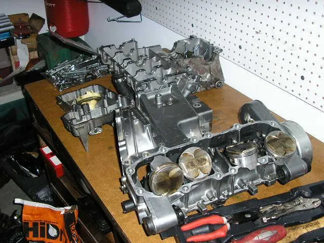

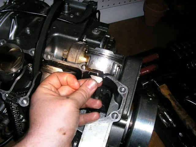

Well...tore the motor apart and found the problem
Broken piston skirts aren't uncommon in the inline 4 motors. Especially the 600cc bikes since they rev to the moon. To answer your earlier question about the bikes I've owned...I started with a Honda Hawk GT. Great little bike...handled great, just underpowered, but the single sided swingarm was cool. I swapped the front end on it with a CBR F3 front end so I could have dual front rotors and a 120 series tire. I made a tough decision and traded it in on a 1993 Ducati 900 SSSP. That was a lot of fun and pure sex on wheels, but I was starting to ride pretty hard and the Ducati was just too expensive to fix if I crashed. I've got a 1997 KTM Duke right now that I've had for several years. I've been to Deal's Gap on both the Ducati and the KTM. I've done a few trackdays at VIR on the KTM as well. I've crashed it a few times and it's still good to go so it was a good purchase for me. I'm probably going to sell it soon, though. I've been dumping a lot of money into the car lately and I haven't rode the bike since last fall.
