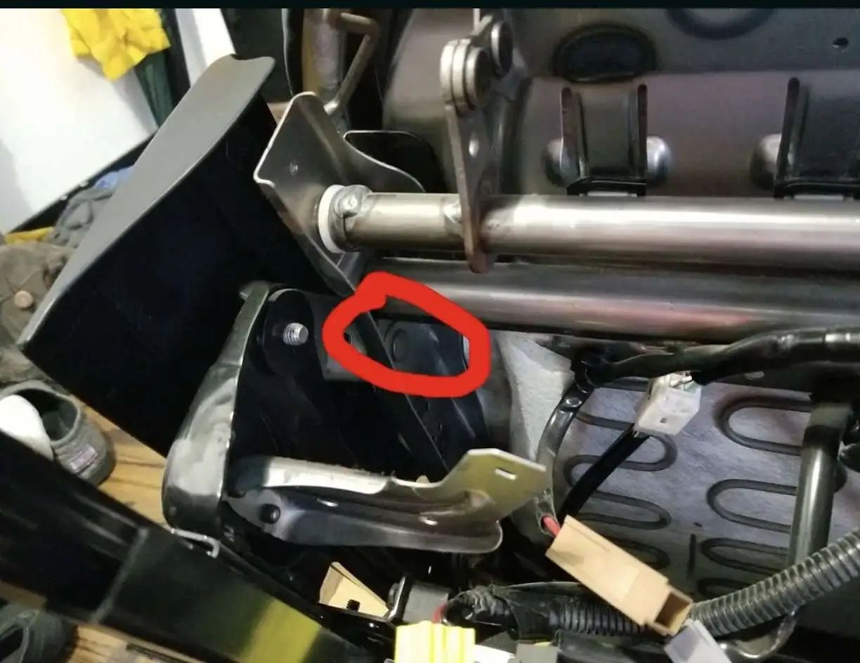

This is an old thread, but I wanted to update with what I found after taking my drivers seat out and looking at how it is put together as this thread seems to have the most comprehensive info on the issue.
I just bought a 2013 CX-5 GT and after getting home I noticed the seat rocks. It rocks side to side as well is 'up and down'. Front to back is fine.
I took the seat out of the car expecting to find a loose bolt, but it turns out to just be supported by large rivets that are used as pivot pins for the motized seat. This one pictured below in particular is the culprit for side to side movement (there is a sister rivet on the other side).
http://s108.photobucket.com/user/deeno35/media/2013 CX-5/5b7f772d-8de7-4dbb-ac10-49302a19e7e8_zpspphfhqsq.jpg.html
This is the other side of it:
http://i108.photobucket.com/albums/n32/deeno35/2013 CX-5/e14f86f2-c320-43a6-be15-0fef38d5d267_zpsd75fhp92.jpg
This rivet is meant to allow motion in one direction (rotation around the pin). What happens is either the rivet is not pressed tight enough from the factory, or it is stressed out in some way in the side to side / twisting direction and once that happens it will never return to being tight (ie only moving along one axis again). I can literally 'twist' this joint and move the seat rail with my pinky when the seat is out of the car.
After seeing this it's no mystery that many of the seats have this problem and the fix is to replace the entire seat base sub frame. One could technically drill the rivet out and use a large nut+bolt with a split and a flat washer on each side to solve this problem (ie same setup as the lower seatbelt anchor found on many cars). So far I am not desperate enough to do so, but if I hear of any crash reports where the seat failed, I will do it.
And there’s a TSB which I couldn’t find also states the remedy of this problem is to replace the entire seat base sub frame ($$$).

I can't get a good look at both sides of this rivet from the one picture (the other is '404'). Is it possible to tighten this rivet by compressing it slightly (akin to the bucking bar and hammer for riveting)?
Yeh the first picture is gone from PhotoBucket but we can see the large custom-sized black rivet circled in the second picture. These large rivets are used to support the seat and also used as pivot pins for the motorized seat. By looking at it it can’t be tightened by compressing it easily as it may not be made of aluminum like normal rivet.
I figured the rivet is steel due to the application. Steel is malleable with enough 'percussive" persuasion.
