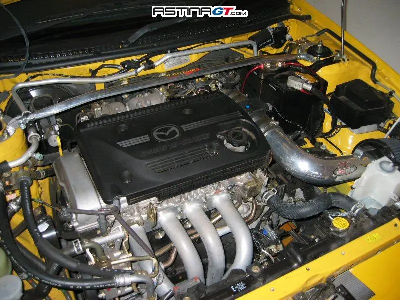

hers my pic (thumb) kind of hard to see but i just stuck the sensor in to the coupler :)
you did it after the maf? i thought it went in before the maf?... no issues with that?

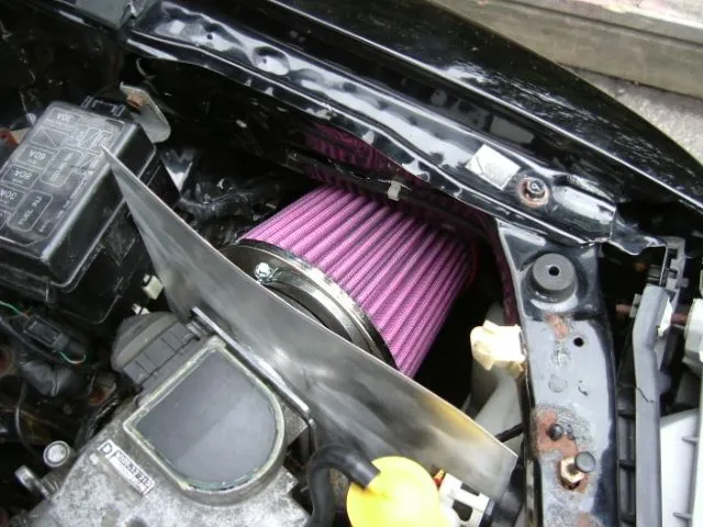

I'm not sure if you can tell by this pic, but the filter actually goes into the fender.

lol.. ok
im gonna drill a hole like u did in the coupler. looks good. but mine will be before the maf, in between that and the filter.

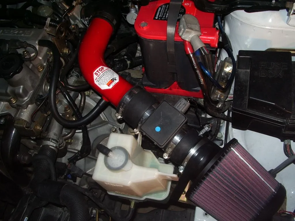

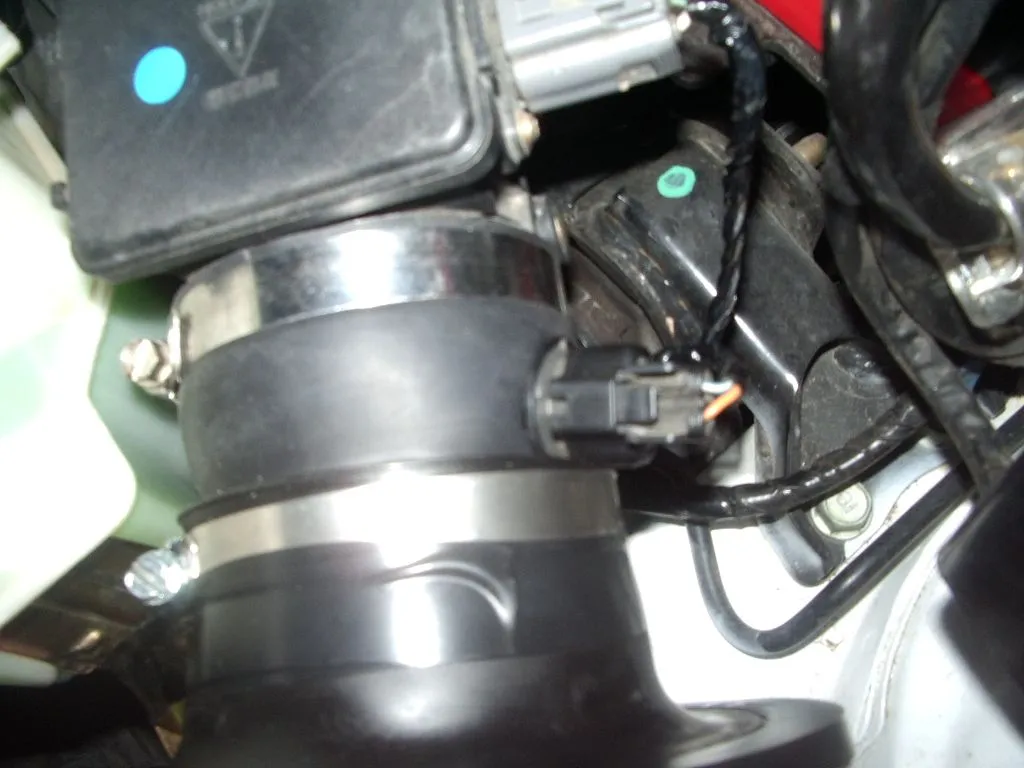

I bought a CAI from ebay, and decided it floods too much around here to feel safe with it, so I just tossed out the second half of the pipe. Painted it, and bought a K&N filter. (first pic) second pic is the IAT, I cut a little slit in the rubber coupler and pushed it in. done and done.
