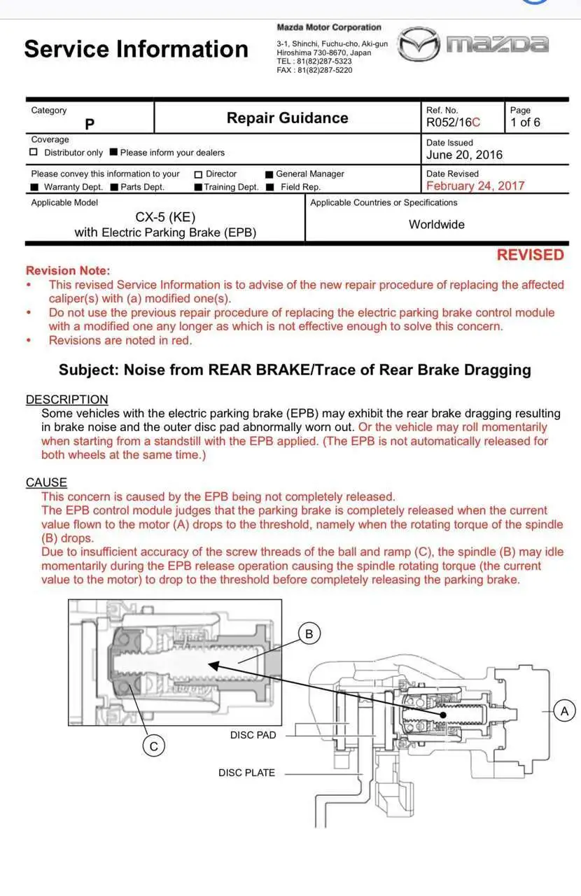

There’s a date code on the caliper. If the production date on caliper is before 9/7/2016, you want to get a new updated caliper as the older calipers tend to have brake dragging problem or even locking up.
TSB No. 04-001/18: Noise from Rear Brakes Due to Brake Dragging

Keep in mind that if the date code of your rear calipers indicating they’re manufactured before 9/7/2016, you may still have dragging or locking issue after the caliper rebuild as the inaccuracy of the screw threads on ball and ramp in the caliper which will affect proper EPB release. Just have to watch the symptoms outlined in the TSB.
