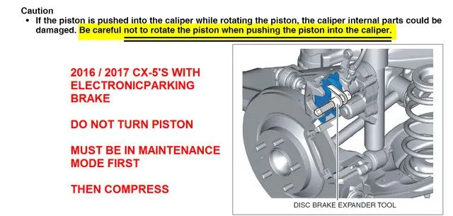

Since you have a 2016 CX-5, make sure to read the EPB dragging TSB and see if you need a pair of revised rear disk calipers. And make sure you need to put EPB in Maintenance Mode, and don’t turn the caliper piston while you’re pushing it in.
I believe your rear disk brake problem could be either the garage didn’t put the EPB in Maintenance Mode at first, or they rotated the caliper piston, or could be both.
It’s also possible your rear disk calipers already at fault with EPB dragging issue, and in this case you do need a pair of new revised rear calipers. Here’s the TSB which explains the problematic factory rear disk calipers and Mazda have to revise them to eliminate the problem:
