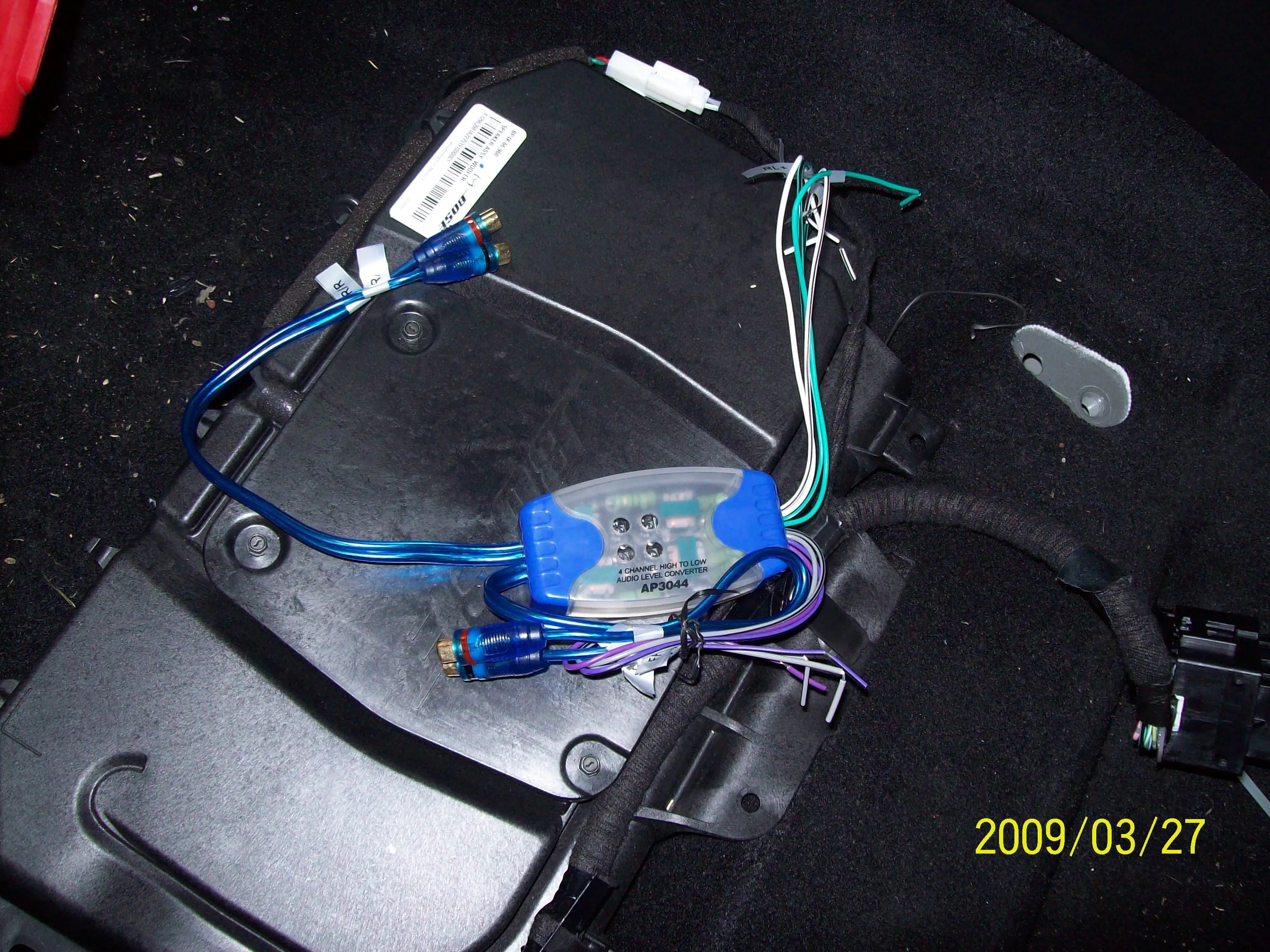

I'm not sure if the frequency is clipped or not on the Bose system. It is a possibility that the LOC that I have hooked up is a POS. What would you guys recommend brand wise for a LOC? The sound level of the subwoofers aren't up to what they should be either in my opinion (again, crappy LOC). I have a 1600 watt amp pushing two 12's so it should be hitting fairly hard in the lower bass range.

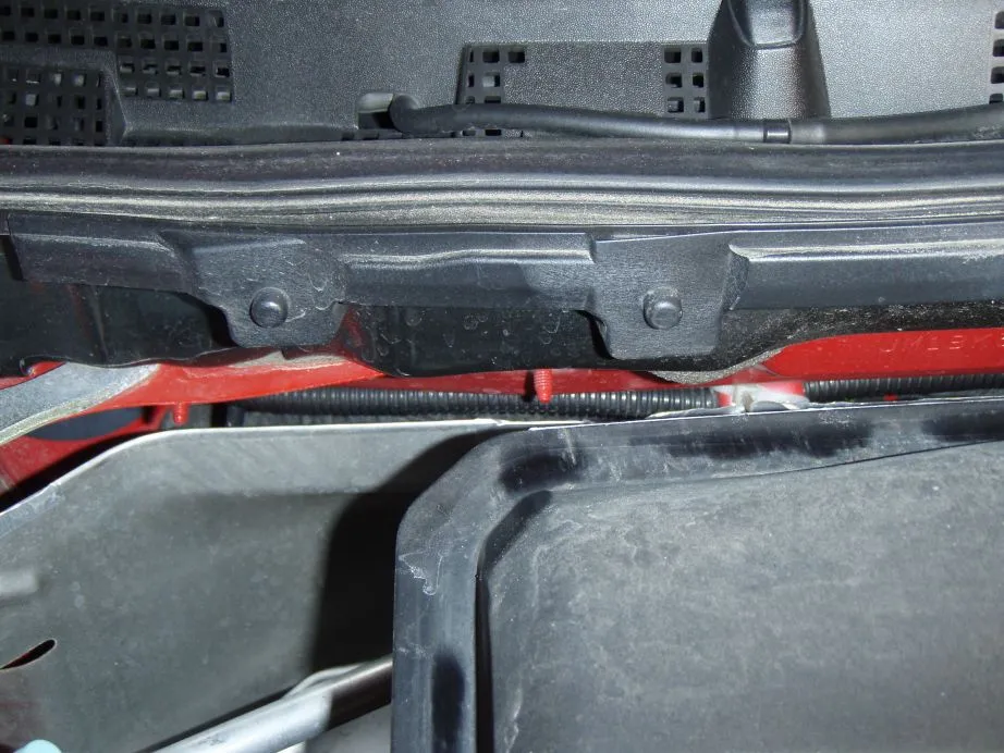

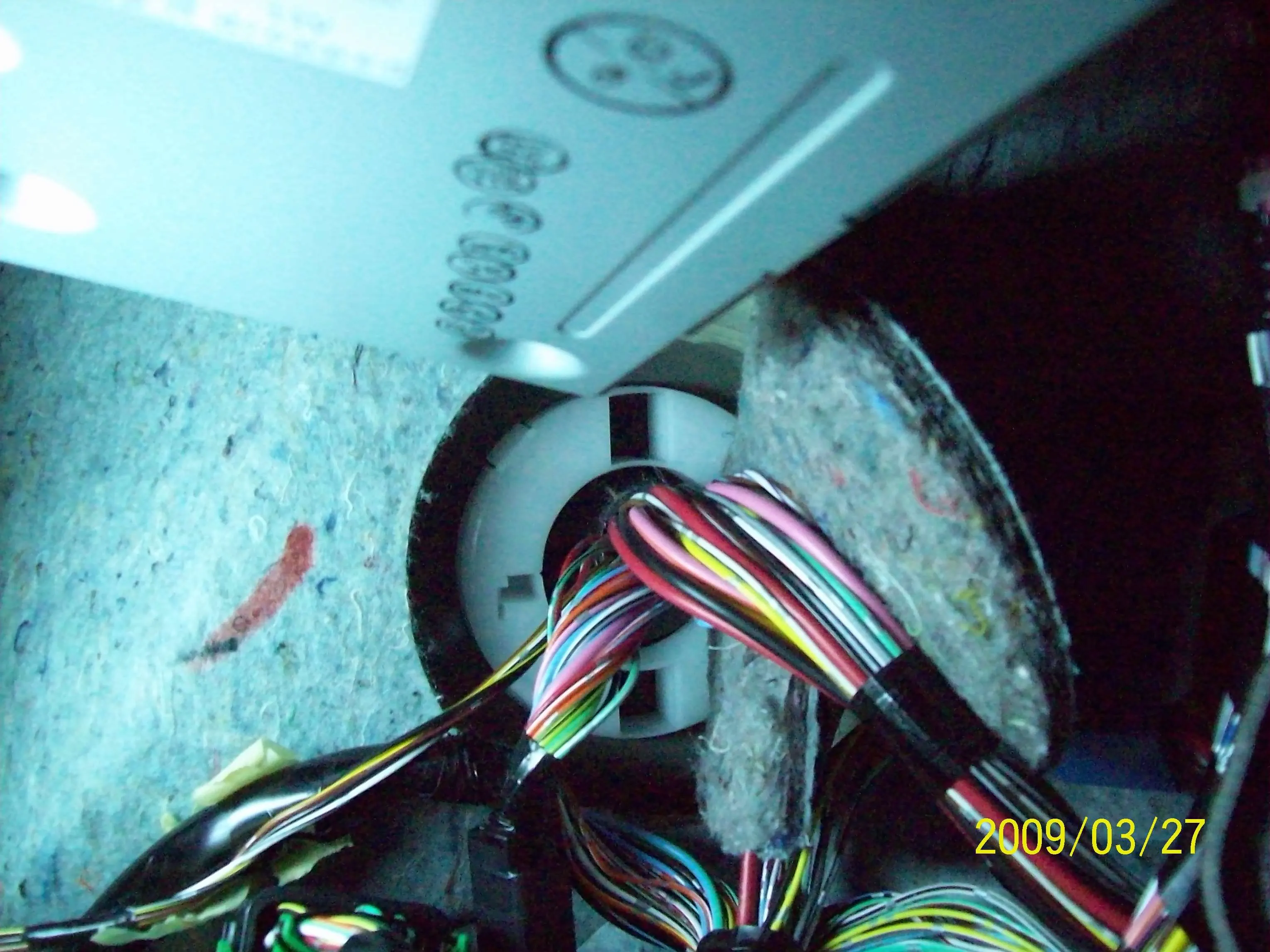

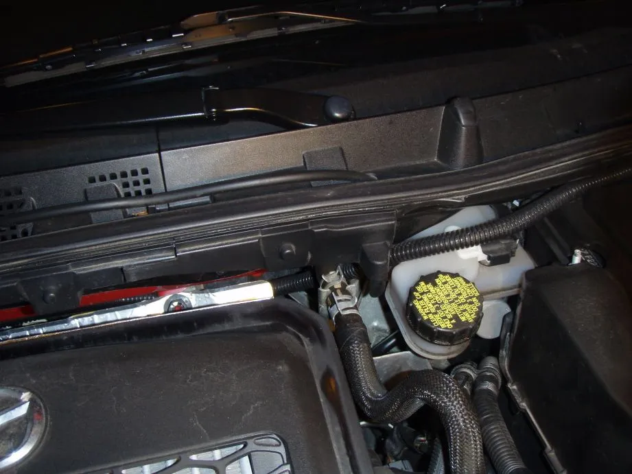

I'll take pics of my engine bay when I get home if that will help, to show you how I routed the wire without removing the wiper assembly. That link I posted illustrates perfect how to route it through the firewall though. I'd think if I had routed it bad, it would have burned by now. It's been in there for almost 2 years now though with no problems. Feel free to PM me with any other questions with your install.
I checked that link over and over but all I see is how to get through the firewall by going through the wiper trim and down on the passenger side, NOT on the driver side past the heat shield/brake reservoir. I also saw some molex wiring and some fiberglass tweet making, but again no driver's side route.

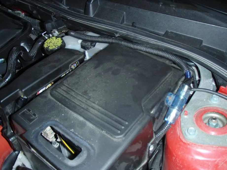

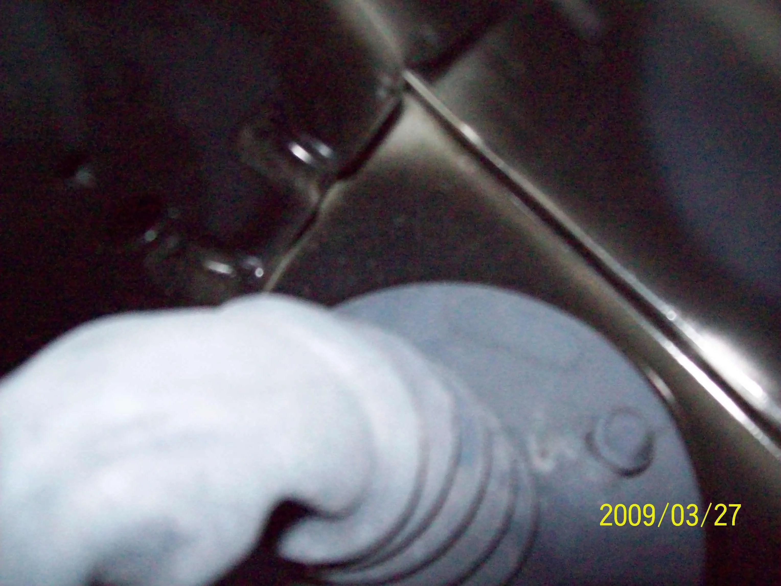

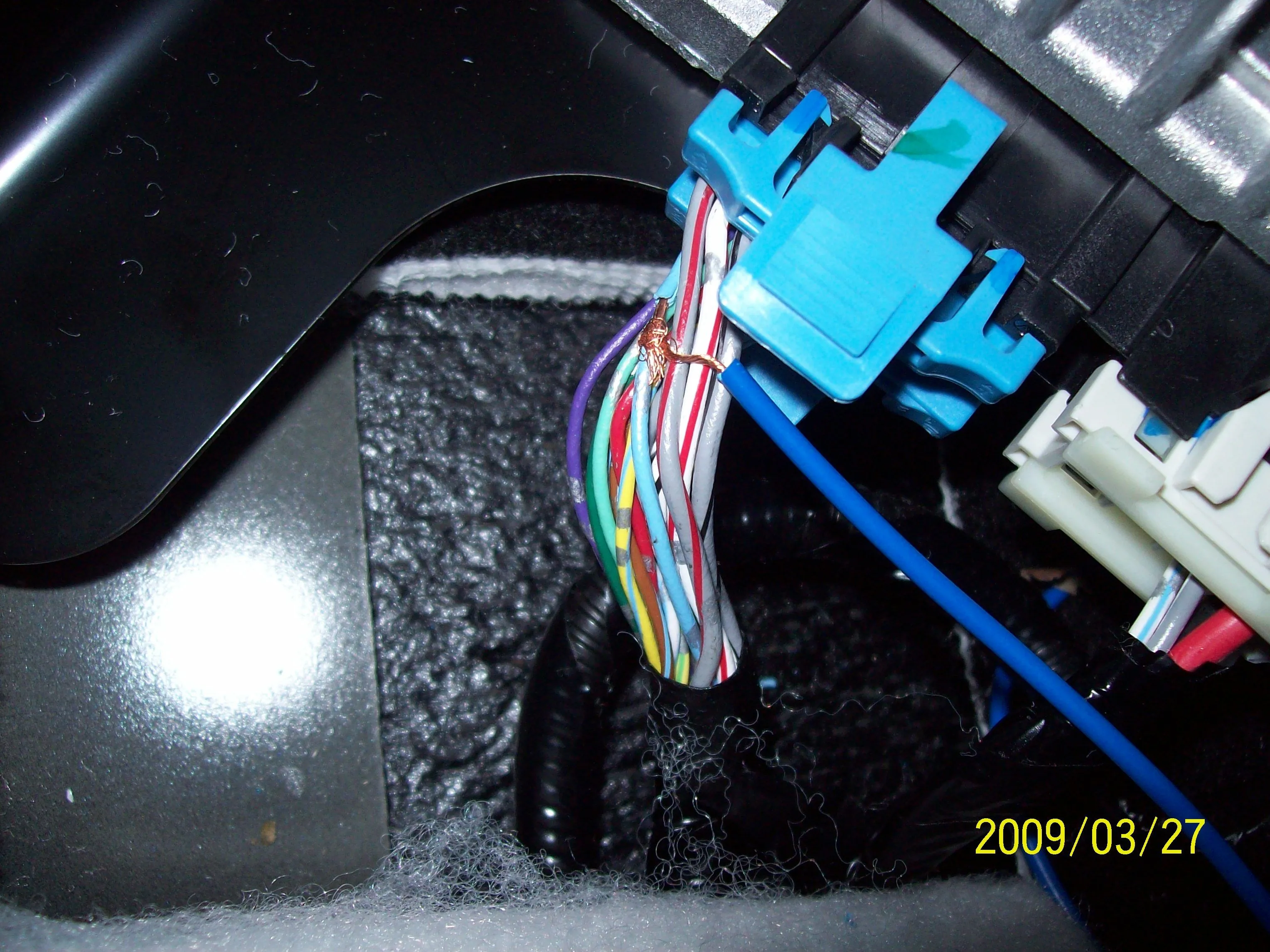

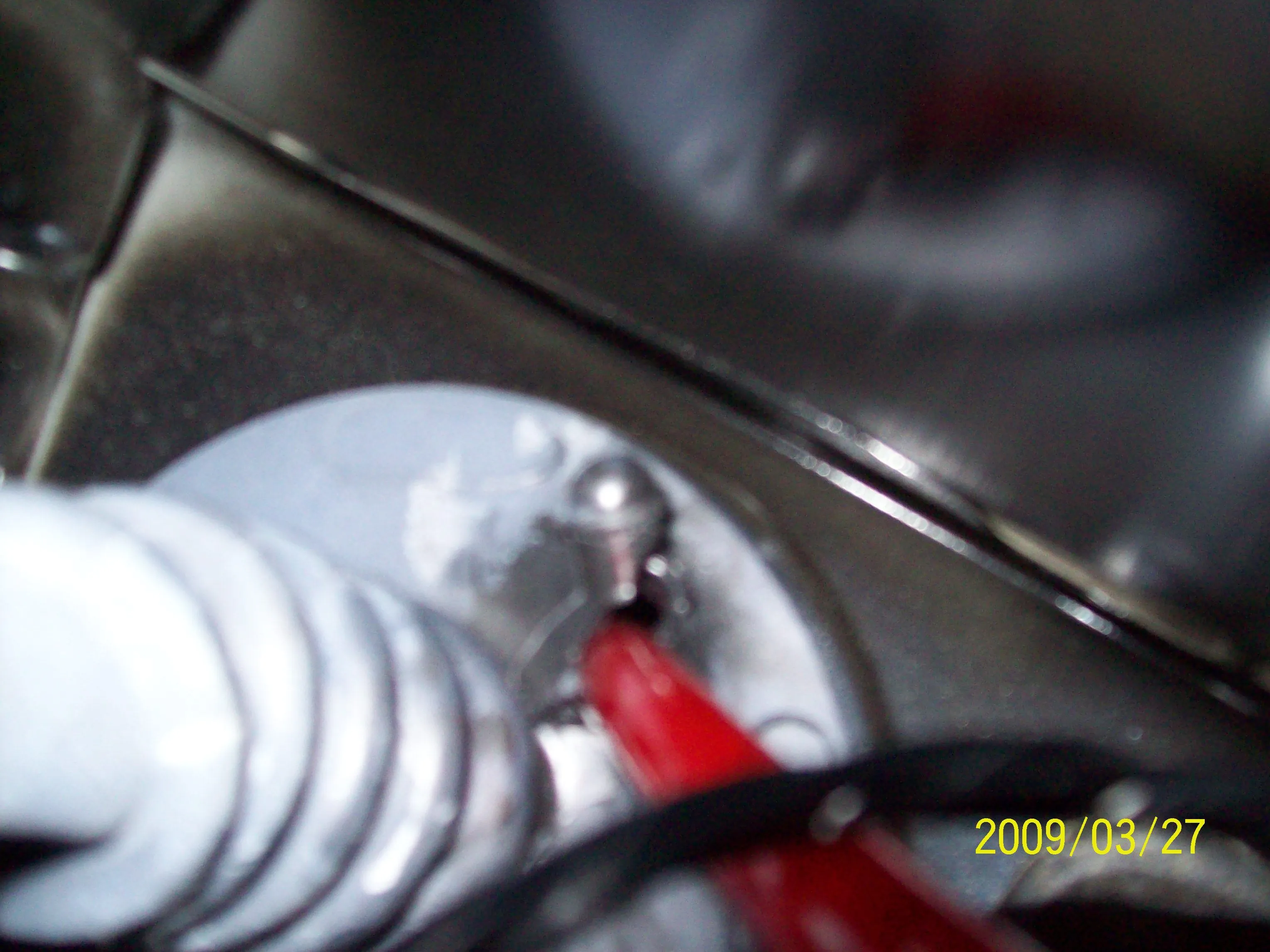

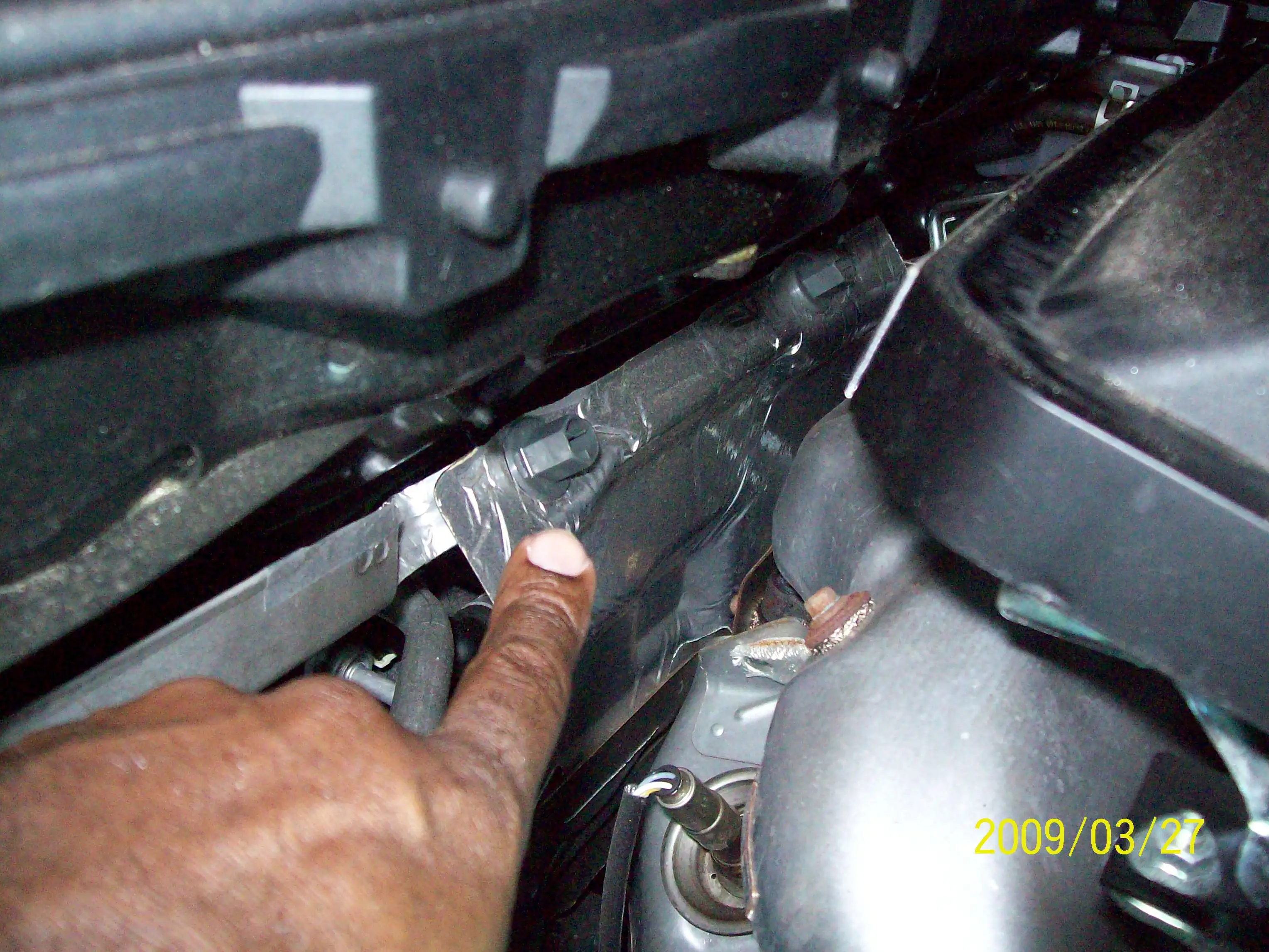

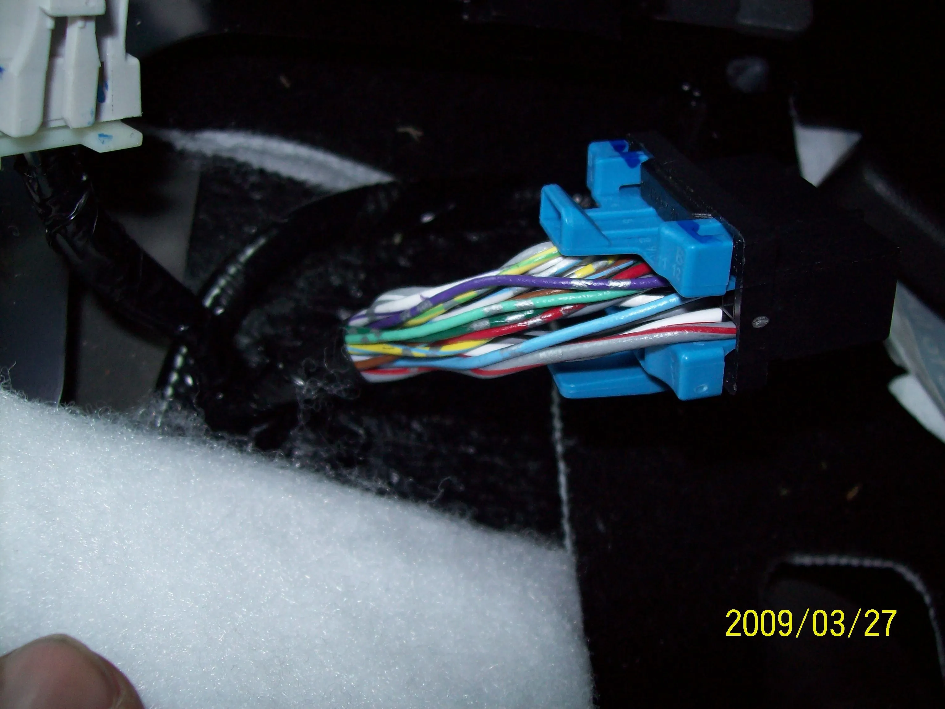

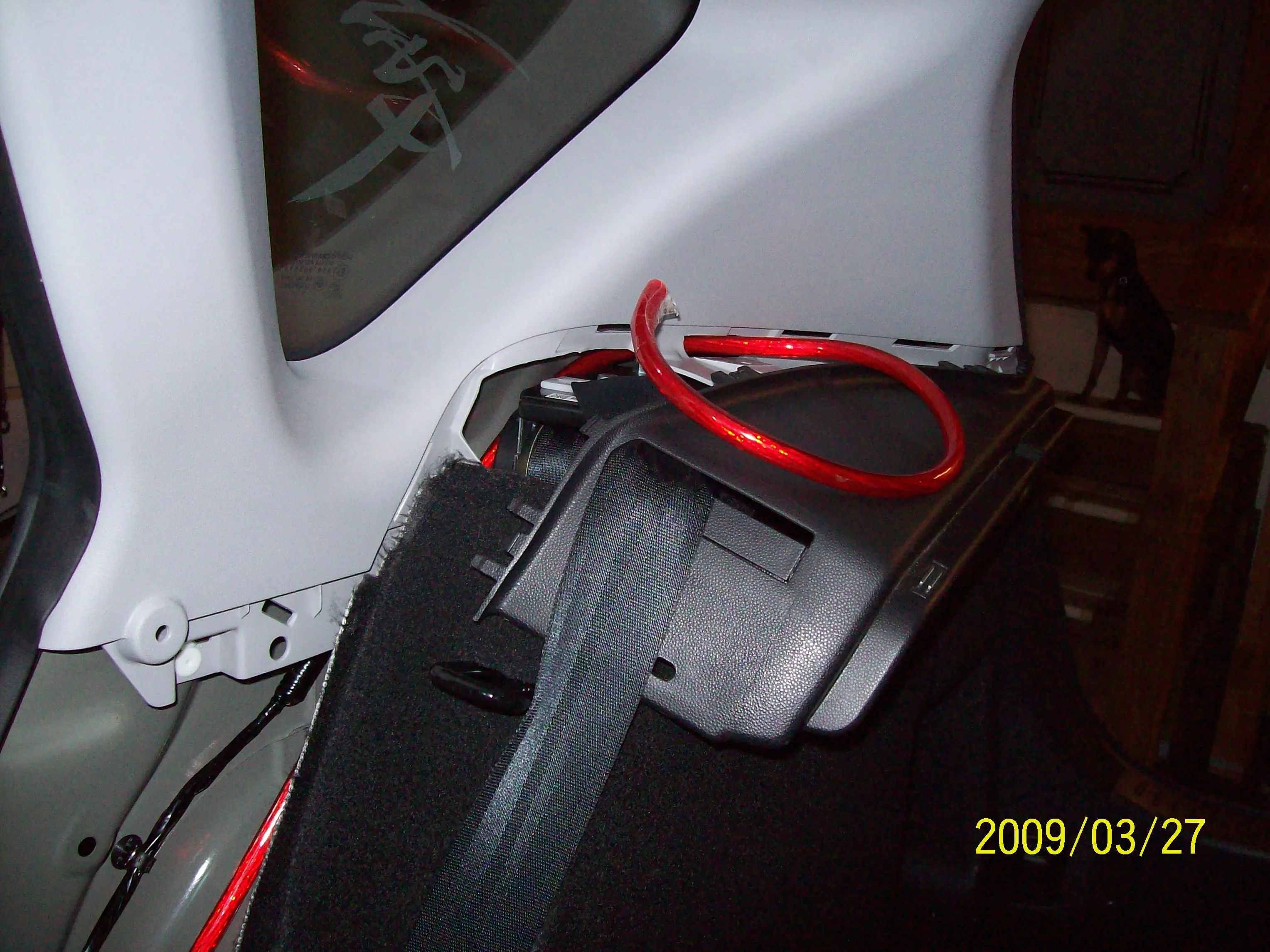

Pics
These are in order, from R to L.
Kewl... thanks for the pics Ecniemann. I Am buying a Hamster today to help me with that tight install... <:-O. LOL. I also have shielding for that power line and will do same as you. Will keep ya'll updated with pics.
WELL PLAYED, SIR (yippy)
Thanks! Hope it helps. That last picture is of the grommit. You cannot see it in the pic, but there is a little "square" above the stock harness in the rubber that I cut to run the wire through. It is very thin.

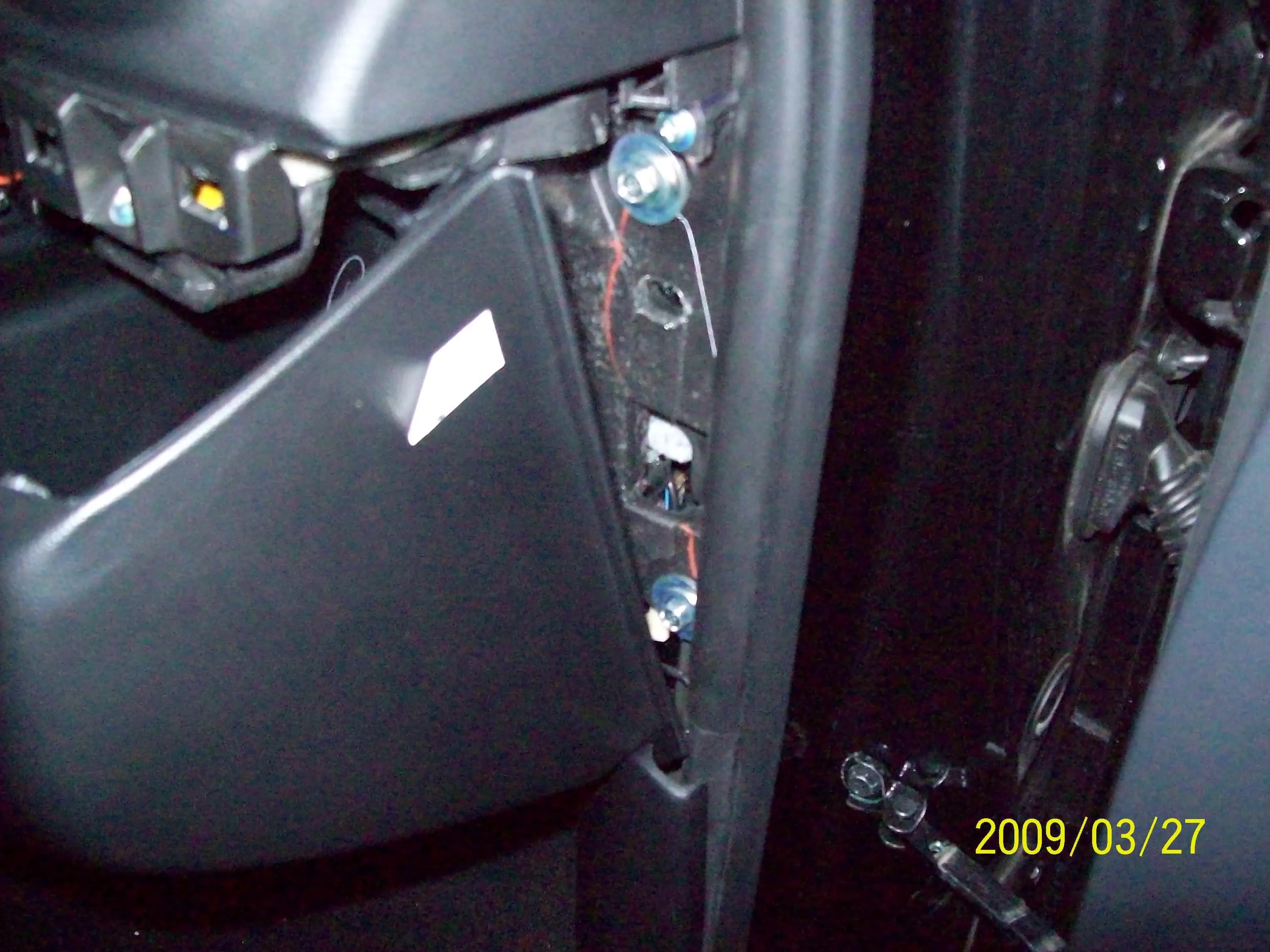

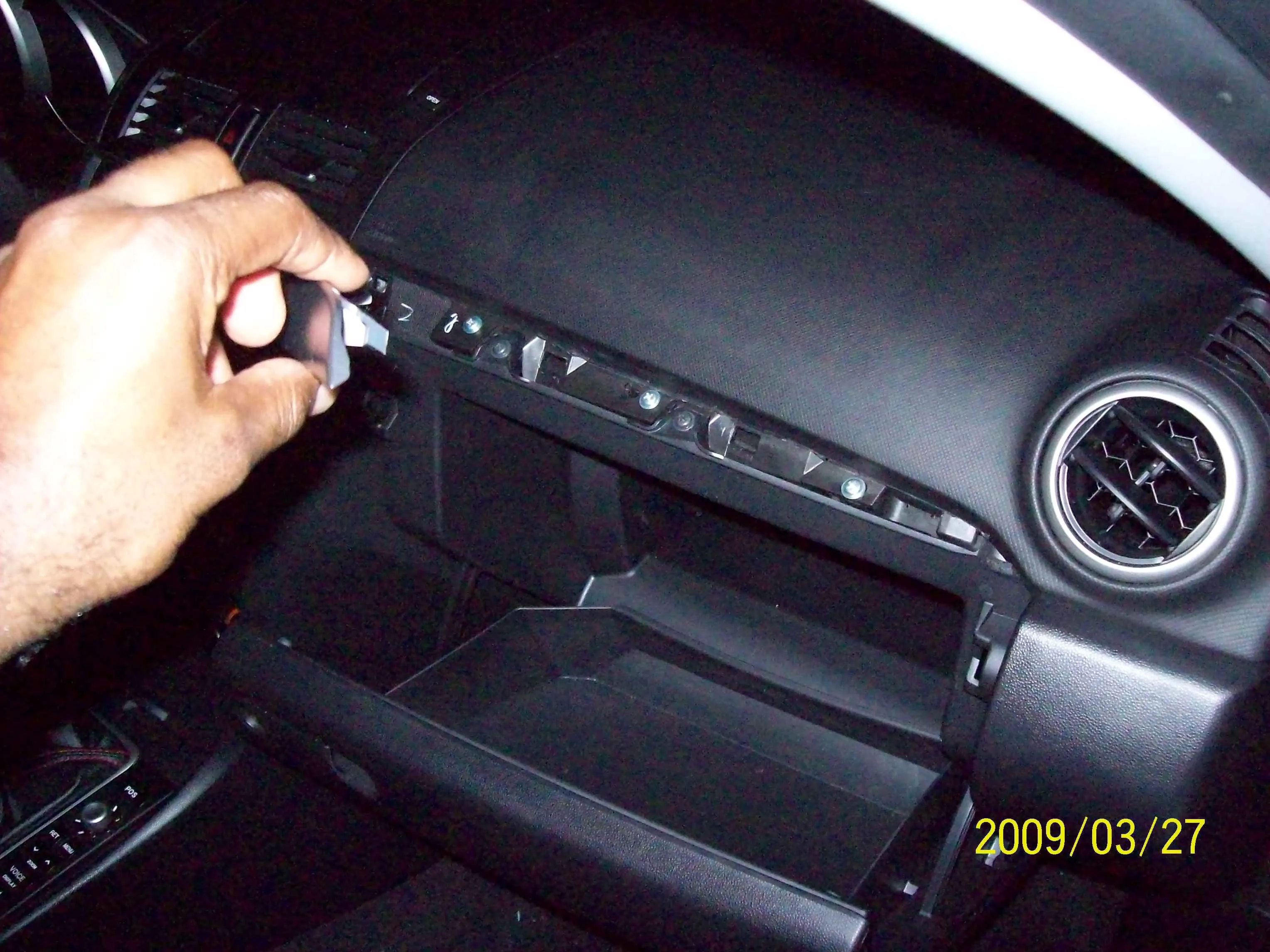

Ecniemann, I was hunting for those two screws to remove the glove box like a 4 year old in a square mile easter egg hunt :). I googled [uninstall MS3 Glovebox] and found out those two screws where hiding in the upper trim.
Everyone else... When routing power cable... Make sure you cut around the knob on the gorment and not just the knod if you are using 4 gage.... very tight with lube. My amp pwr cable was 17'... just enuff with non-2-spare after running across engine comparment to capacitor in MS3 trunk. I had to buy a $24 cap install kit to use those wires for amp pos term to capacitor.
AFTER MARKET AMPLIFIER TURN WIRE
The Bose amp.... motha to get to.... has two plugs. The biggest plug has a SOLID BLUE wire in its plug... that is the wire you need to connect your Amp turnon wire too. (easy to remember Blue wire to Blue wire). I scarped off the shielding on that blue wire like broken scales on a rotten fish....#*$#@ another motha install.

Easier install. You cannot see the wire color in picture, but BLUE/WHITE is POS and GREY/WHITE is neg. I unplugged the Bose wires, cut off plug, and splice my LOC wires to it. My LOC is a 4 channel LOC, and I only needed two channels, so as you can see, the other 2 LOC channels are not used in my installation. NOTE: On the other side of the BOSE blu/wht-gry/wht plug, the wire are red and green.
Other than that I lost 2 crews in engine compartment trying to install Fuse holder, broke (accidently stepped on) a siding cover secure pin, and kept pulling out subwoofer box and trunk cover mat due to forgetting to route another wire under the rear seats.

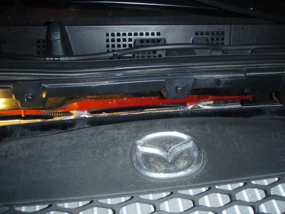

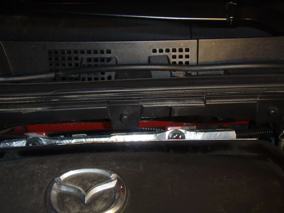

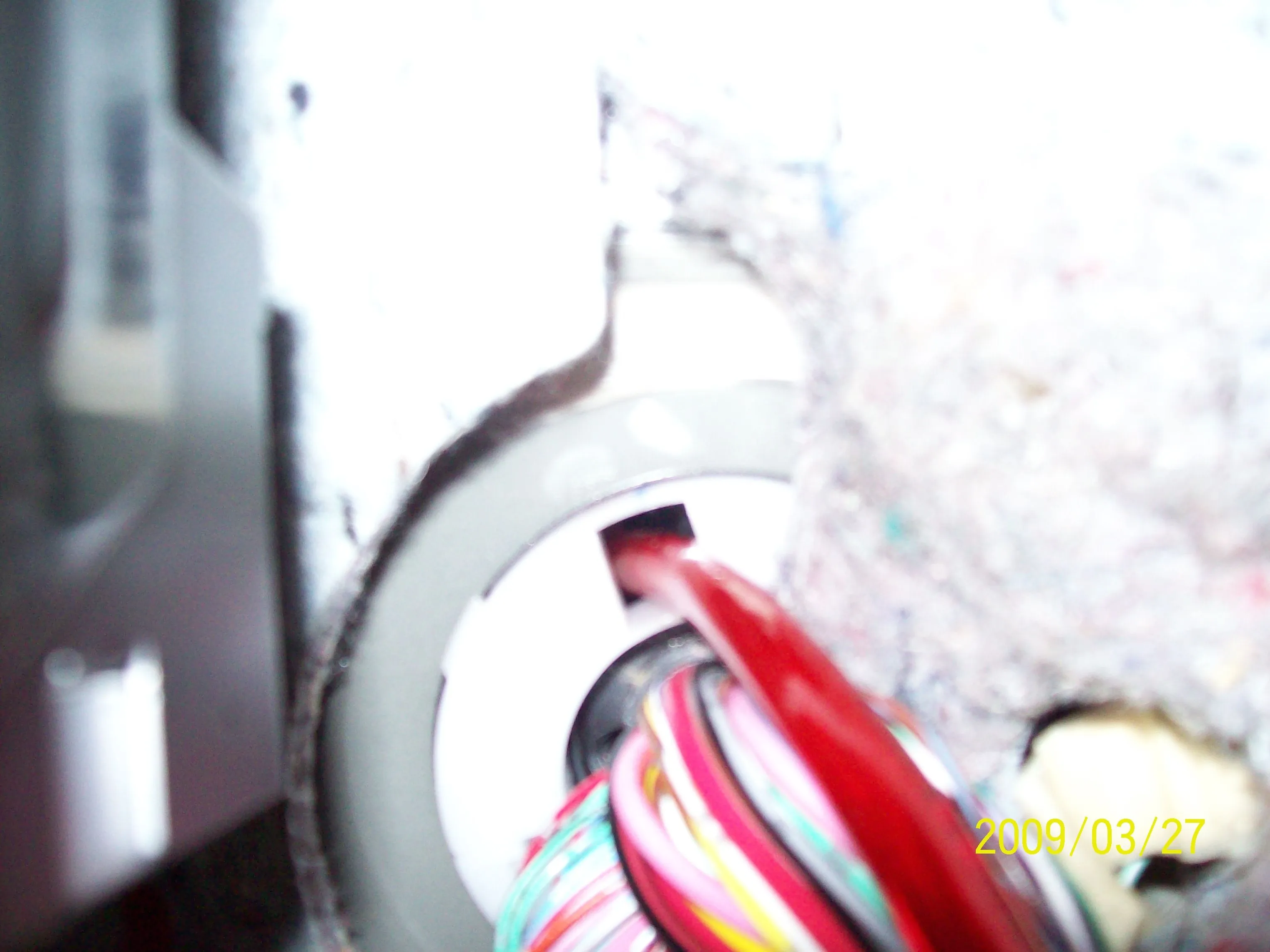

Alright peeps,
All the previous info on the Bose system wires are correct.
Ecniemann suggested power route is good/correct.
Everyone has their own system setup / modifications, So I hope this verified information with pictures will at least help you in your connections, if you decide to tap into your Bose system rather than change every thing out.

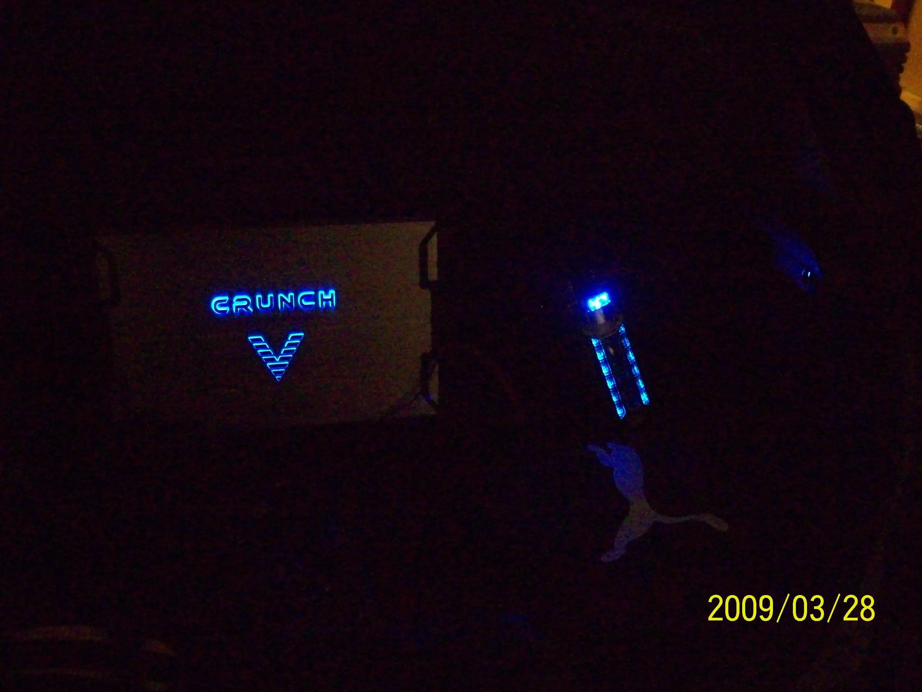

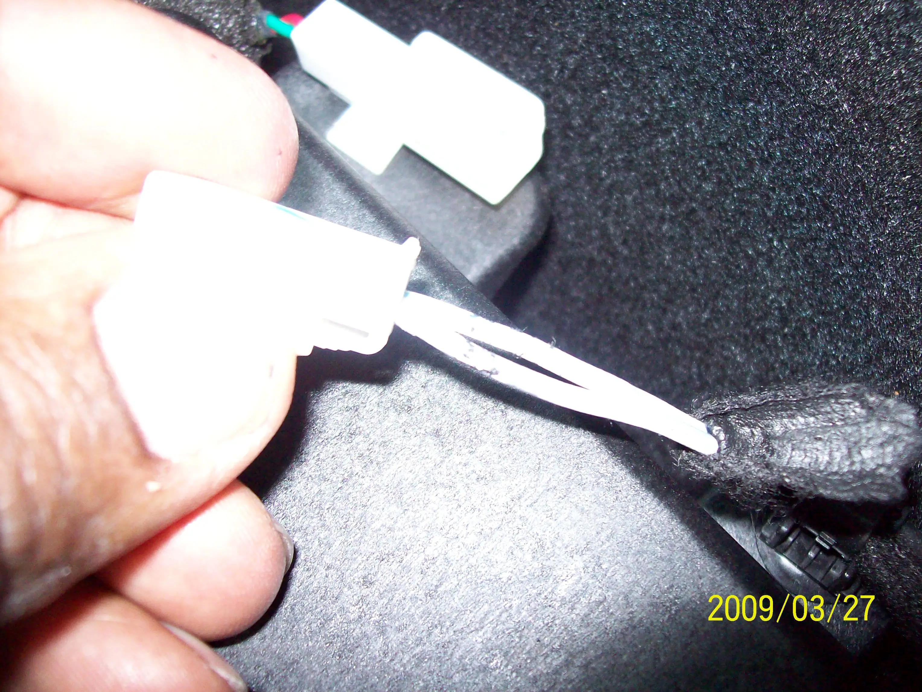

BOSE SUBWOOFER
Easier install. You cannot see the wire color in picture, but BLUE/WHITE is POS and GREY/WHITE is neg. I unplugged the Bose wires, cut off plug, and splice my LOC wires to it. My LOC is a 4 channel LOC, and I only needed two channels, so as you can see, the other 2 LOC channels are not used in my installation. NOTE: On the other side of the BOSE blu/wht-gry/wht plug, the wire are red and black.

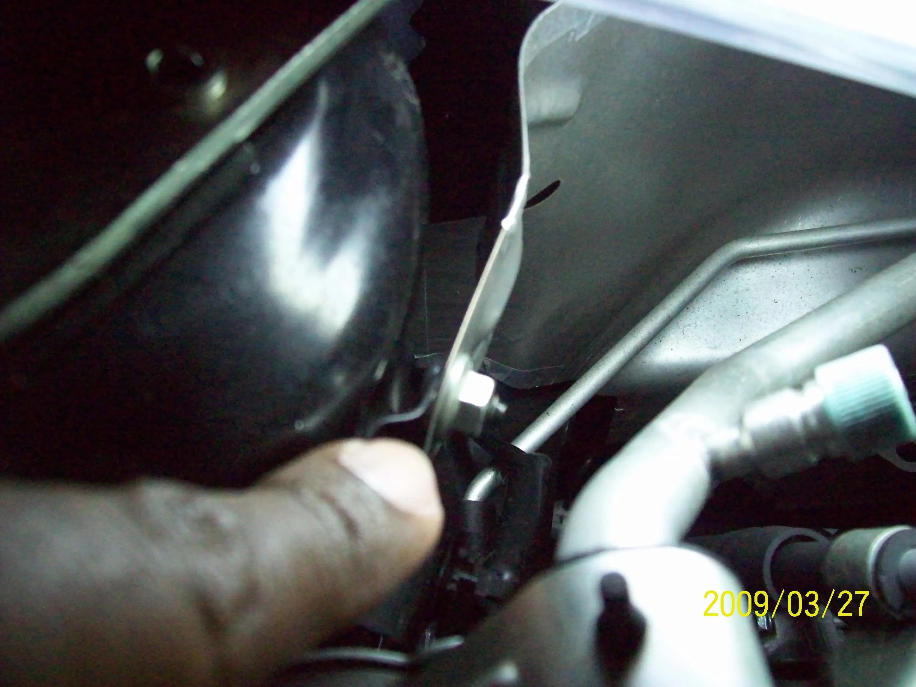

Other than that I lost 2 crews in engine compartment trying to install Fuse holder, broken (accidently stepped on) a siding cover, and kept pulling out subwoofer box and trunk cover mat due to forgetting to route a wire under the rear seats.

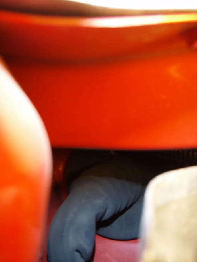

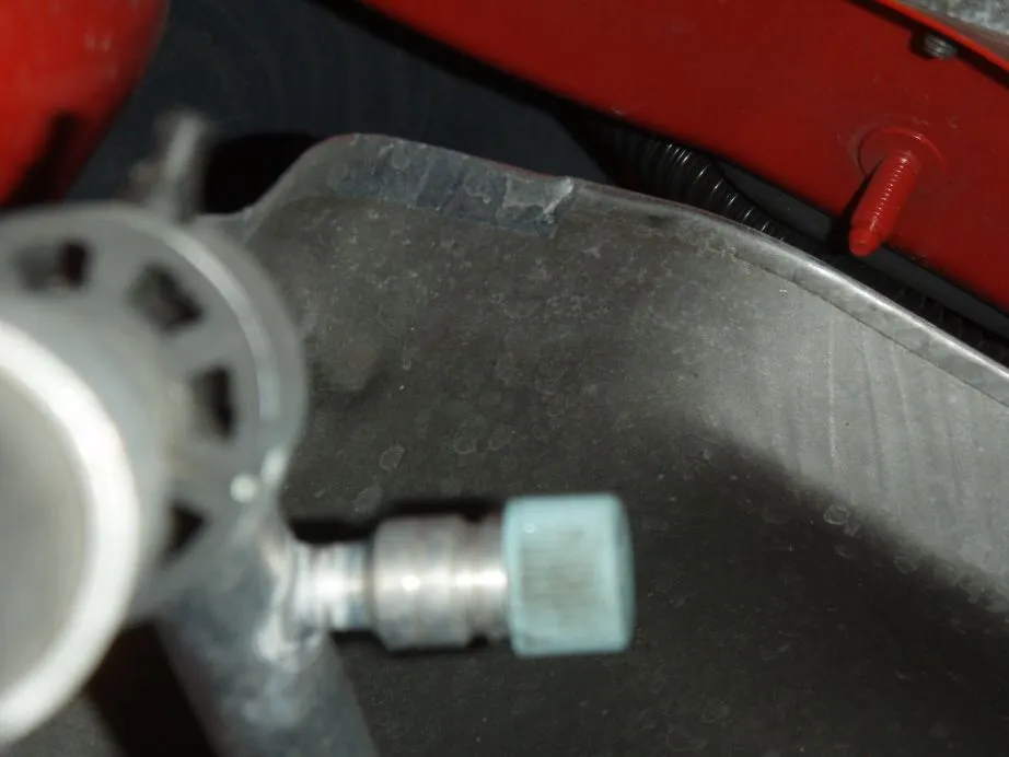

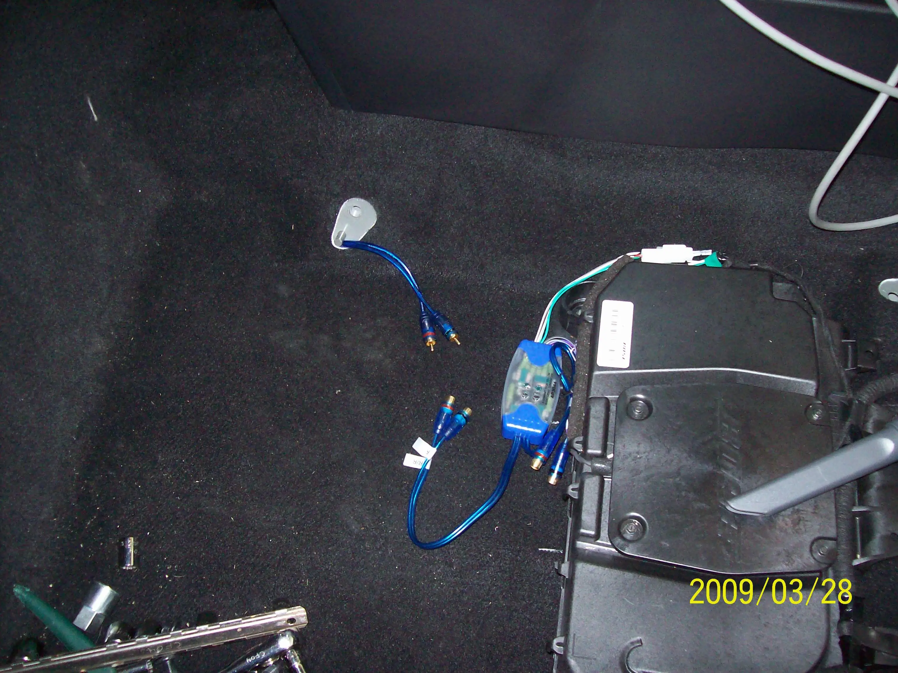

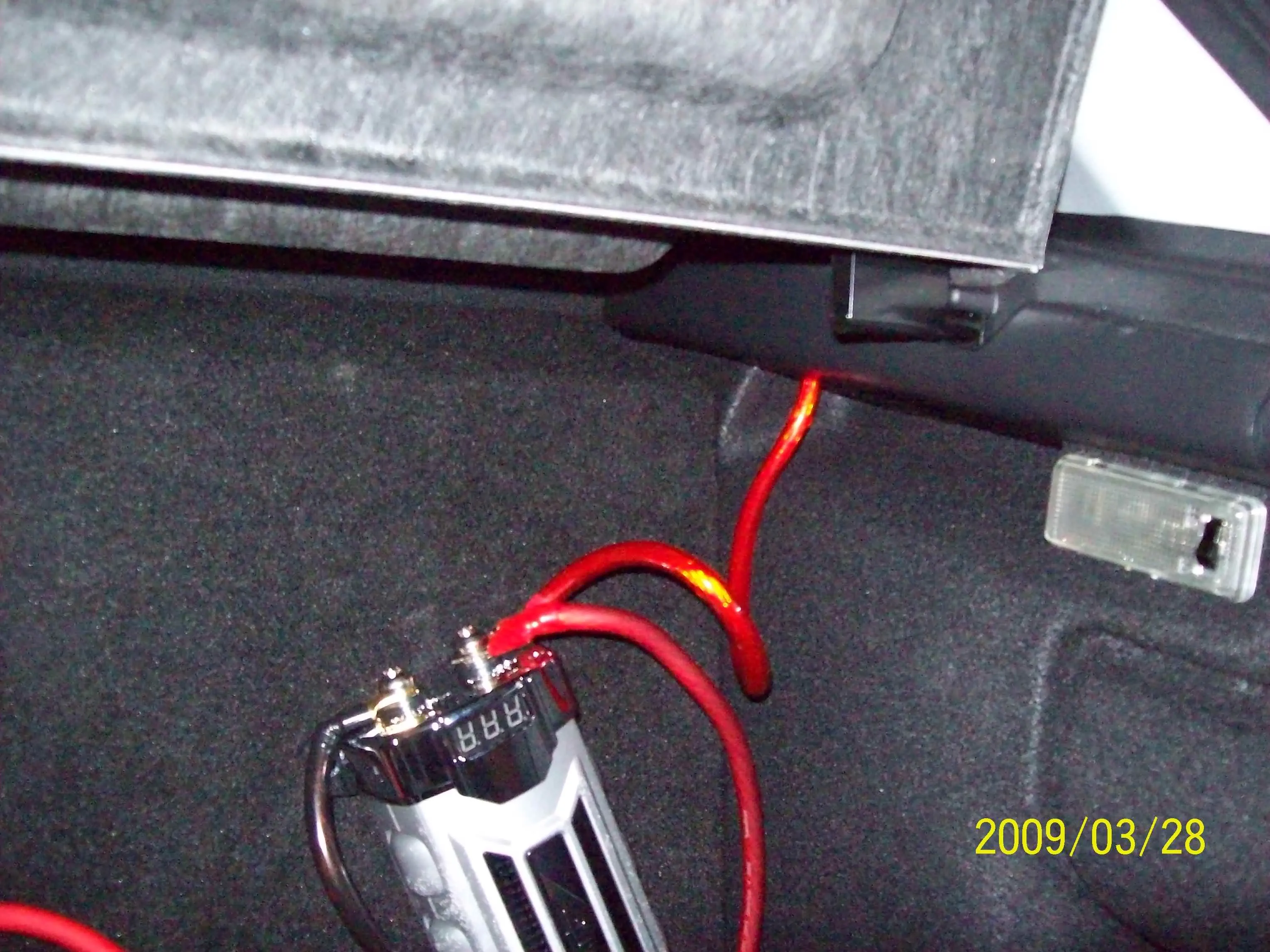

End of Amp power cable.
LOC.
System Turn on in the dark

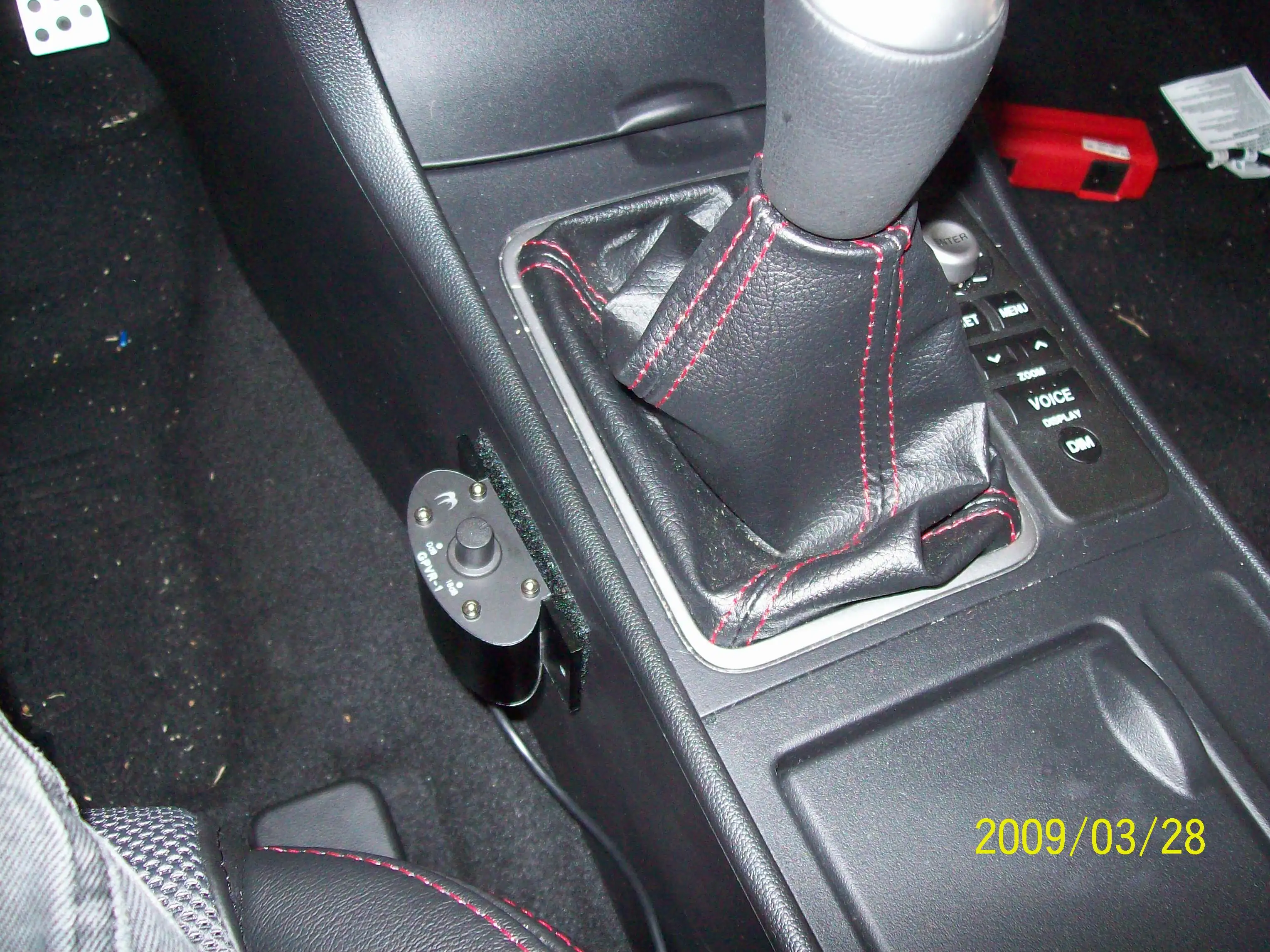

I started late Friday which was a rainy/dark day. Purchasing a Auto shop $15 high power light GREATLY helped me with the install.
While routing the Aftermarket Turn-on wire, I routed the Amp's remote control wire and mounted left of the Stick Shift..... can you say velcro.
Very nice picture documentation! That is exactly where I went through that grommet. You can see what I meant by that "square" on the cabin side pic, now, right? I believe you had less power wire, because I went under the rear seat into the spare tire area, rather than into the molding in the trunk. That would account for at least 2 ft. or so.
I had to LOL at that comment about losing screws in engine bay and stepping on stuff! Same s*** here, except I lost a screw while installing my SRI. It didn't even drop through. I had to use the magnetic reach tool. Usually I step on something laying around too.
This will be a good reference for everyone else now. Thank God I didn't have to deal with the Bose issues! I forgot about the glove box screws too, because I did everything at once, and when I swapped HU's, that trim piece was already off. Sorry about that.
