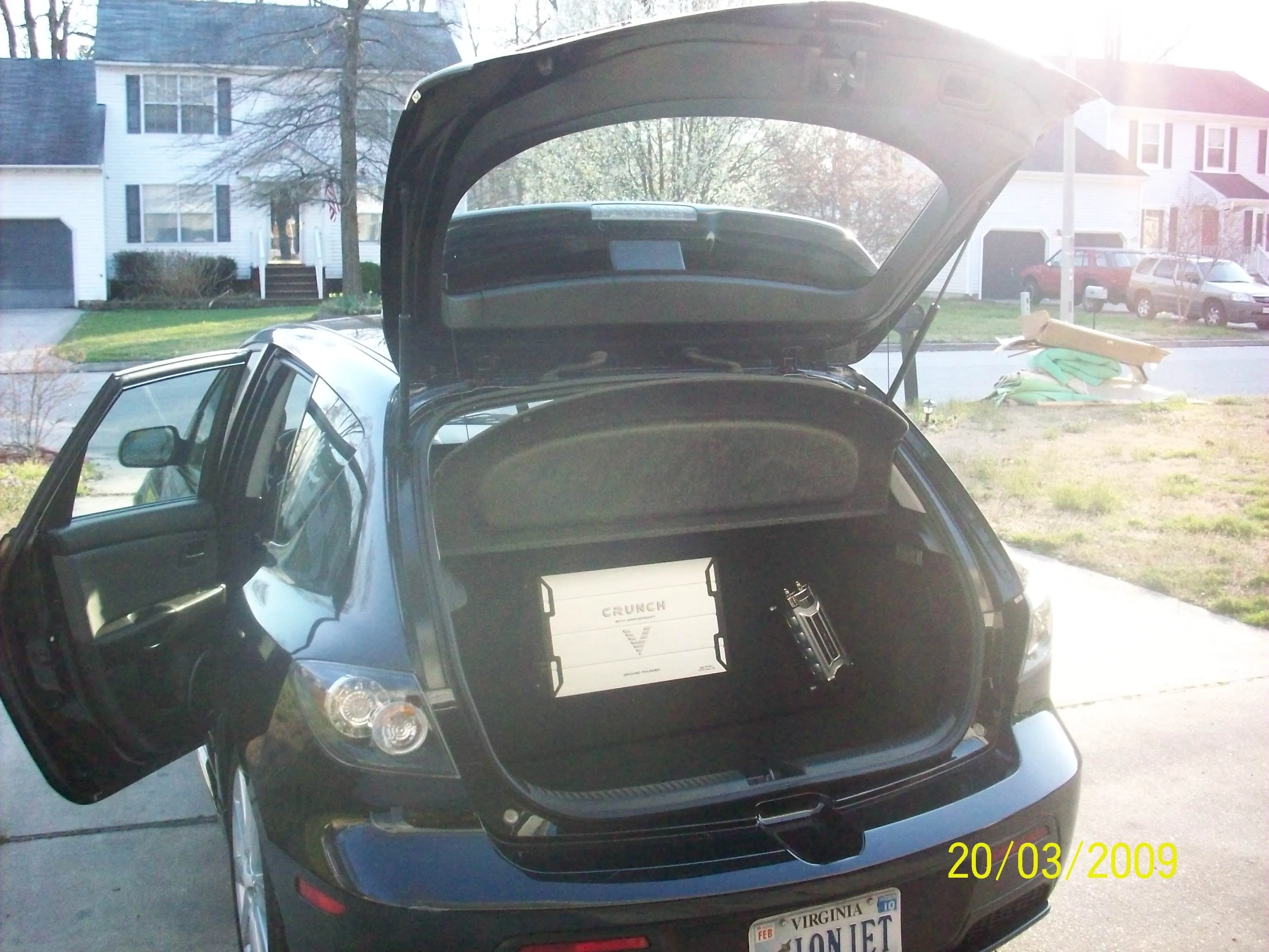

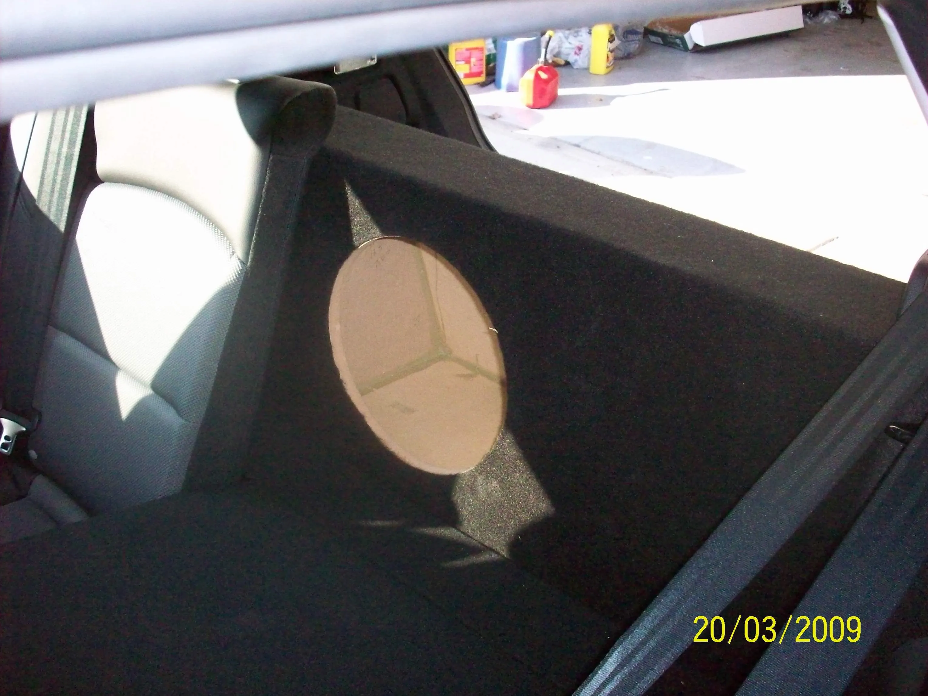

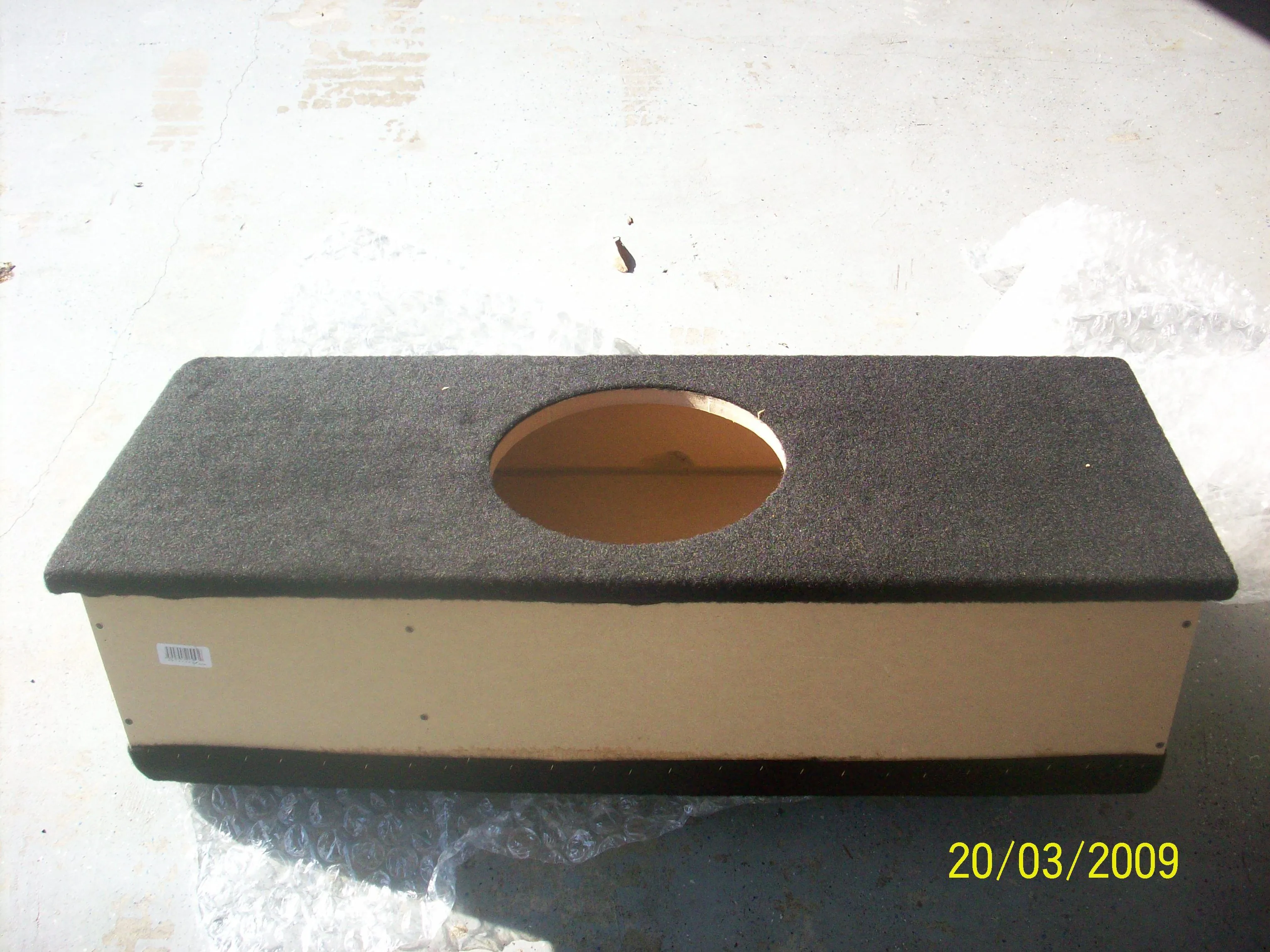

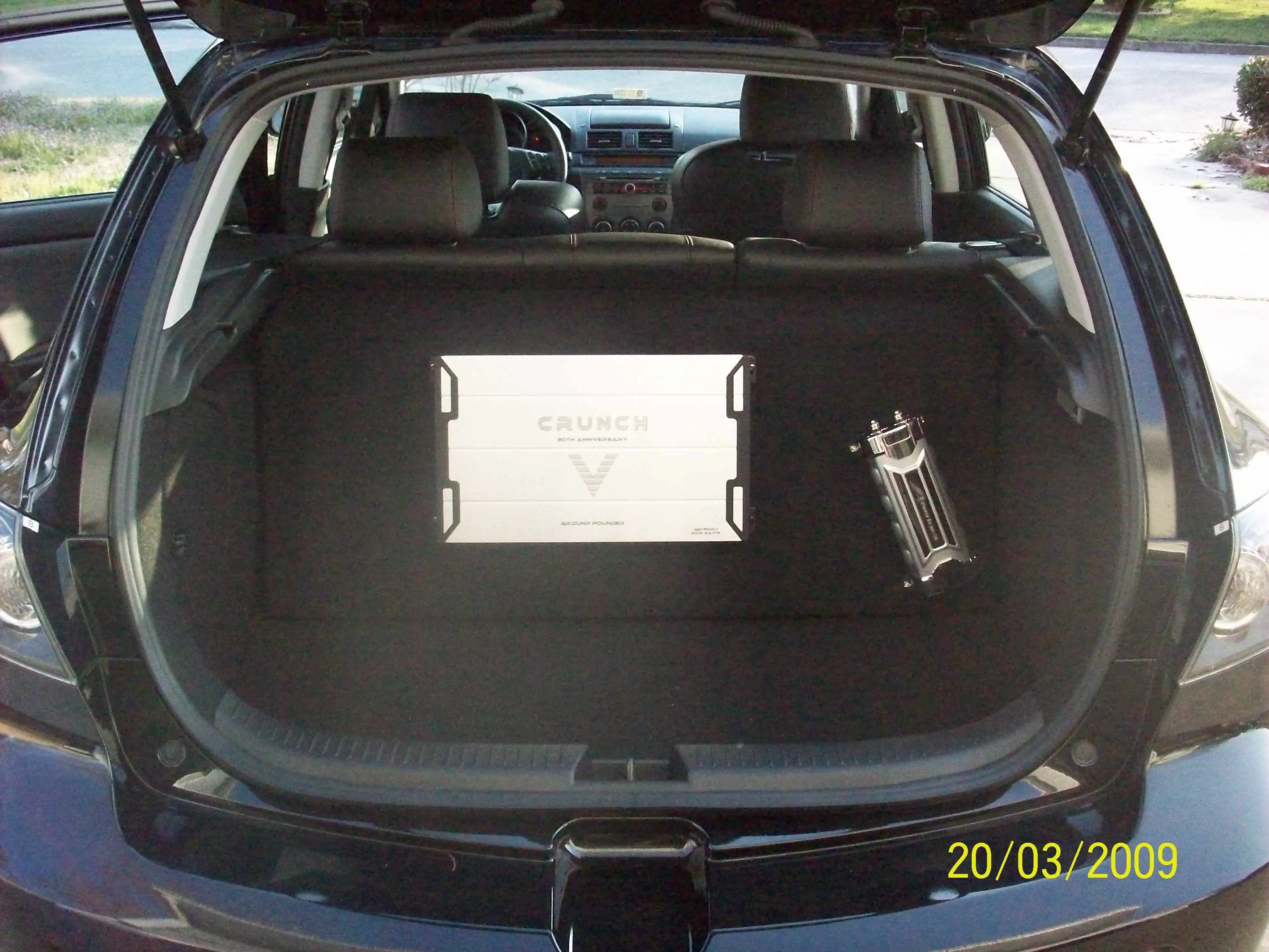

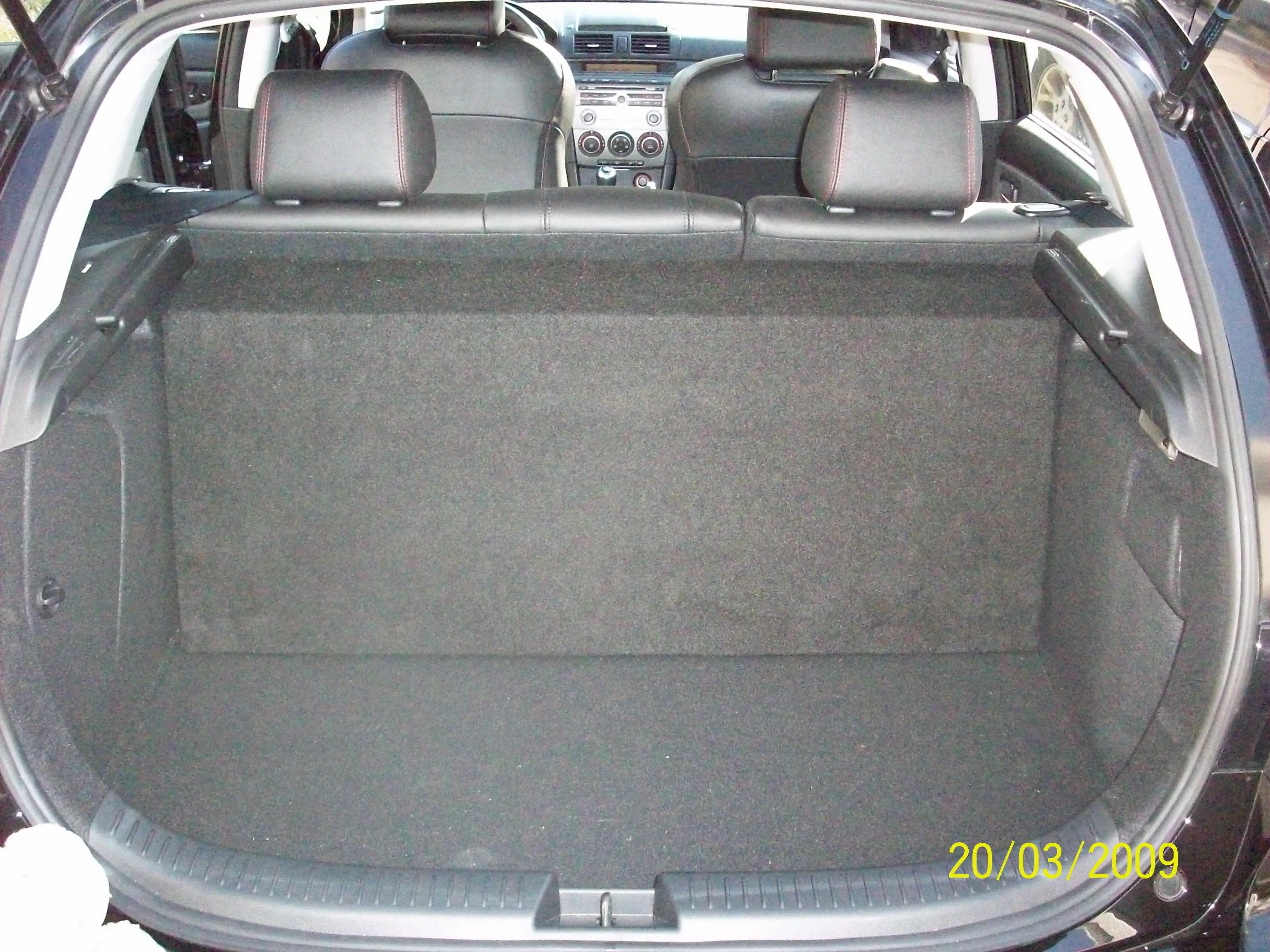

*Subwoofer box custom made: ZEnclosures
*Amp Crunch 2000 watt MONO
*3 Farad cap
Doing easy stuff 1st
*Edit: 24MAR09* Note: Anything added to trunk (my subwoofer box) will keep you from accessing your spare tire! Ecniemann's system config (Bazooka in trunk) seems to be the best IF you want to get to your spare tire without much hassle. I would have to drop my backseats down and pull sub-box forward / onto folded rear seats to allow myself spare tire access.
