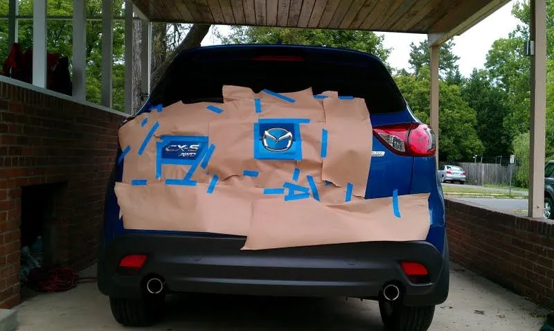

First you'll have to tape off a generous portion of the vehicle while leaving rectangles of exposed paint plus chrome where you want to plasti-dip.

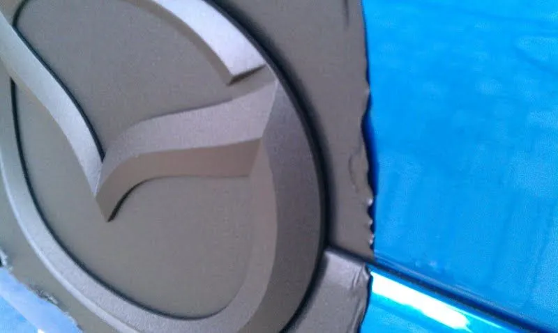

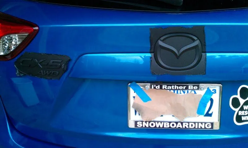

Next, spray the BLACK PLASTI-DIP one the exposed area just like a spray can. I've heard of doing anywhere from 3-5 layers. The more layers, the easier it is to peel off more precisely. I used 5 coats. Waited about 20-30 minutes between coats. The first should be really thin. The last couple coats can be thicker. Hold can about 8-12 inches from the area to be sprayed.
Now you're ready to peel it off. Simply grab a corner and slowly pull it off. I kept a pocket knife handy in case it began to peel in places where I wanted it to stay. I also used a toothpick to get at the areas in the middle of the lettering. It was very simple, just make sure to let it dry long enough.

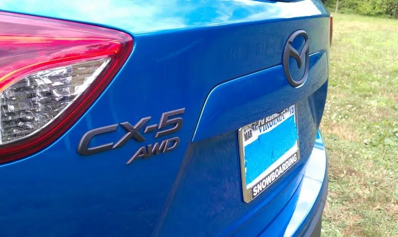

I thought it came out pretty good! I also saw that it looks awesome on white and silver vehicles.
