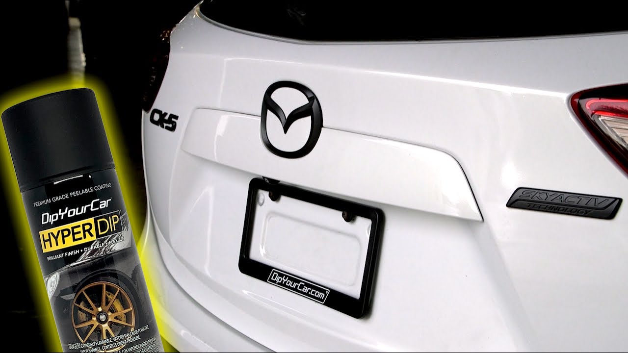

You didn't say what color your car is but you could paint them to a color that matches so they will be less noticeable, great for white and also very dark colors. Just a suggestion. I have machine grey body color and painted all the emblems black... about all I could do. Good Luck.

The other option mentioned was to hyperdip or plastidip then if your car is dark colour. May be even on the white it would look ok.
great info - Thnx ! the head scratcher on this one is I already paid $600 xtra 4 the Rohid White
... so I either go full on body shop OE color or nada- Im concerned years down the line those holes bubble out with bondo ? not going to try my hand at body work -- wife would poison my coffee if I f'd it up ..appreciate the options , great forum !
Some examples of black emblems on a white CX-5 and a white Highlander. Not a perfect representation, but you get the idea. Keep in mind that if you black out the rear emblems, you should also consider doing the front emblem (if possible).
