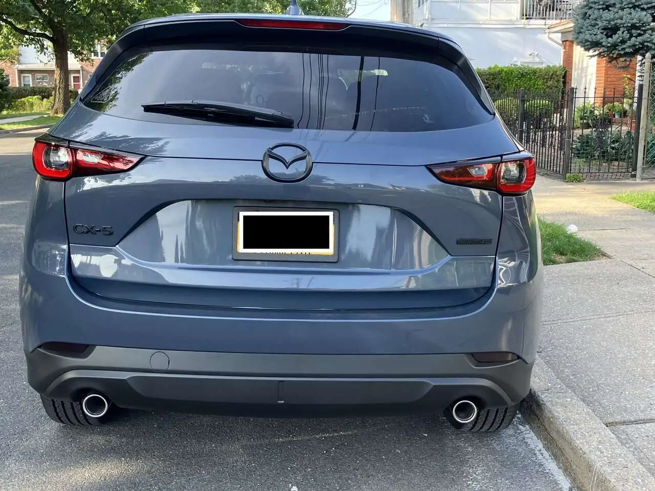

This is what i'm waiting on now. I ordered the emblems myself. When they come in I'll paint them myself and then ask a body shop to just put them on for me. Curious but I was gonna use plastidip anyway. Figured it would be a better job with the badges removed but what paint did you use to do them? Or did the body shop paint them as well?

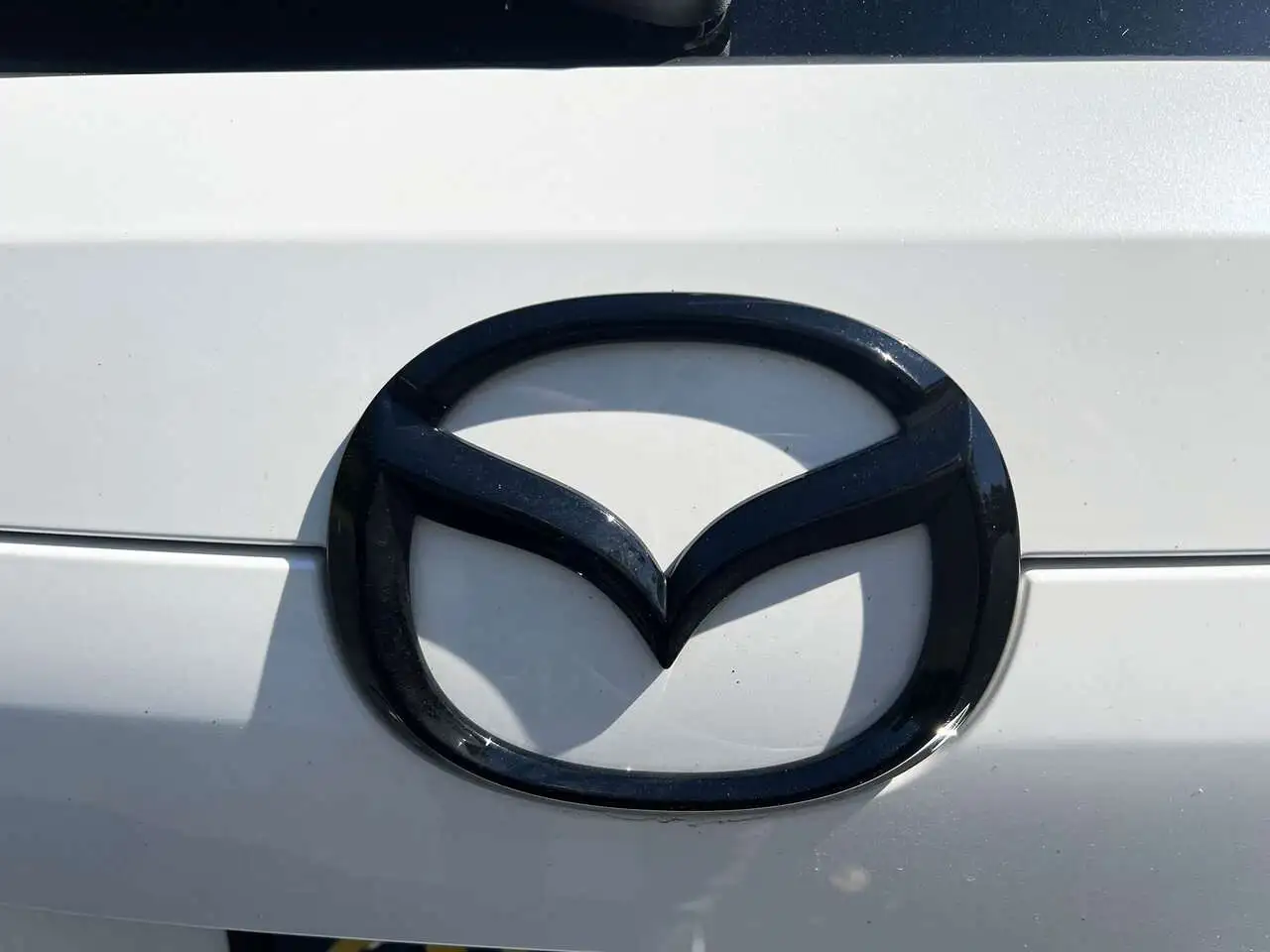

I tried the hyper dip first. I did all the emblems and the hockey sticks on the side. They came out fine. It would take some serious rubbing to get them to peel so no worries on washing and running a chamois over them. The only thing I didn't like was the flat back color they were.

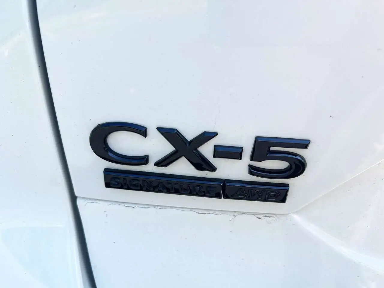

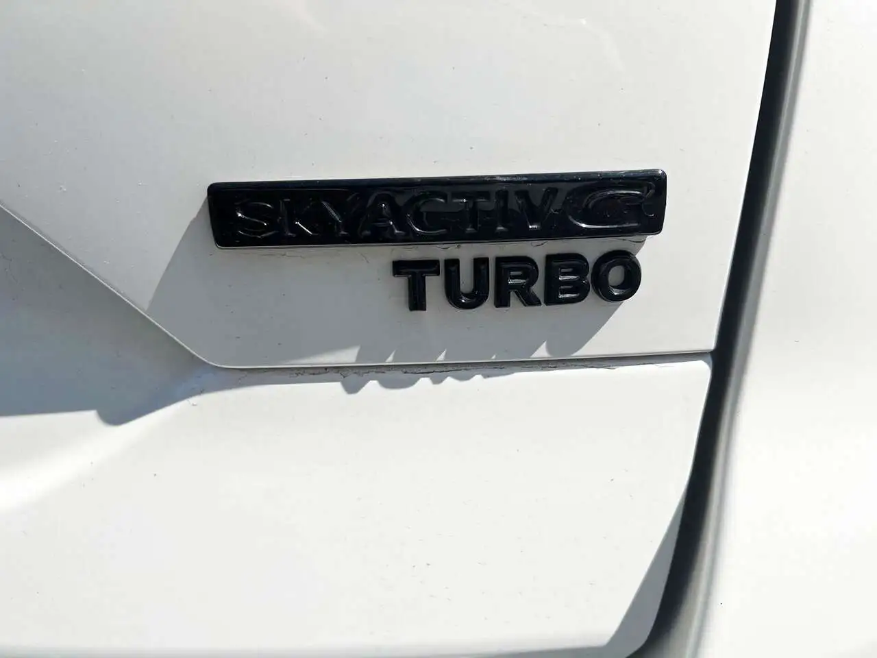

Then I decided to purchase a new set of badges, and door trim (the bent trim part comes as an assembly with the window) and painted them all with SEM Trim Black, prep and satin clear coat. SEM is a deep, rich black that looks far better to me. I put several coats of paint and clear on each part. The paint levels out beautifully as it dries. I suck at painting anything and these came out really nice. I even did it outside when it was like 55 degrees and with a breeze too.
I used dental floss and a hair dryer to warm the area and pop off all the badges. The AWD badge has no pins and is the easiest to remove. I chose not to reinstall the AWD for a cleaner look.

wd40 removes all the glue/adhesive. it goes like butter :)
thats how I removed the leftover ahdesive/tape from my badges and the leftovers from the car.
And yea the awd and turbo badges have only adhesive tape.

Just wanted to report that the pins are in fact just guides and doing it this way was way easier then spraying them on the car. Yes it was more expensive but the benefit is if at some point I do need to touch up an edge, there already is a base coat of black. The CX-5 logo is the only one you need to be careful as far as making sure they are straight. Otherwise, easy peasy.
